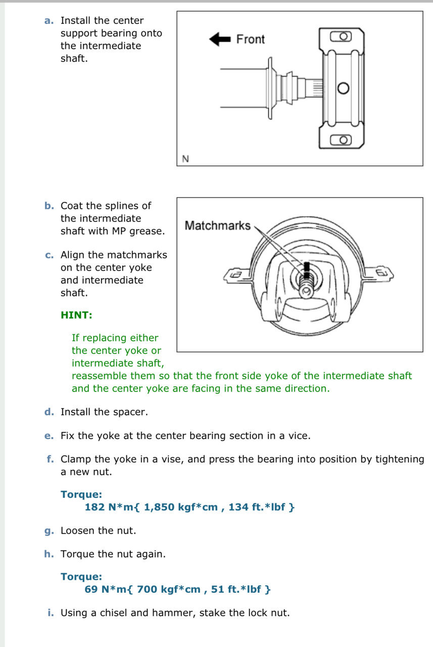

    But I have to ask, what did you torque the nut to on the carrier bearing?
    You torque it to 134 ft/lbs to seat the bearing, then back it off and torque it agin to 51 ft/lbs.

    Shoot! really? :facepalm:
    I torqued it to 134 and left it that way.. This could very well be my problem.

    Yeah. It’s on there really tight then.
    Here is the procedure
