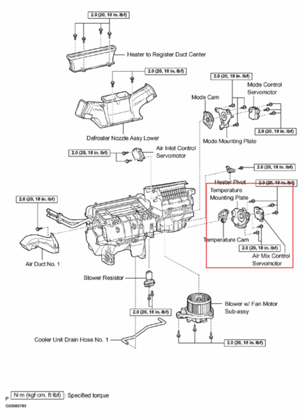

    Sounds like your heater core may be plugged. You may need to unhook the heater hoses and flush out the core with water. If that doesn't work the only other thing I can think to try is seeing if the temperature door actuator inside the truck is operating normally when you turn the knob on the controller.

    Where is the temperature door actuator located? I am not seeing anything about it in my Haynes repair manual.

    I got this from Mitchell On Demand.
