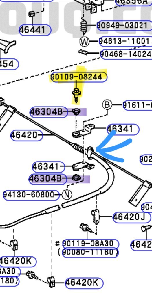

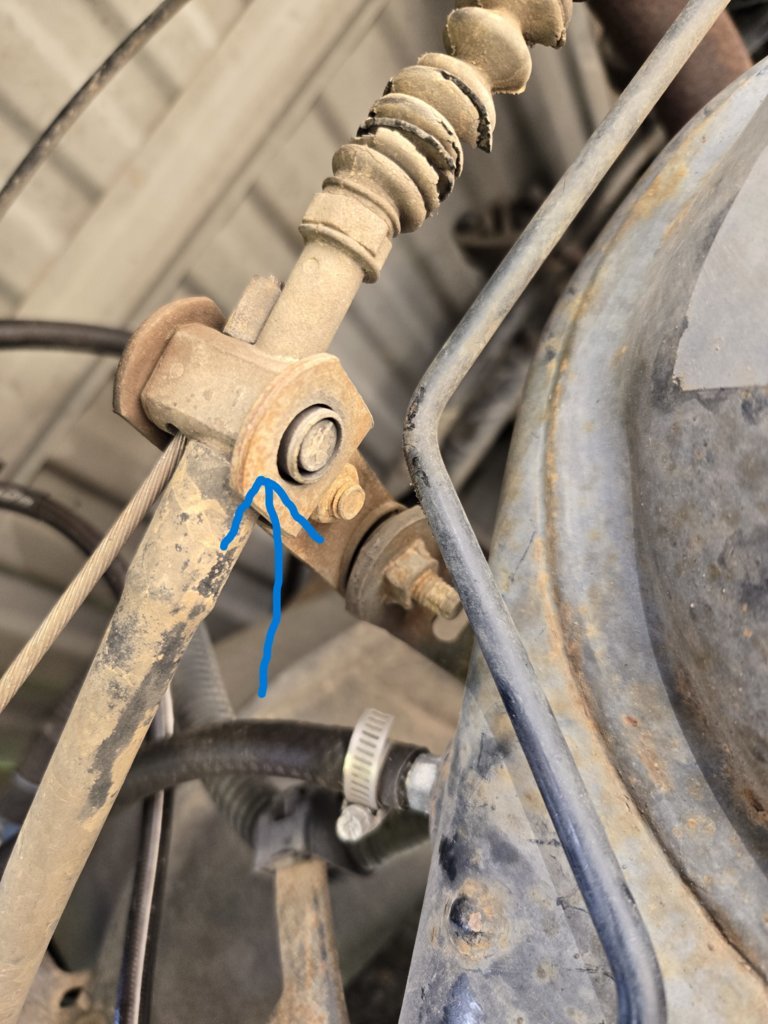

    Are you referring to the pivot point for the cables (in blue) or the bushing and bolt that pivot the entire thing? (in yellow and purple) if its the blue, is that a replace the whole cable or does Toyota make a replacement brass bushing for it? Thanks for the help!!

    yes, under the boot. Your truck doesn't look very rusty so I doubt that's the problem after seeing the photo, but it's simple enough to check it.

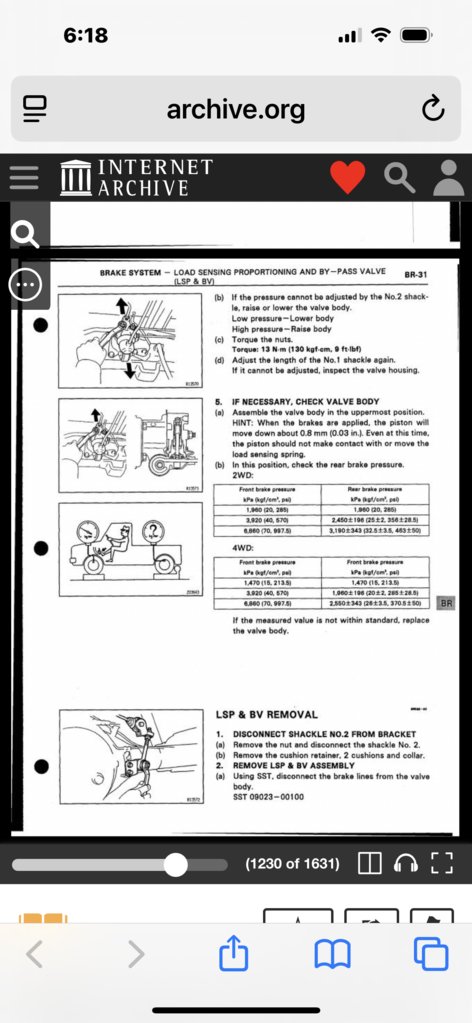

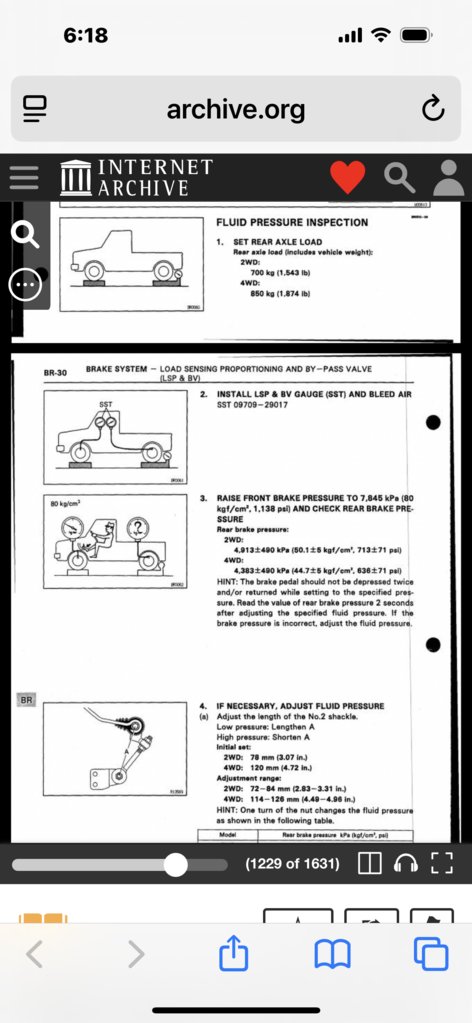

    Does Bivovac have a different thread on testing the LSPV? Very curious on how you do that. Also never thought about deleting it, what are the pro's and con's?

    Looks like need to go to truck stop to use scales to test
