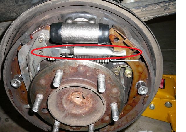

    Tensioner knob, the metal piece thats touching it should be touching the knurled piece. spring below the red highlighted area should be tight. If the knurl is worn or the metal piece is not touching it will keep adjusting till it locks your tire.

    So when I try and move the thing the brake cable attaches to nothing moves inside the drum, on the drivers side you can hear stuff moving.
    Something much be seized or messed up. Probably just have to look at it at home.

    when you get to where you can work on her, replace the springs at a minimum. I battled this for a few months... EVERYTHING looks ok and functions but the P/S rear kept over-adjusting. The springs get weak over the years and when you pull the parking brake it actuates the adjuster... sometimes it is one click, sometimes it is two and over a period of time it will self adjust to the point of locking up, then the drum is a very difficult to get off. It takes a bit of fiddling with 2 screwdrivers, one to depress the adjusting lever and the other to back off the adjuster. It can be done but you are so pissed off at having to do this for the 50th time that you just want to shoot the damn truck and be done with it. I think it was $120 ish for all new hardware from Toyota for both sides.

    the cog is probably rusted up, it should turn freely. It has ears on either side so doubtful you would be able to knock it off. You'd have to take the drum off, take it out of position and get it moving freely. If the teeth arent worn down all the way.
