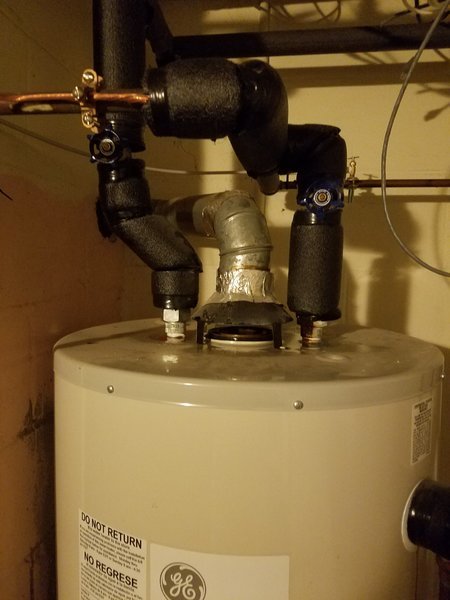

    Heard a hissing as I was grabbing laundry. Looked at hit water heater and saw water on floor. Checked pilot, it's out.
    Cold water is misting out of the top, hitting the flute, puddle on heater and running down. Even the pilot window has a steady stream of water running down it.

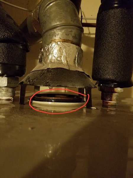

    On the pic I attached I circled where water is "misting" up from. I can't get it re-lit and I'm guessing cuz of leaking mist/water saturation?
    Is this fixable or just a need to replace scenario?

    Just realized when I close the water in line on right, misting/hissing noise stops. No idea how these work, but I suspect where the water comes in has corroded to point of leaking? I assume leaking water extinguished pilot, etc?

    Call a plumber:thumbsup:. Your tank sprung a leak and isn't repairable. The hot water heater needs to be replaced. Good luck

    Tank is junk.You will need a new water heater. In my area we only get about 6 years out of them before they start to leak.

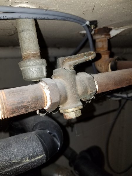

    So it's cover under warranty yet. But I have to disconnect and drain then take to Home Depot. Problem I see is there is no easy shutoff/T-handle like our dryer has.
    Just this old lever up top. This must be the shur off for the gas but it seems stuck in place. I must have to turn this, am I not?

    Those can be stubborn. Gently try putting a cresent wrench on the handle and see if it will budge.

    P.B.Blaster or WD-40 might help unstick the valve..in limited quantities...
