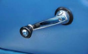

    My 1992 Toyota Pickup had this... looked kinda liked this...
    You supplied the power so it was always available...
