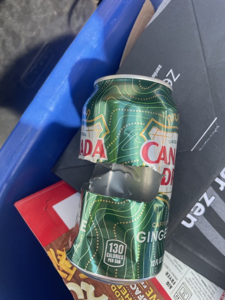

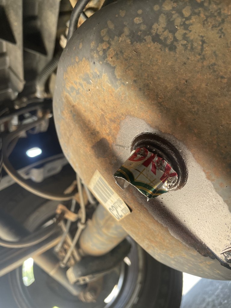

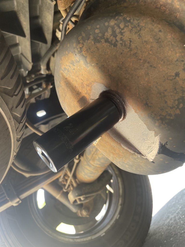

    Here’s what I had to do to get my rear diff drain plug out because it was rounded off:

    well, yes… for me it was the fill plug that I discovered was rounded. But the solution is transferable to the other plug. Adding a little extra material was a difference maker.

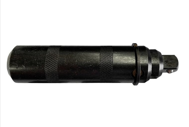

    I have used one of these many times over the years. It worked great on Phillip-headed motorcycle screws. Mine is about 50 years old.

    those are great tools. hand impacts. i used by boss snap on one

    The impact driver above is the tool for those Honda rotor phillips screws :thumbsup:
