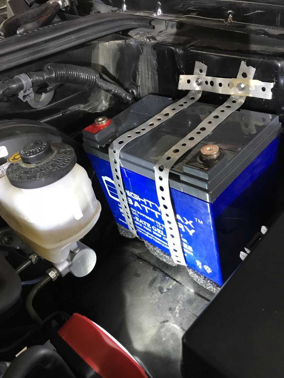

    Battery:Mighty Max Batteries ML35-12GEL 12 volt 35 Ah

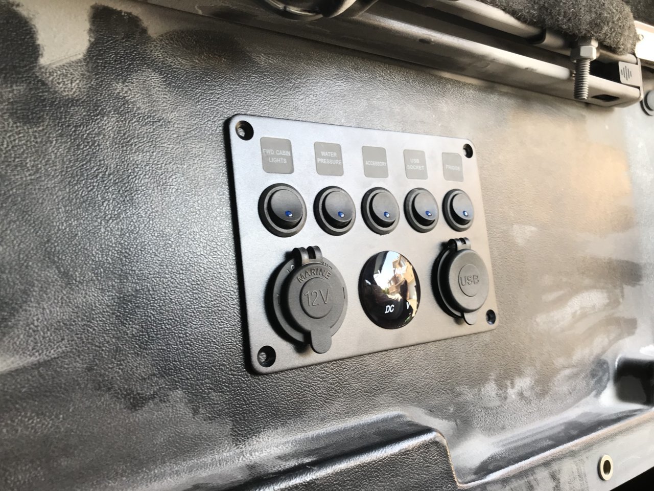

    Switch & Outlet Panel: Cllena Dual USB Socket Charger 2.1A&2.1A + LED Voltmeter + 12V Power Outlet + 5 Gang ON-OFF Toggle Switch

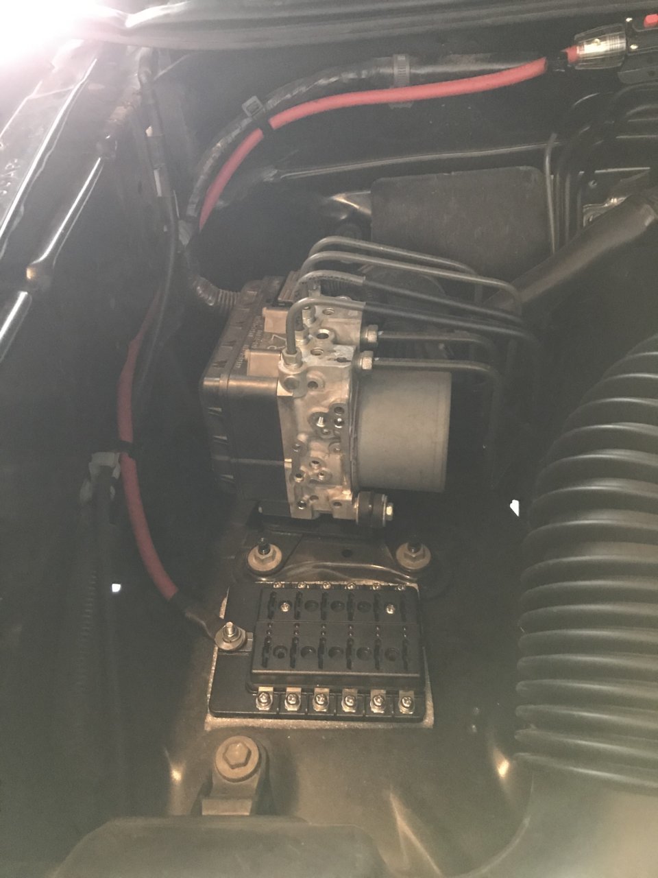

    Blade Fuse Block Box Holder 12 Way With LED Indicator for Blown Fuse.

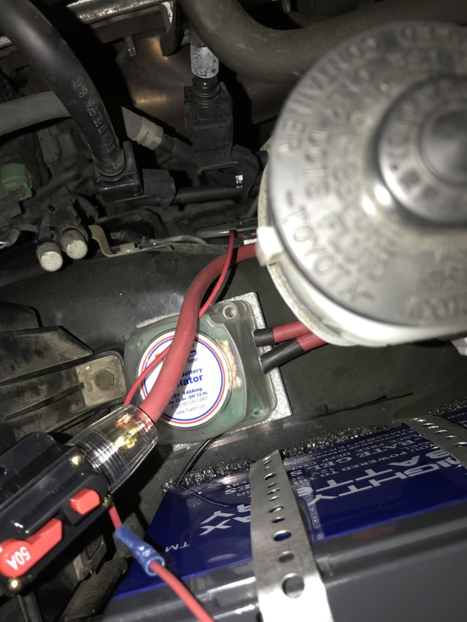

    Inline 50 amp fuse from starter battery to isolator to house battery to 40 amp fuse to fuse block.

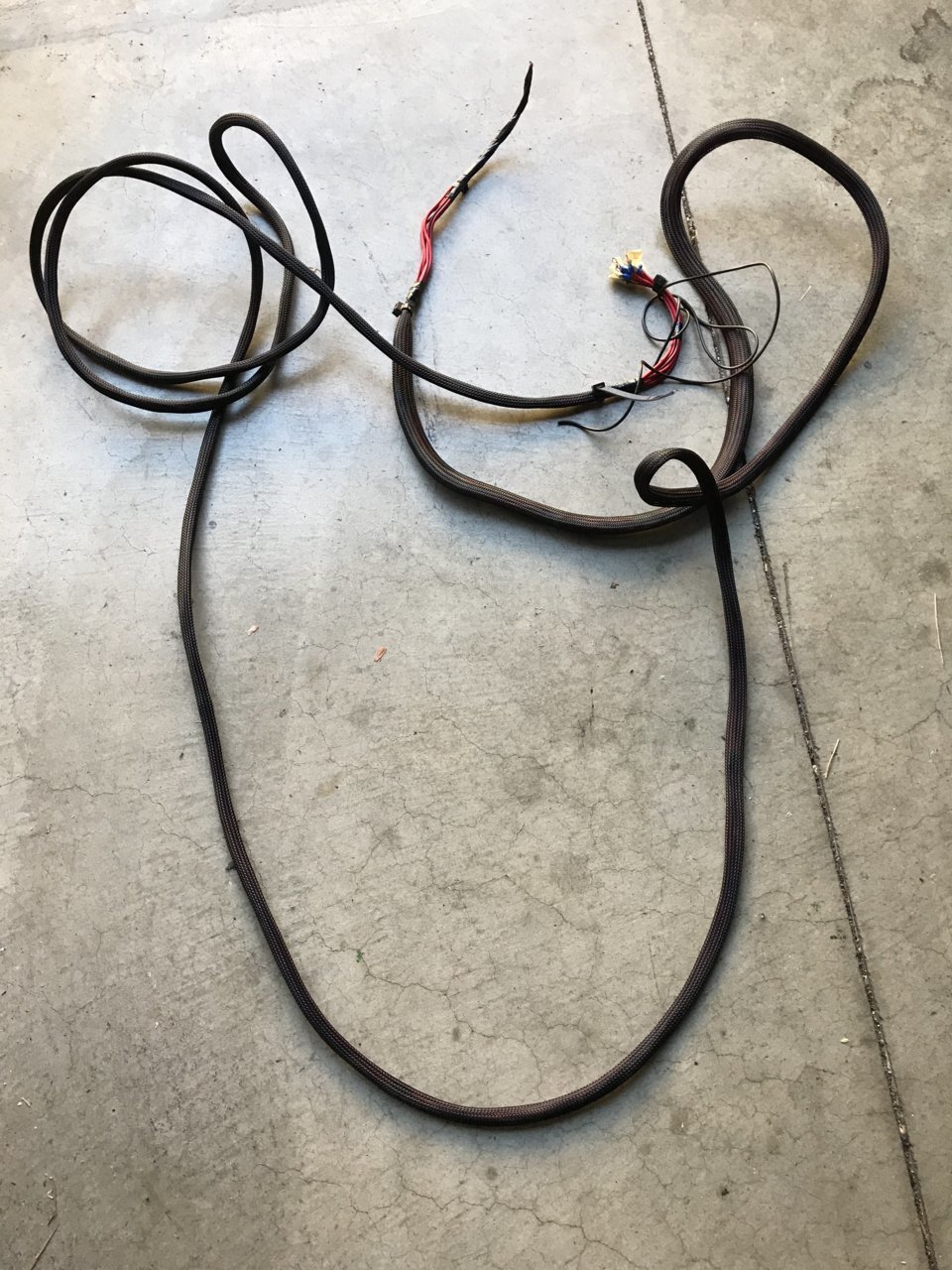

    For easier troubleshooting I decided to run individual power lines to each accessory to the Switch & Outlet Panel (don’t ask why, my preference).
    Made a wire harness from the fuse block to the Switch & Outlet Panel... IN THE BED. Run the wire harness under the truck along the bed frame.

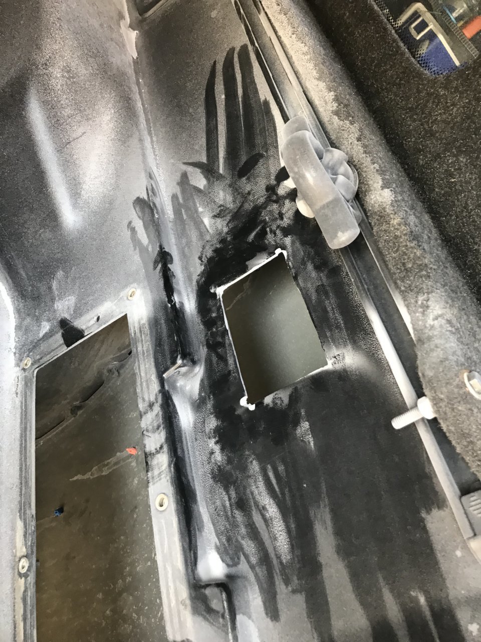

    Removed bed cubbyhole on passenger side; just above it I cut a hole on the bed to install the Switch & Outlet Panel.

    I need to do some clean up today, cutting a hole in the composite bed was messy.
