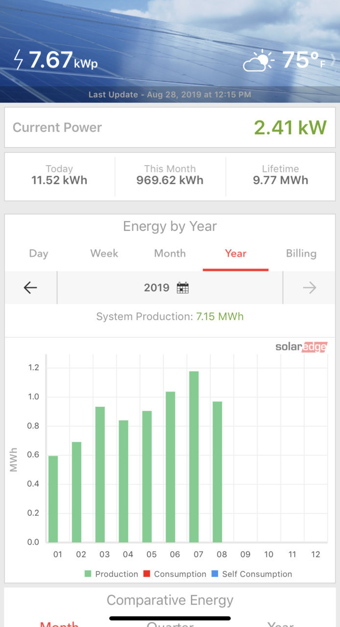

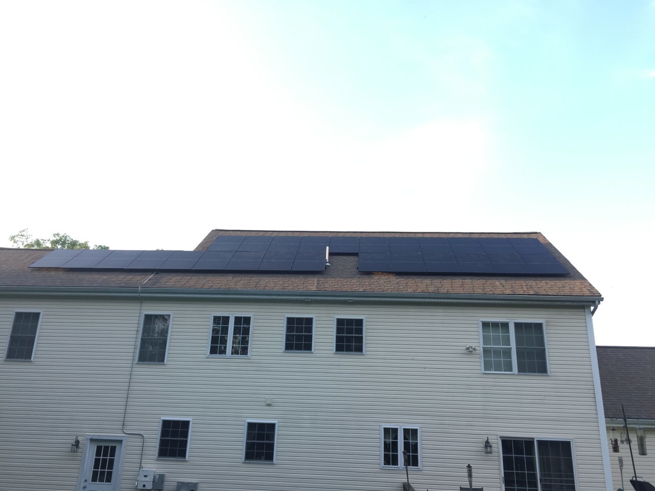

    I had solar installed a year ago so I have gone through the full cycle. The incentive was put out by the state to have more houses on solar. I do have net metering which is in my favor once it is all paid off. My monthly bill for a 2800sq ft colonial was averaged at $150 over the course of a year. 2 AC units and forced hot air heating with oil for some background. My highest electric bill has been $42 which was this past July with the AC running at no cooler than 76 (im cheap and its only me and my kids).
    Average bill has been $10-15 for the other months.
    Now I do have a 15y loan on the panels I can pay off at any point with no penalty and also got the government rebate on my taxes last year which reduced the overall loan monthly payment.
    My roof faces south so it gets sun all day and no tree issues in the winter when the sun is lower. The solar company gets a cut of what I generate but I also receive a monthly amount of money for the power I do generate so there have been months this summer I made a few nickles.
    What I learned from the installer is the amount of panels is spec'd to the average electric usage the previous year as you are not allowed to make more than you can use on average. He did say for anyone looking at solar, to jack your electric use the year prior, pay the high bills but then you system will be more than you actually need and it works in the owners favor.
    I have had no issues with the system except for some communication between the monitoring box and their app to see solar production. The winter with a snowfall is a bit wild when it breaks free and it sounds like a train on the roof.
    SR-71A, shakerhood and Bullnettles like this.

    this summer i made a little with the sunny days, mostly June, July and August. I have also turned the AC to be warmer as no one is home most of the day and at night the kids like it warmer. With ceiling fans in each room its not an issue either.
    According to the quote and paperwork, it will take about 5 years to start "making" money when it turns in my favor. the sooner I pay off the loan the sooner the money goes into my pocket.

    I would do it again if the correct incentive was attached. I had quotes from 3 companies over 4 years when it came into RI and each one would reduce my cost per KW/h by about a cent (give or take) so it really didn't do anything for me.
    This latest round of requirements by the state and the solar company actually put money back into my pocket with net metering. I have 2 meters on the house now, one for what I draw from the grid and the other what I generate which goes back to the grid. I will never be off the grid but in time I will be having the power company "store my power" for use in the off season. or so I have been told.
    There was some unsolicited email I received saying I had to have insurance on the system so I contacted the installers and they said it was bogus. Just watch out for anything that seems off.
