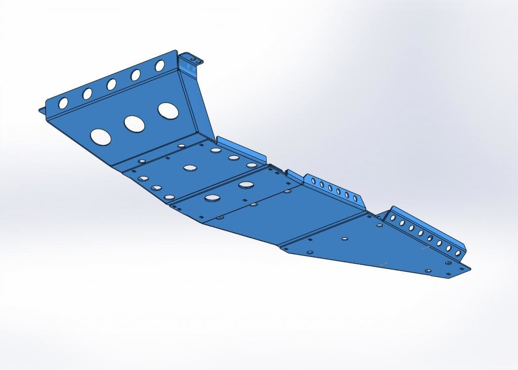

    quick preview....

    ^^ looks cool, neat design.. I like it. 3/16"? Must weigh a ton.. Looks like the front mount uses the tow hook bolts, how bout the rest (factory holes?). Any idea about compatibility with other aftermarket front bumpers? ...

    The skids are made using 7 gauge steel, just slightly thinner than 3/16". The set up shown weighs in at 112 lbs.
    They we designed them to use all factory mounting holes with the option to run carriage bolts all the way across the bottom so that you don't have to worry about ripping out bolts dragging the skids over rocks and such.
    The skids mount completely independently and you don't have to run our bumper to run the skids, but as for other aftermarket bumpers it really just depends on their mounting system.

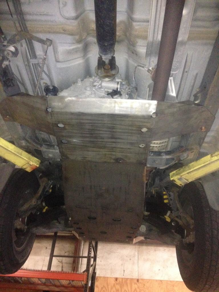

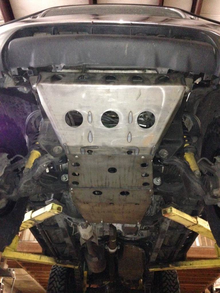

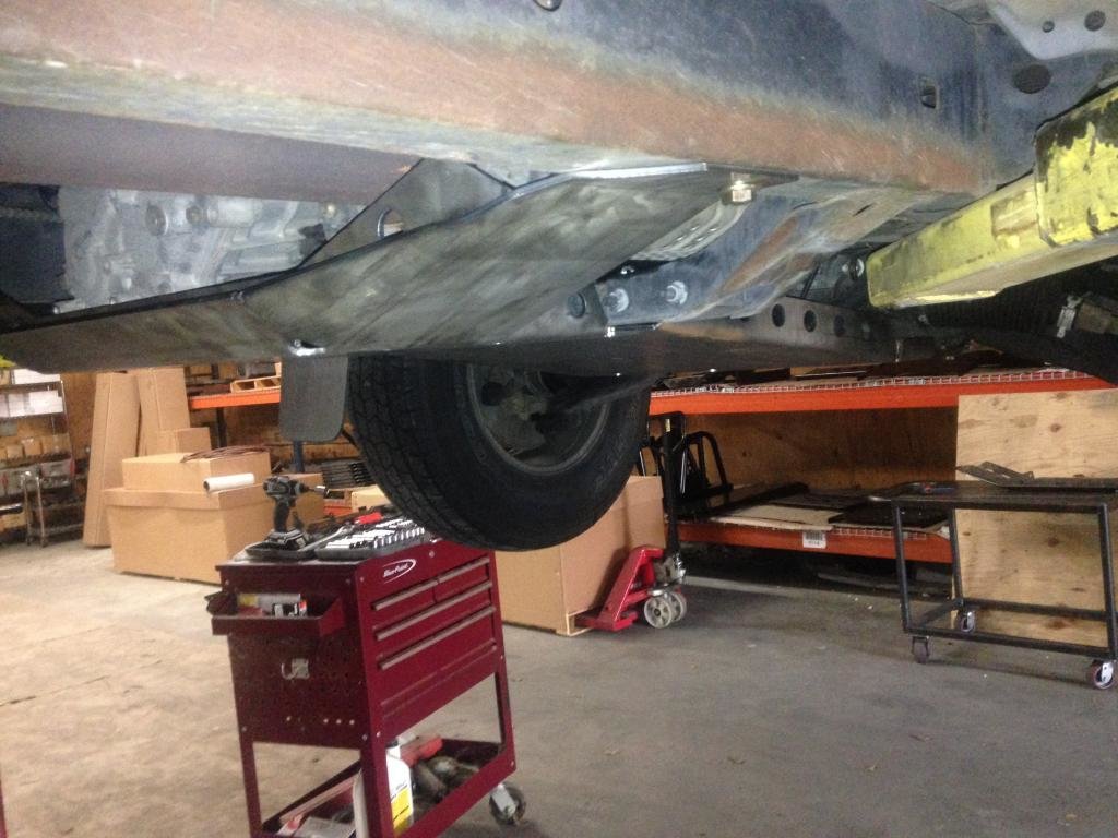

    Here are the results from saturdays test fit. 2001 DC. Looks like we are currently able to cover Radiator, engine and trans.
    A t-case skid will be in the works soon.

    T-Case skid wrapped up, and getting ready to do our first run of these skids.
