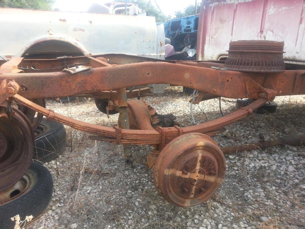

    50 per pack for them to pull wouldn't be too bad. Tell them the can torch it out if they keep it priced there.

    What you getting 63" chevy's?

    Even at those prices 150 for a pack you can add or remove as necessary vs 700 for deavers. Yea, I built my own.

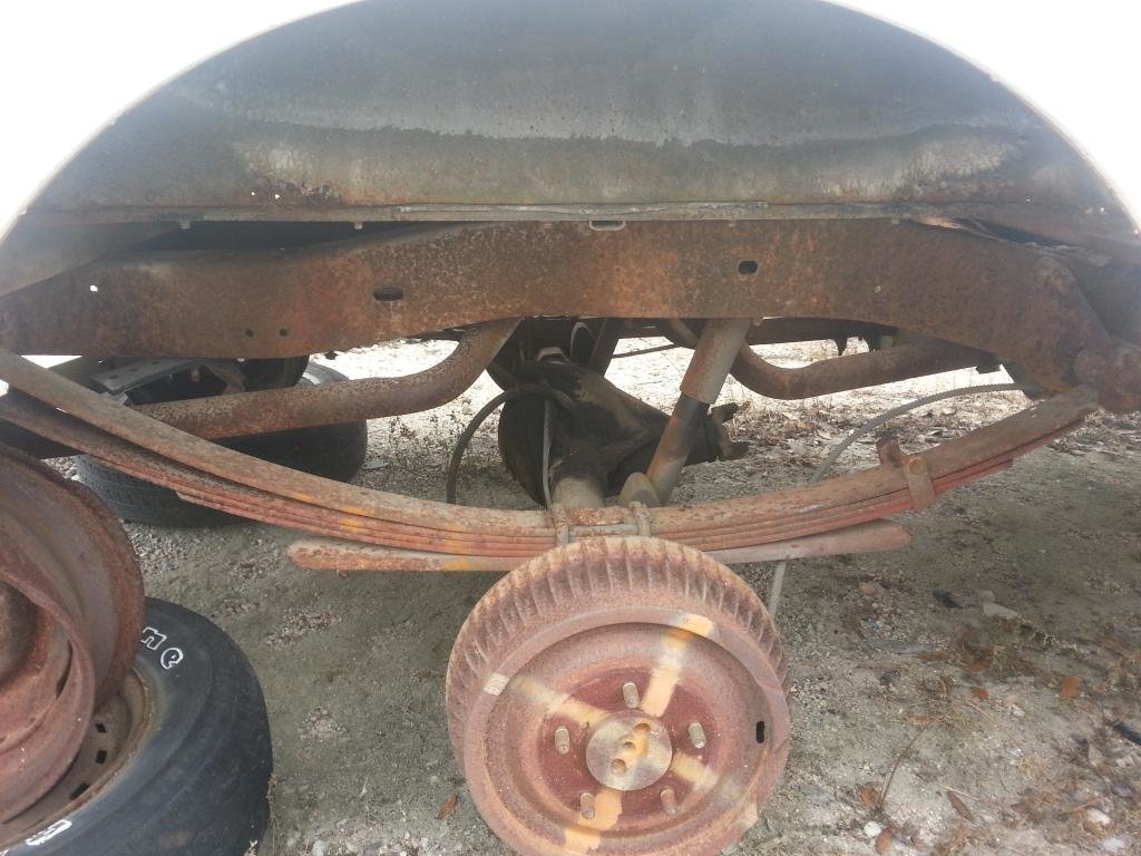

    Finding a lot of 2 1/2" and 3". Found what looks like 2 3/8 or 2 1/4" on an f350.

    Early 90s late 80s should be the right width. Should also be a lot of leafs in each pack. I used the overloads out of one of those packs on my truck.

    Ford. more leafs = more options right out of the box, and a smoother suspension cycle.
    the chevy also already has leaf separation in the rear with not a ton of drop. you want to keep the separation to a minimum if possible. not the end of the worlkd by any means, but no separation is the better option. among other things, separation, will lead to much more axle wrap when the suspension is dropped down while wheeling.

    That's basically what I texted him. Didn't think about the separation but he's 2wd and not wheeling just needing to tow a little.

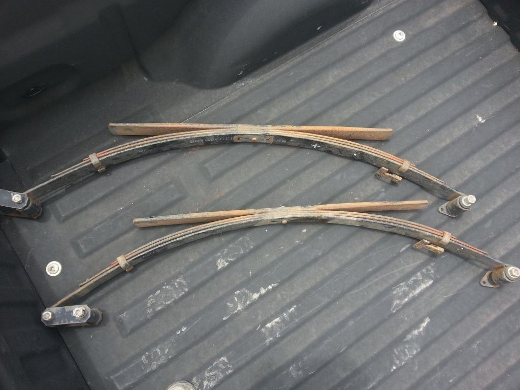

    $100 hope this works!!

    What the heck were those in? That arch is awesome. Might want to start with only one leaf.

    Don't know, they were hanging on a rack and no one had any idea what they came off of. Only numbers on it are B3928010B and Google finds my nothing.
