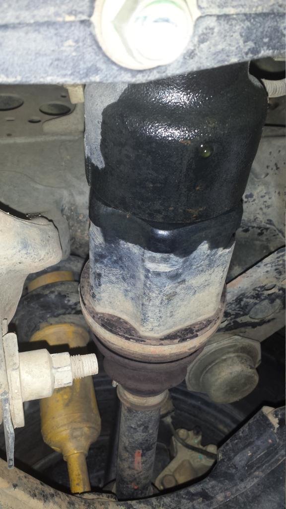

    Leaking front diff fluid on both sides where the CVs come out of the diff.
    Anyone fixed this before that can provide a parts list and if any special size sockets or tools are needed?

    How the hell did that happen?

    NO idea how it happened but taking some stuff apart to inspect a little more.

    Just replace the seal inside. Have you ever taken the cv out before?
  13. Jun 8, 2014 at 9:02 AM
    tex
    tex Well-Known Member
    Jul 9, 2007
    #2042
    4,159
    Fort Worth, TX
    2006 V8 Sport 4Runner
    Nope. 68,xxx miles and no issues till now.
    So I need a front axle seal?

    Yup, and a seal puller? I think that's what it's called lol pretty easy job. Itll take some time being this is your first time

    I'm sure there is a write up somewhere on how to do it

    I little pry bar will pull it out.

    Write up...
    Remove wheel
    Remove both bolts that hold spindle. (Bottom)
    Pry out cv from diff (let it hang down under diff)
    Pry seal out.
    Install new seal
    Line up the cv - use a long pry bar and hammer it back in.
    (Put some grease on the snap ring)
    Bolt spindle back up
    Put tire back on.
    Check diff fluid.

    Thank you sir. Calling part stores now to see if anyone has them in stock.
