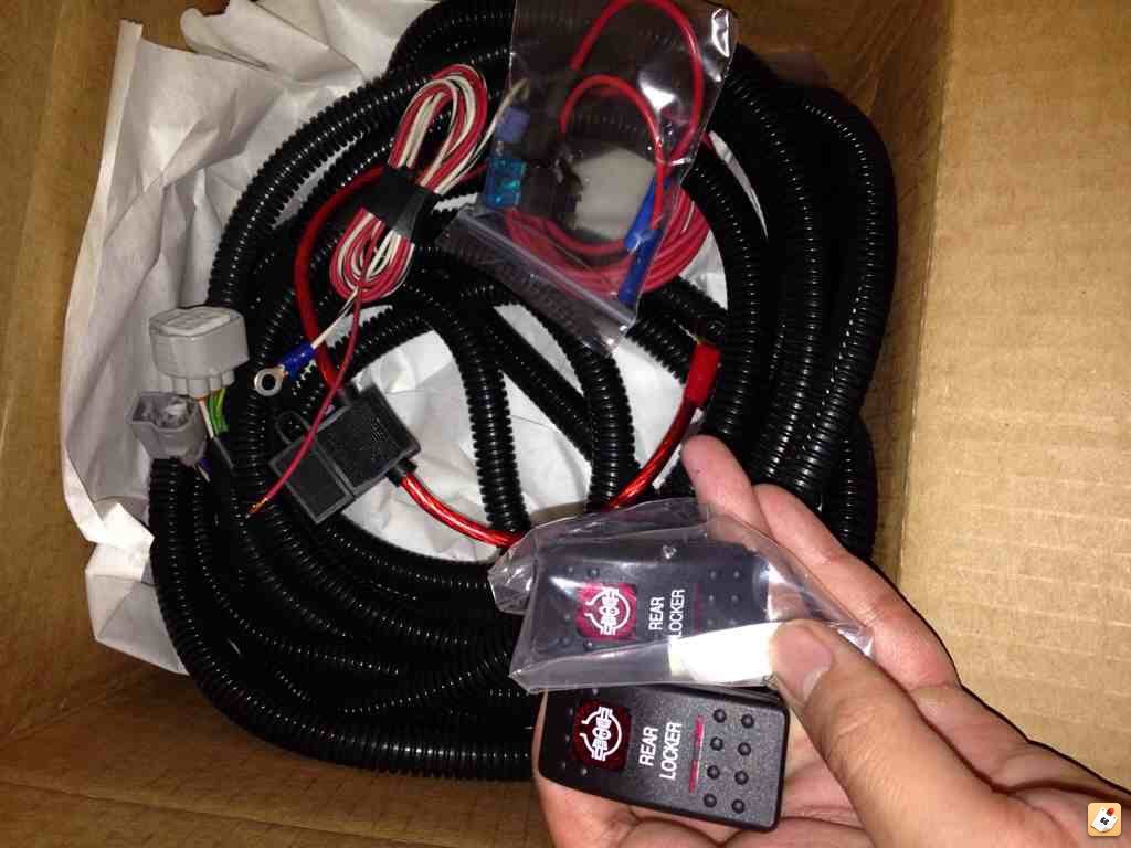

    Damn, that's a clean looking harness.

    Yeah real nice lookin but with holding most judgement until it works. Also they sent me 2 rear locker buttons lol

    It is supposed to come if you did the dually mod.

    Must have been a misunderstanding on my end or maybe not. I asked for a plug and play wiring harness and also needed the switch. Maybe I can find a dually rear end and do another swap :anonymous:

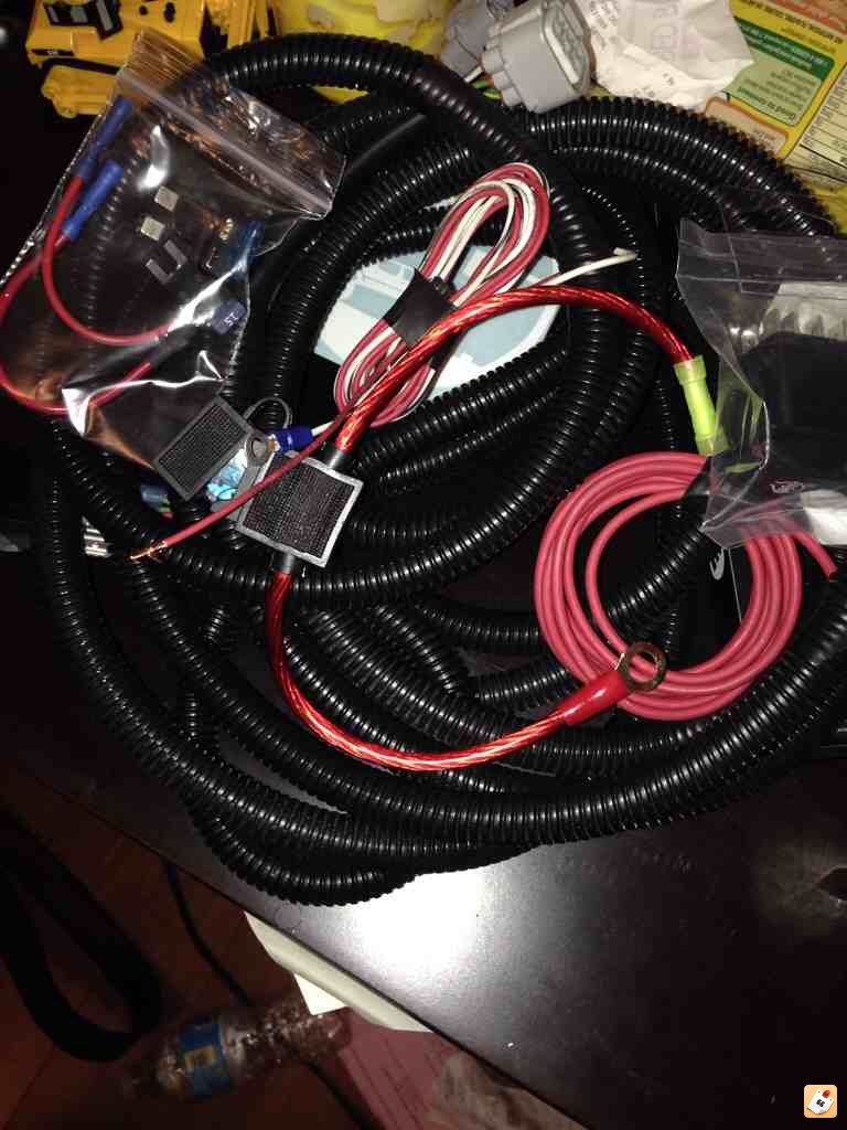

    zy9yju5u_d885cd20e00506a58b12e631b753359d0627cb28.jpgso I figure it be one end at the diff the other at the dash and then a + and a - but there's a few that I'm confused about. I'm guessing fuse relays? But one them has a dust cap?!

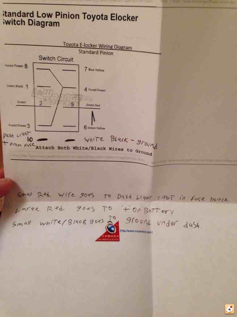

    7yma5uvy_6ce6fcd3aa5085d6c0ad484380453e7e528628a5.jpg found this...seems easy enough except for the "little red wire to dash light circuit in fuse block. This should be interesting indeed

    for the little red one, pop open the fuse box on the inside of the cab. look at the key on the bad of the change compartment. there should be a fuse labeled "tail" or something along those lines. should be a red 10A fuse. get an add-a-fuse at the autoparts store ($5ish) and use it in that spot. the large red wire to the battery is what gives the actuator power to switch the locker on and off. the smaller one that you hooked into the tail spot will illuminate the switch whenever you turn your head lights on (and therefore tail lights, hence the "tail" label).
