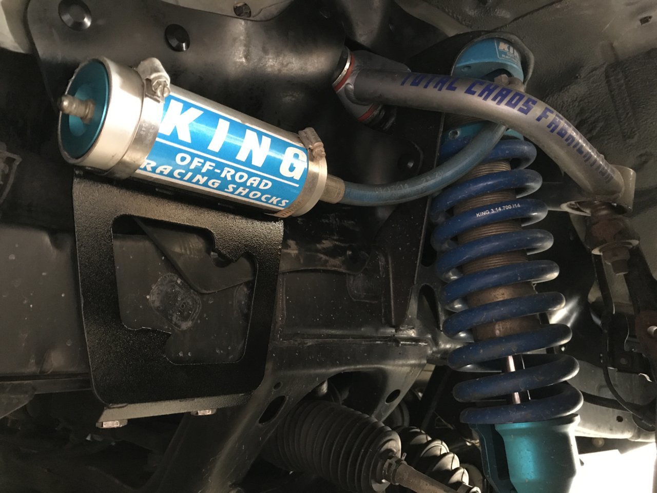

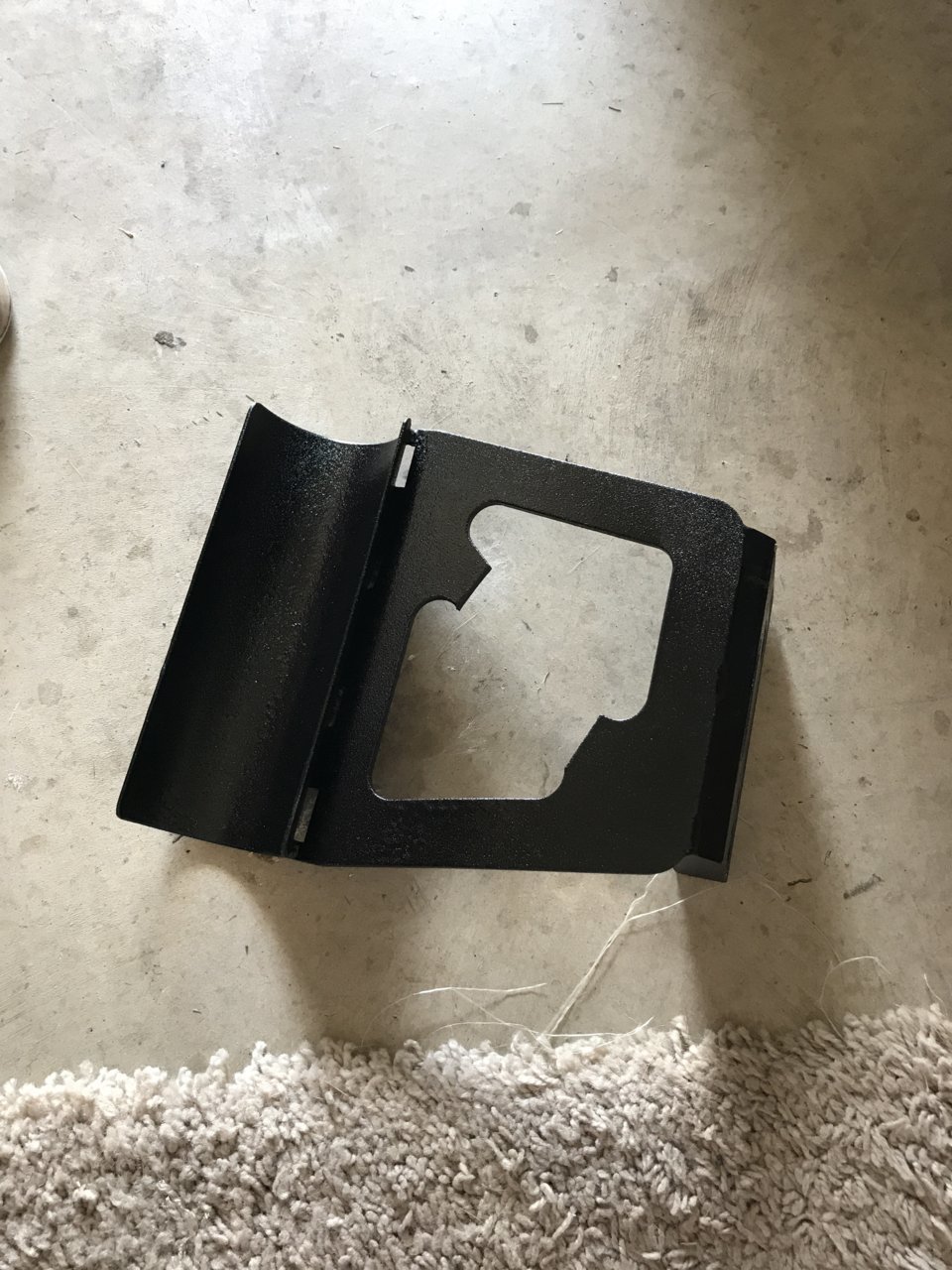

    Painted the reservoir mounts black top blend with the wheel well -
    And came across this...

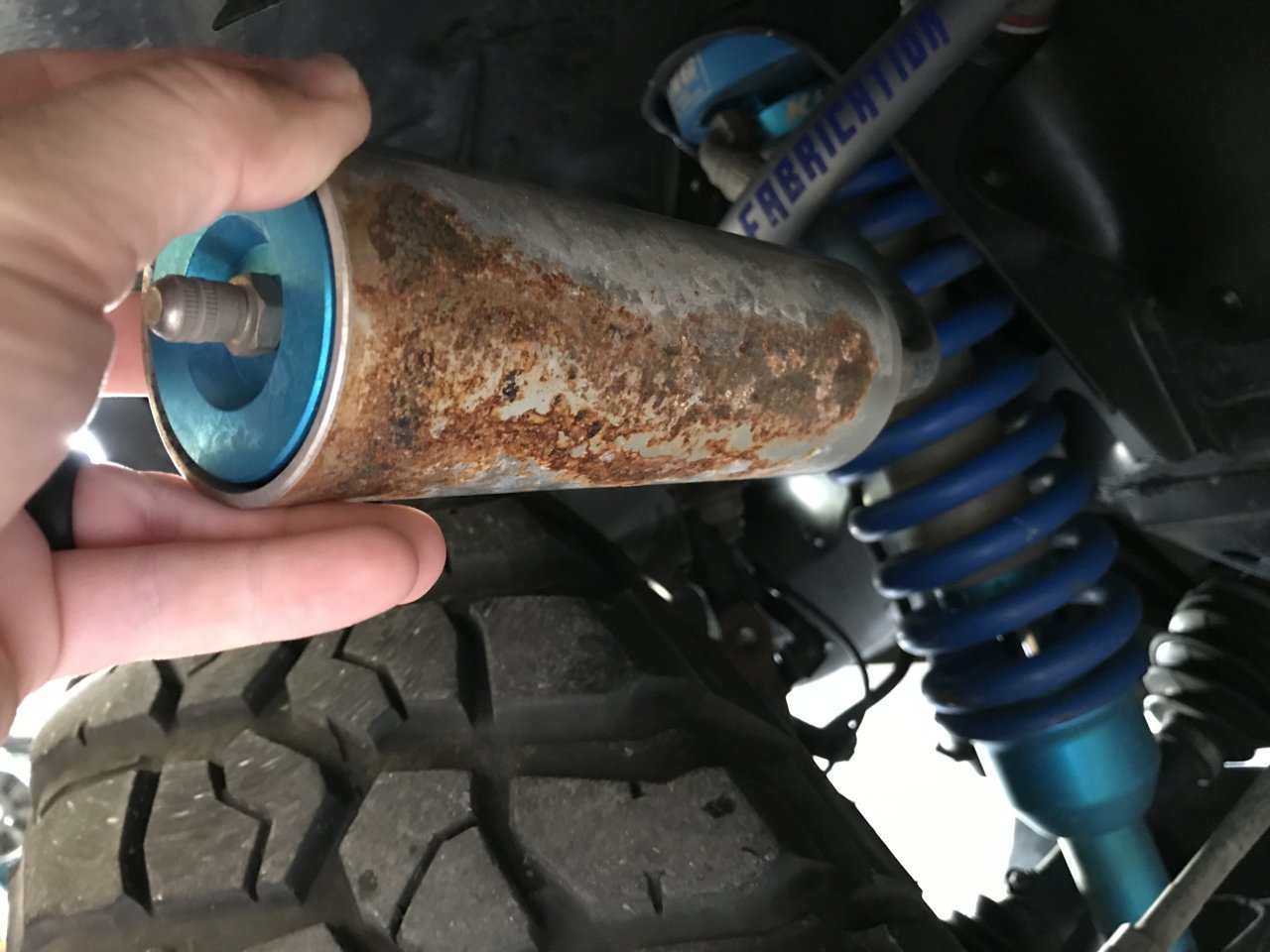

    Kind of annoying that $1800 shocks can do that.

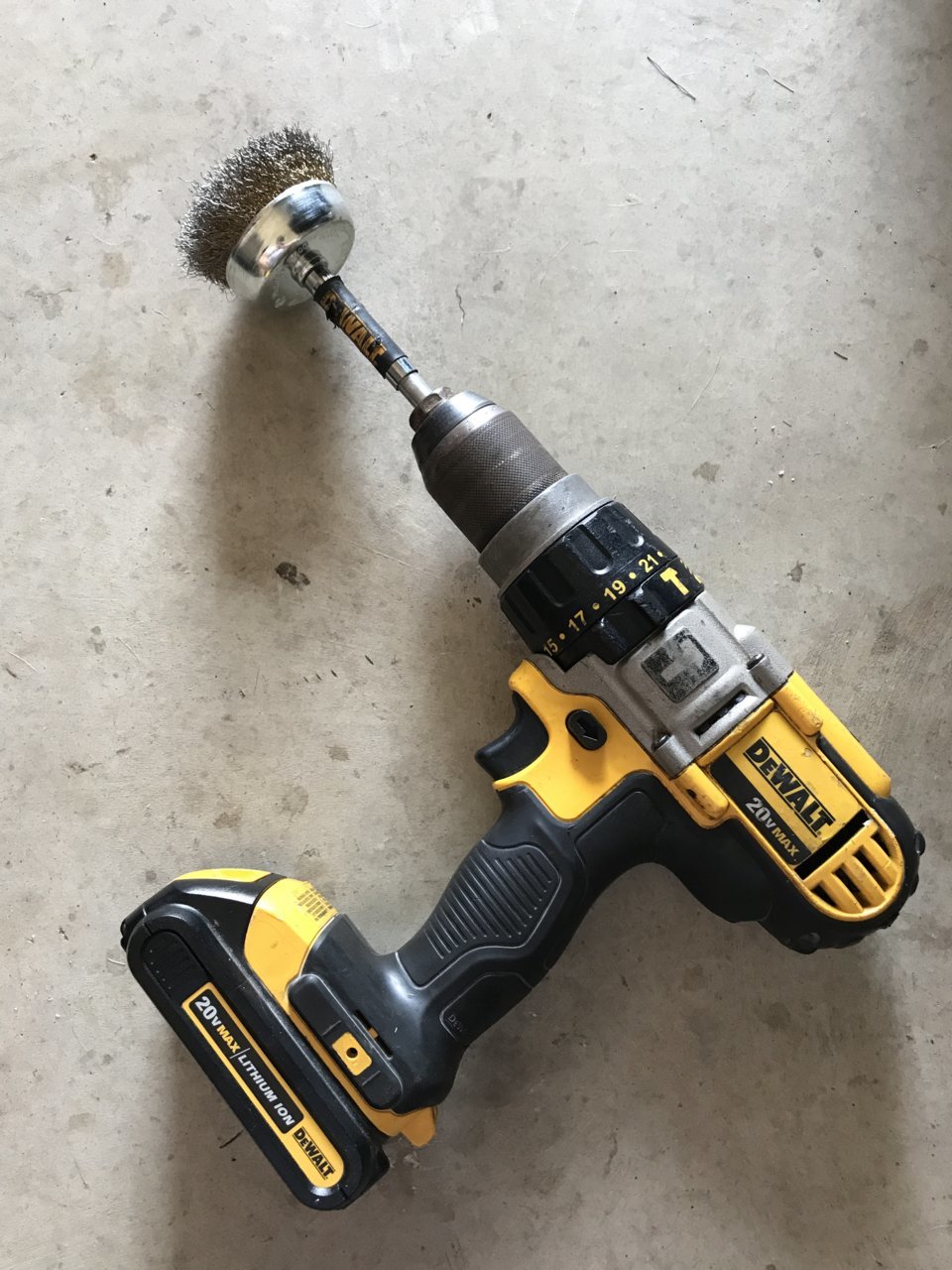

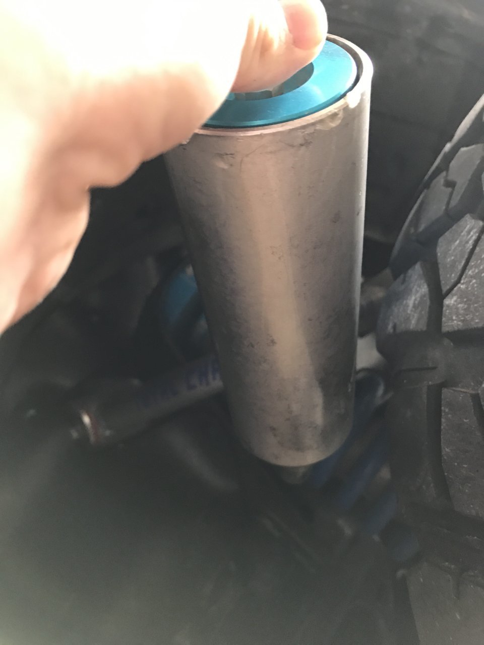

    Made quick work of it. Guess I gotta rinse a little harder up there after the beach.

    I was really surprised to see that. I'm not really sure yet exactly how it started rusting back there. The mount and the resi are aluminum. It came off pretty easy but there was some pitting on the resi. My best guess is it's the iron in the sand and dirt that rusted from the salt at the beach.
    I ended up getting the rest of the day off so I'll go ahead and get some clear coat on them. I'll also use this-
    To help with any rust I may miss.
