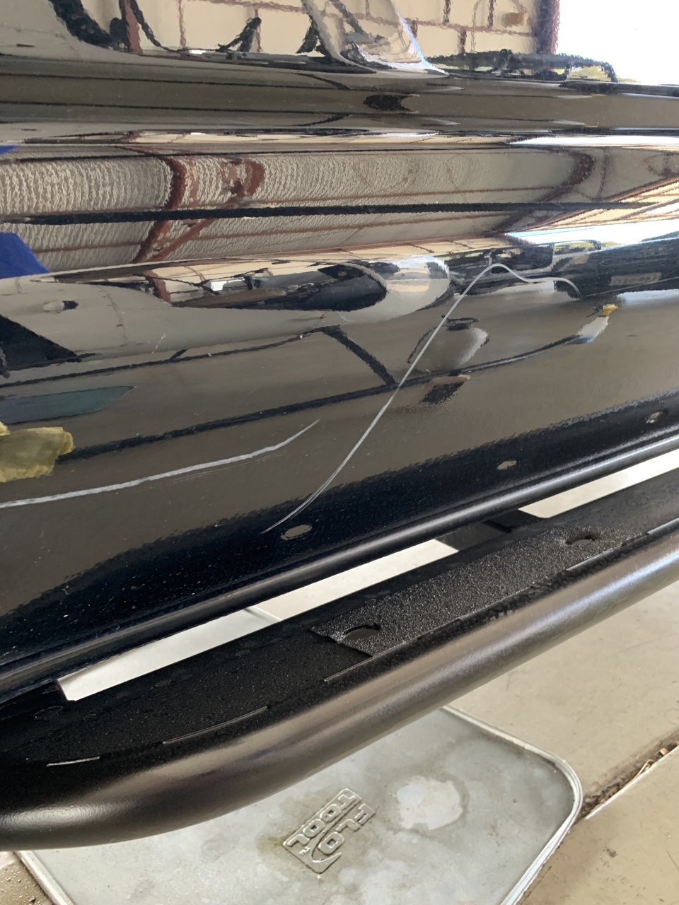

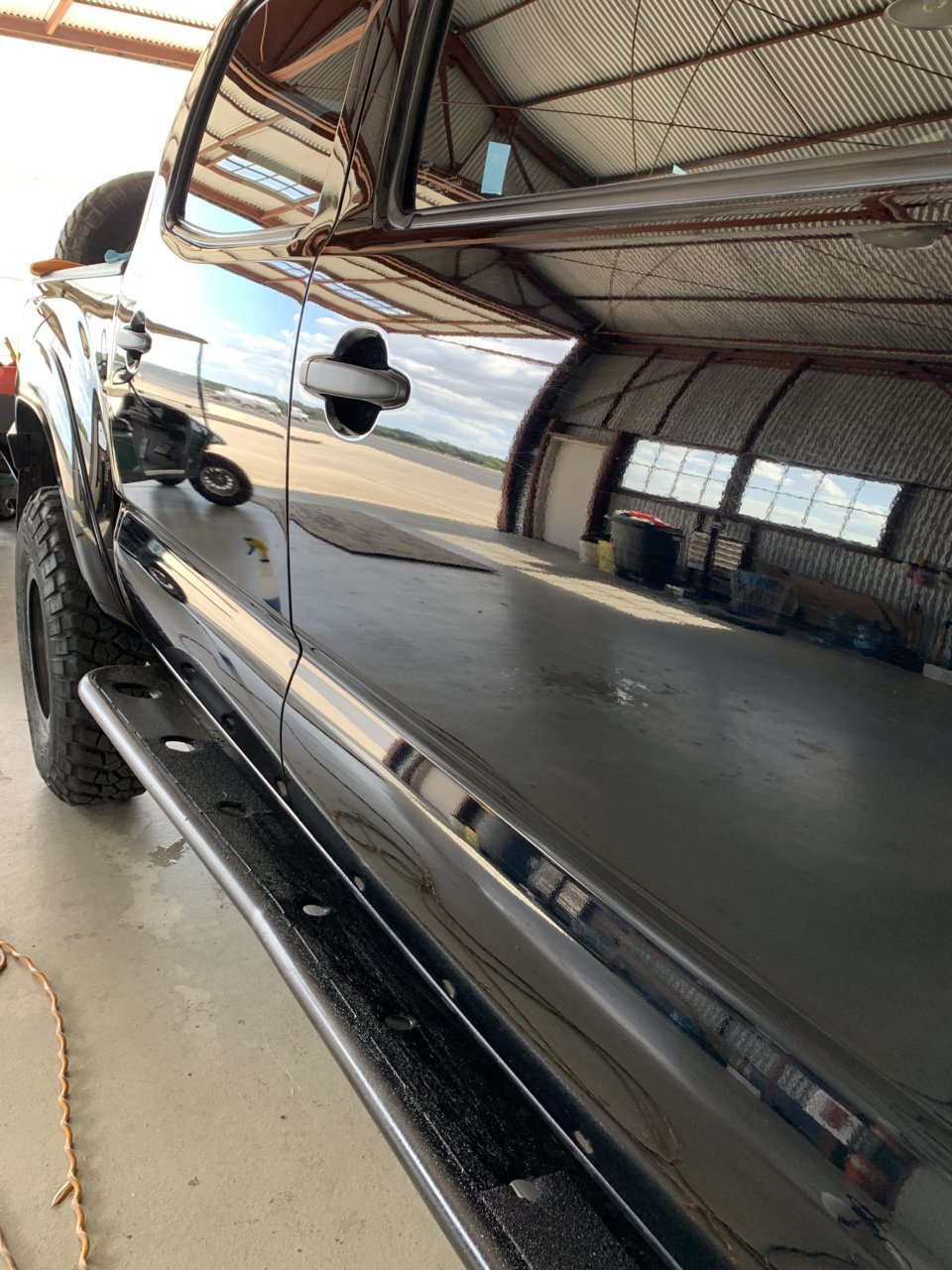

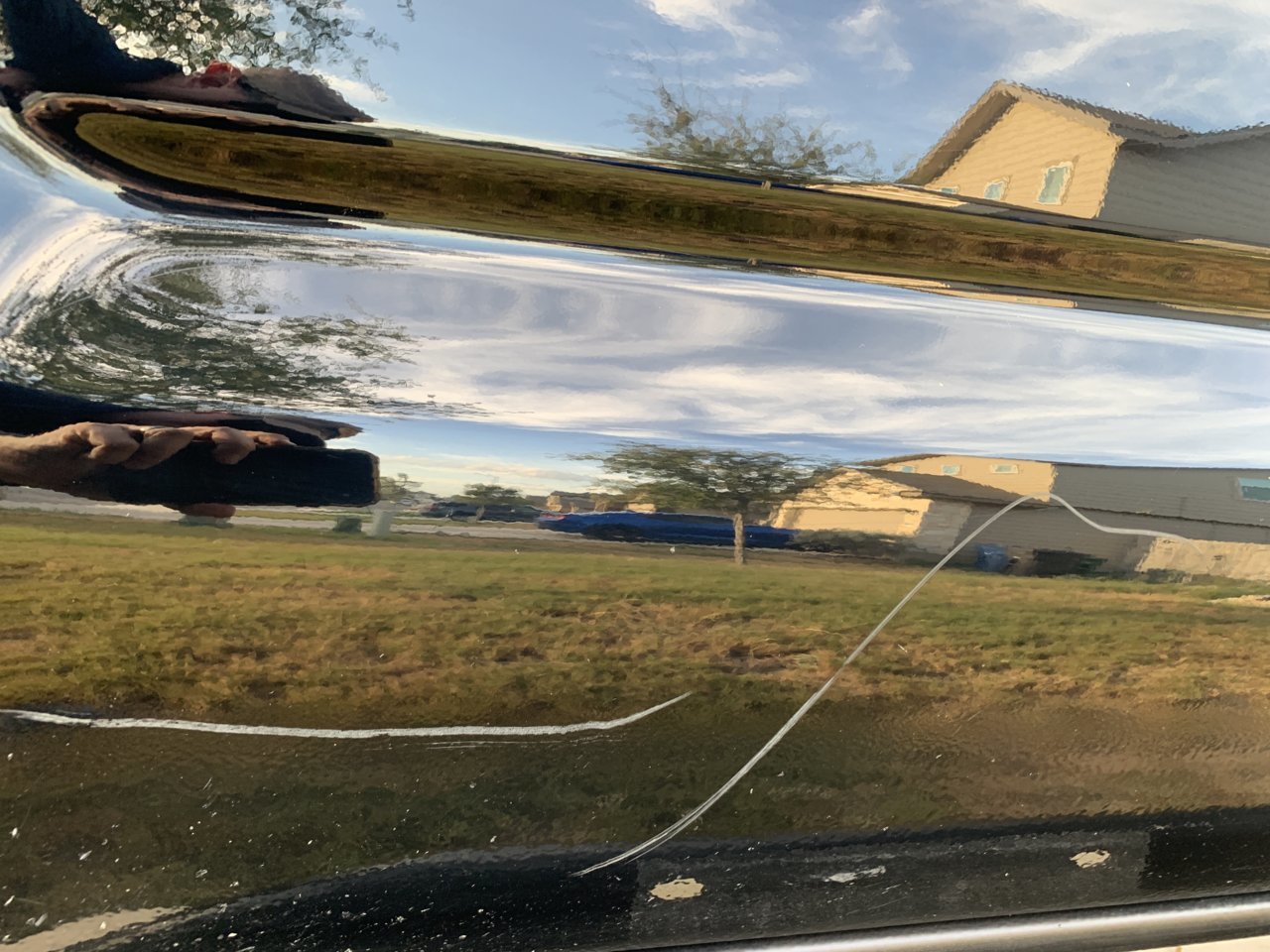

    Used some Meguires heavy cut polish recommended by the guy at vatozone on the truck during some down time today. Got rid of the small stuff, swirls, and a few pin stripes. Truck looks damn good and I can say I highly recommend the stuff so long as you're not trying to buff out gouges and bullet holes.
    B4
    After
    Black Mirror finish
    (that's looking AT the truck)

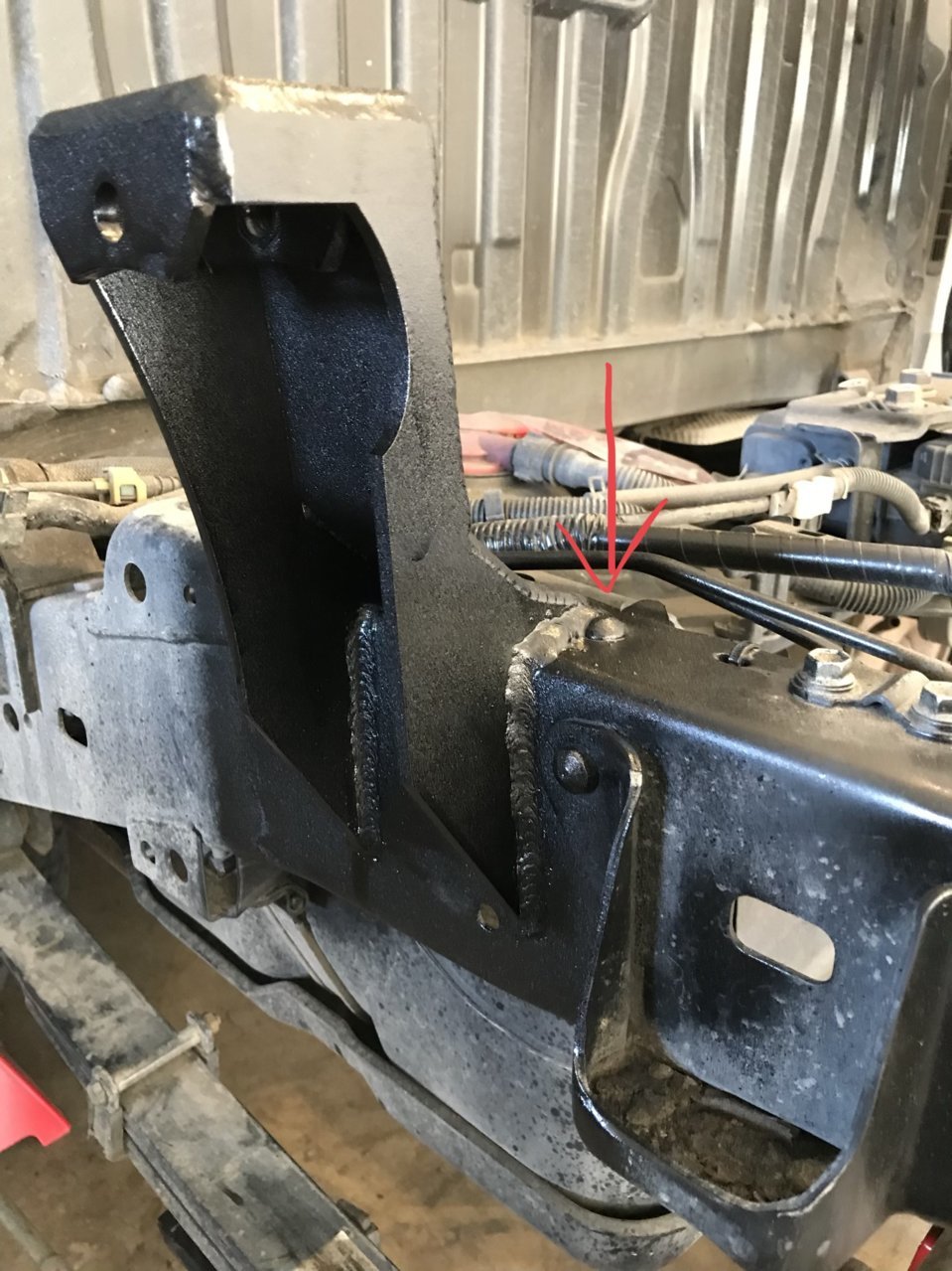

    Not sure if the third gens are the same as the second gens in this regard but there is a rivet on top of the frame, forward of the axle that literally gives you the best place to mount the shock towers. If you put the tower directly against it, toward the cab, you get an 11* angle on the shock. For ride comfort, 10* is ideal.

    Here you go Maner (@Bigdaddy4760), arrow points to aforementioned rivet
