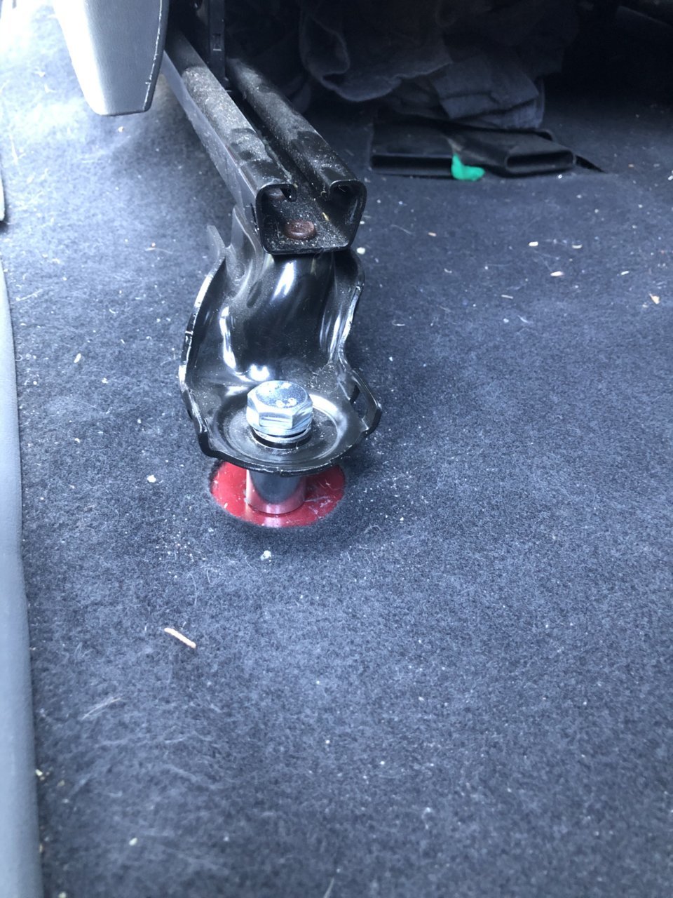

    :popcorn:

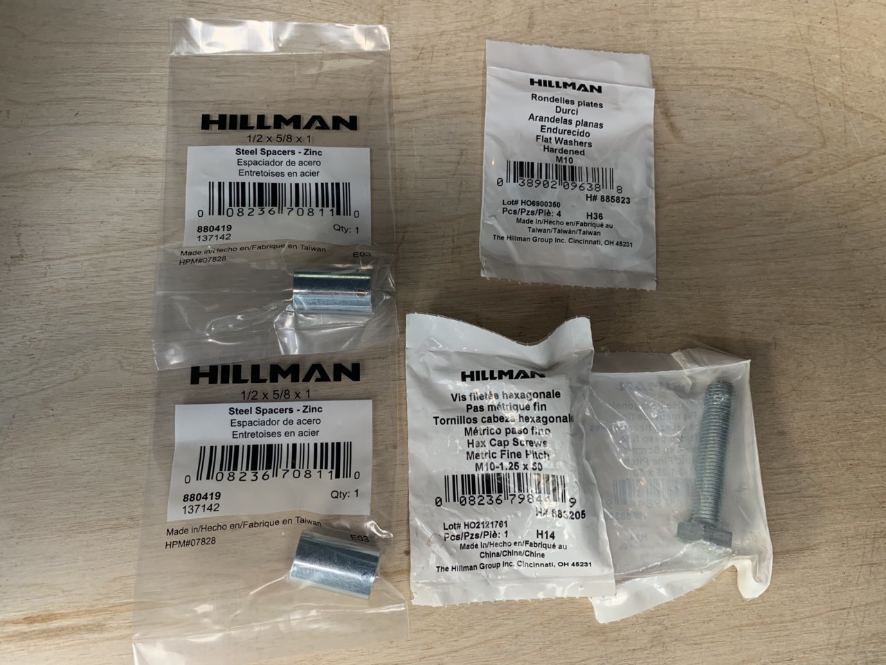

    Here’s the parts list

    Damn, what is that, a one inch spacer?
    Edit: Derp. Zoomed in. 1/2"... Am tired.

    Yes 1/2 diameter I believe 1in tall.

    That's quite a bit! I'm assuming only for the rear? Only doing the driver's seat?

    Yes sir just the rear I’m gonna do drivers first to make sure I like it then I’ll get other seat.

    No dice at Home Depot I’ll reply when I have it done and tested.:frusty:
    HD hardware selection is garbage.

    You doing the seat spacer to bring the back of the seat up? You'll love it. I didn't notice a difference in my seated position while driving, but I did notice that my lower back hurt a whole lot less after hours in the truck. This is one of those mods I wish I did much sooner than I did.

    Ya that’s the one I just finished taking a test ride it does feel better my commute one way is usually 1-1.5 hours one way.
