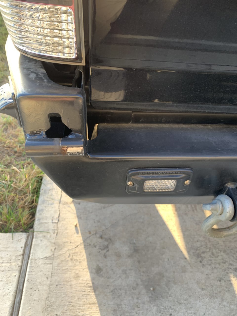

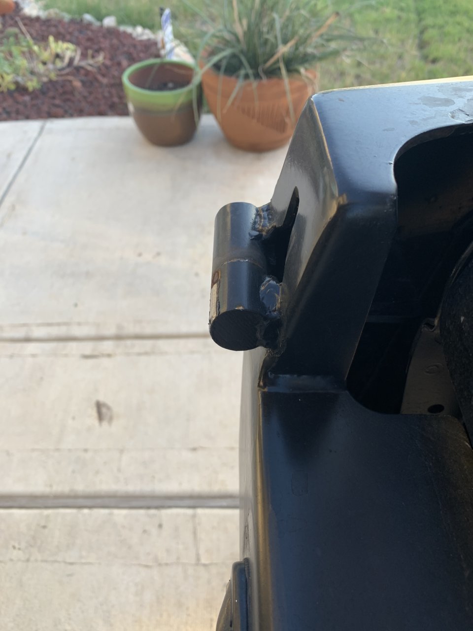

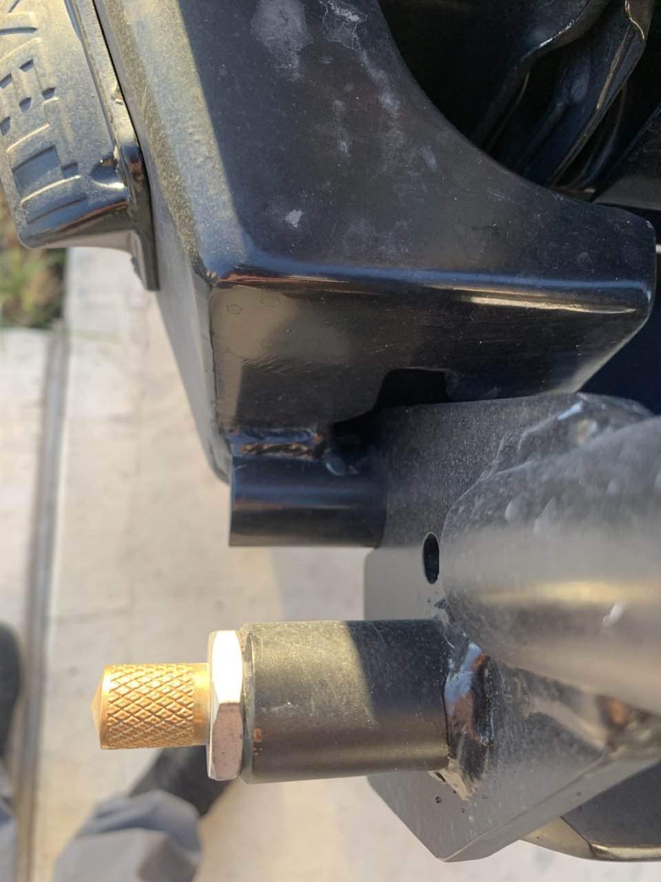

    do you have any more pics of how you mounted the pin for your swing out latch? Seems to be recessed. Looks good
    I’ll be building my swing out with the same hinge/latch soon

    The way the pelfrybilt bumper lines up with the back of the truck made mounting the pin a bit tricky. I used a grinder and cut a hole where the latch would sit and @DiamondW welded the pin over the top of it. The hole looks funky in the pic because that’s where the pelfreybilt “P” was.
    Let me know if you need anything else, happy to help.

    Thanks! I was going to use tabs at either end of the pin to mount it to get enough space for the latch to operate. The way you did it lets it sit a little more flush to the bumper.
