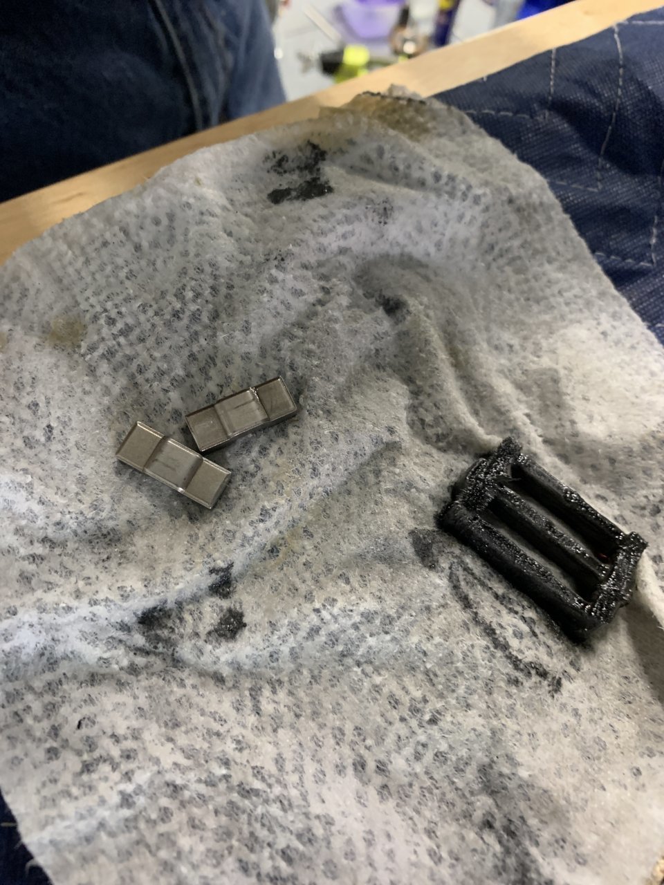

    So flywheel bolts have now been replaced and torqued properly. Don't think I got pics of that.

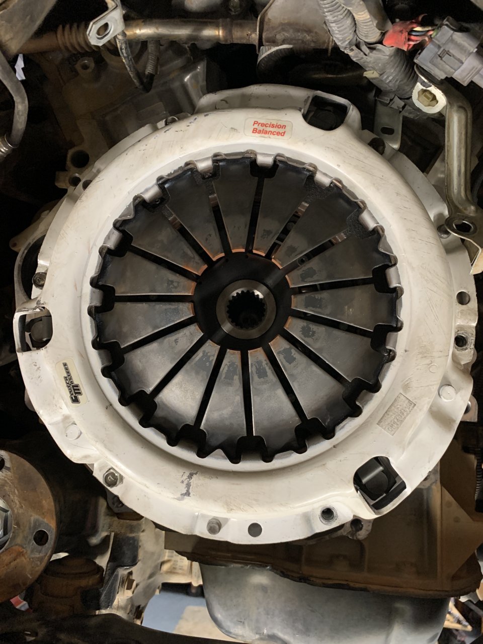

    Pressure plate looks like like somebody was playing frisbee with it but nobody could catch. Can't figure that out.
    This is AFTER I cleaned it up.

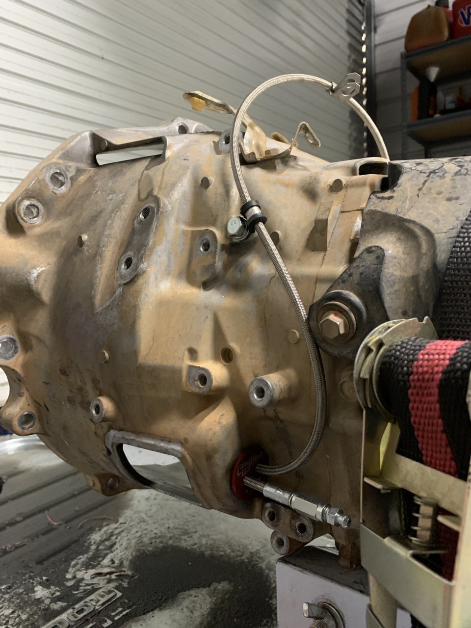

    I didn't get pics of the hydraulic hose before, but it was weird and flopping around in there all loose like. So here is how I did it
    Took me a whole 30 seconds to do it correctly. I cleaned out the bell housing too, it's shiny and new looking again.

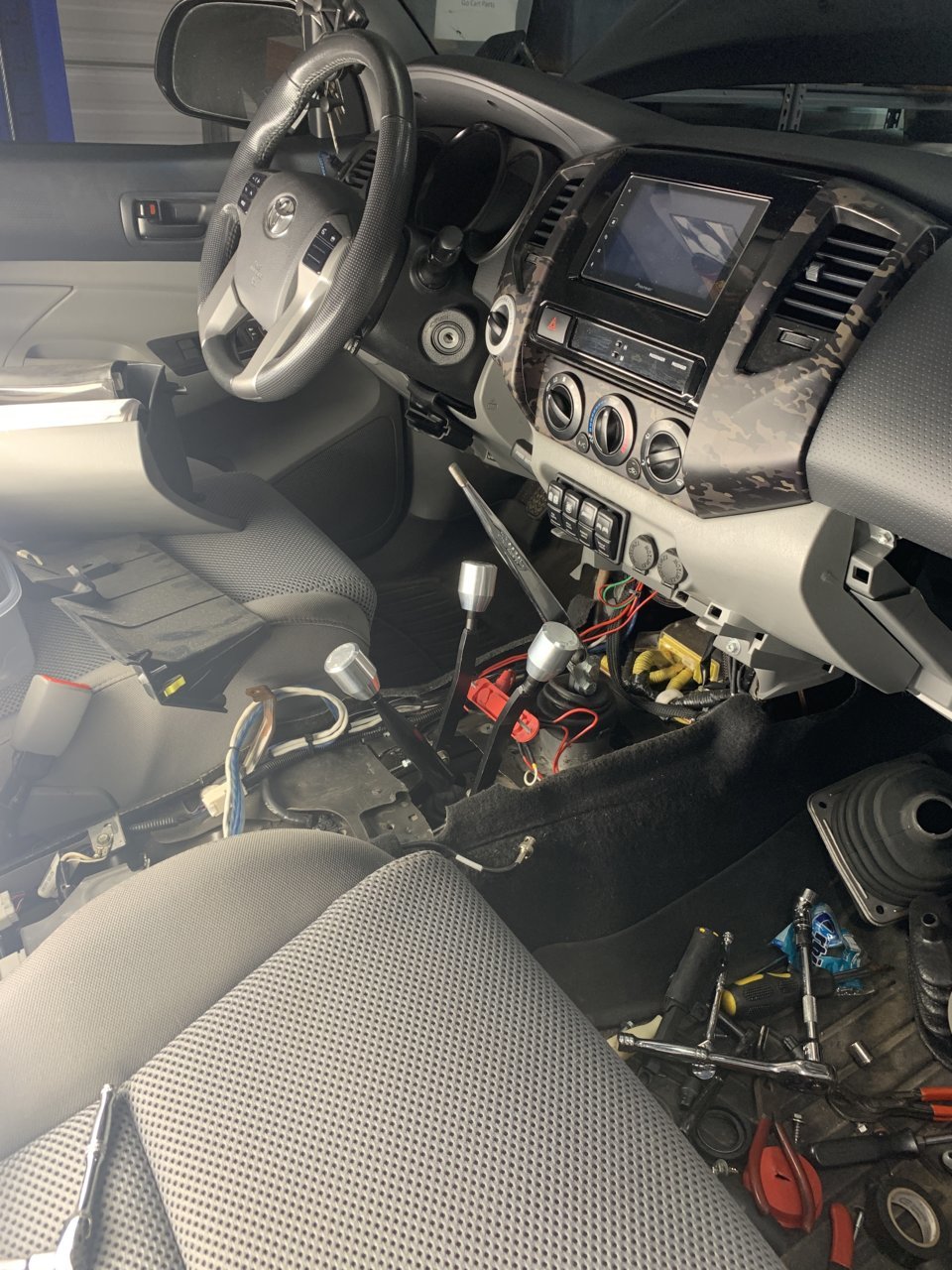

    I beat the trans tunnel into submission and clearanced the t-case and sticks. Got the t-case split, modded, and twin-sticked. Even though we split the case in 2wd, the damn keys popped out.
    I ended up pulling the other shift fork and gear and that made things a lot easier. They really weren't hard to get back in once I figured out what they were and how they fit and functioned.
    The guy at the shop doing my drive shaft shafts said doing a one-piece rear would only cost a few bucks more than chopping the intermediate shaft so I'm really happy to have a one-piece rear going in. They should be done sometime tomorrow.
    First thing tomorrow we're going to trim out the interior then put the trans back in. Then the t-case case and crawl box and figure out the placement for the sticks.
    Despite a few slow downs and hiccups we're making good progress. I think we can get the front diff done sometime tomorrow afternoon and hopefully get some drive shafts back in by the end of the day. Hopefully we will have some ghost riding going on tomorrow evening!

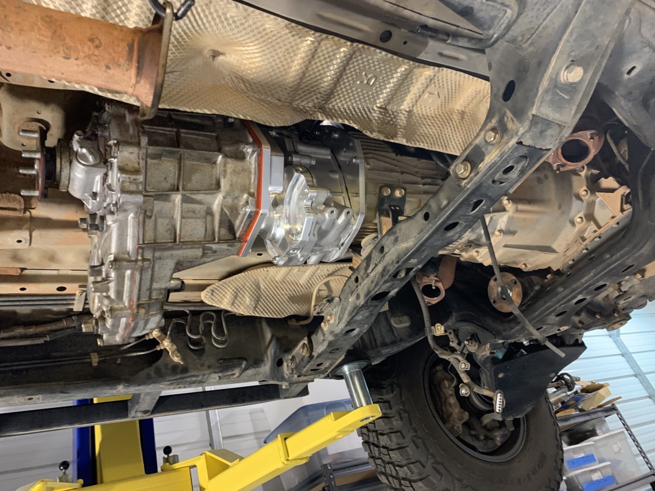

    Another productive day in the shop!

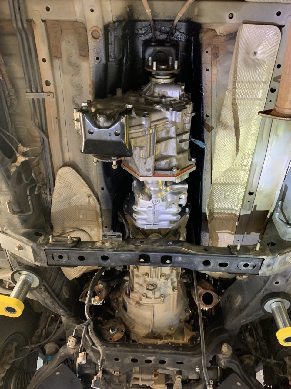

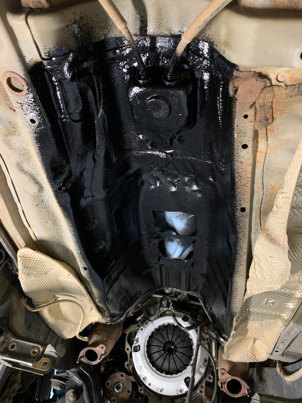

    Added some rubberized under coat where I beat the trans tunnel
    Clearance is a little tighter than I was expecting with the crossmember bolted back up and everything clears so I'm cool with it. No one is going to see it anyway, right?

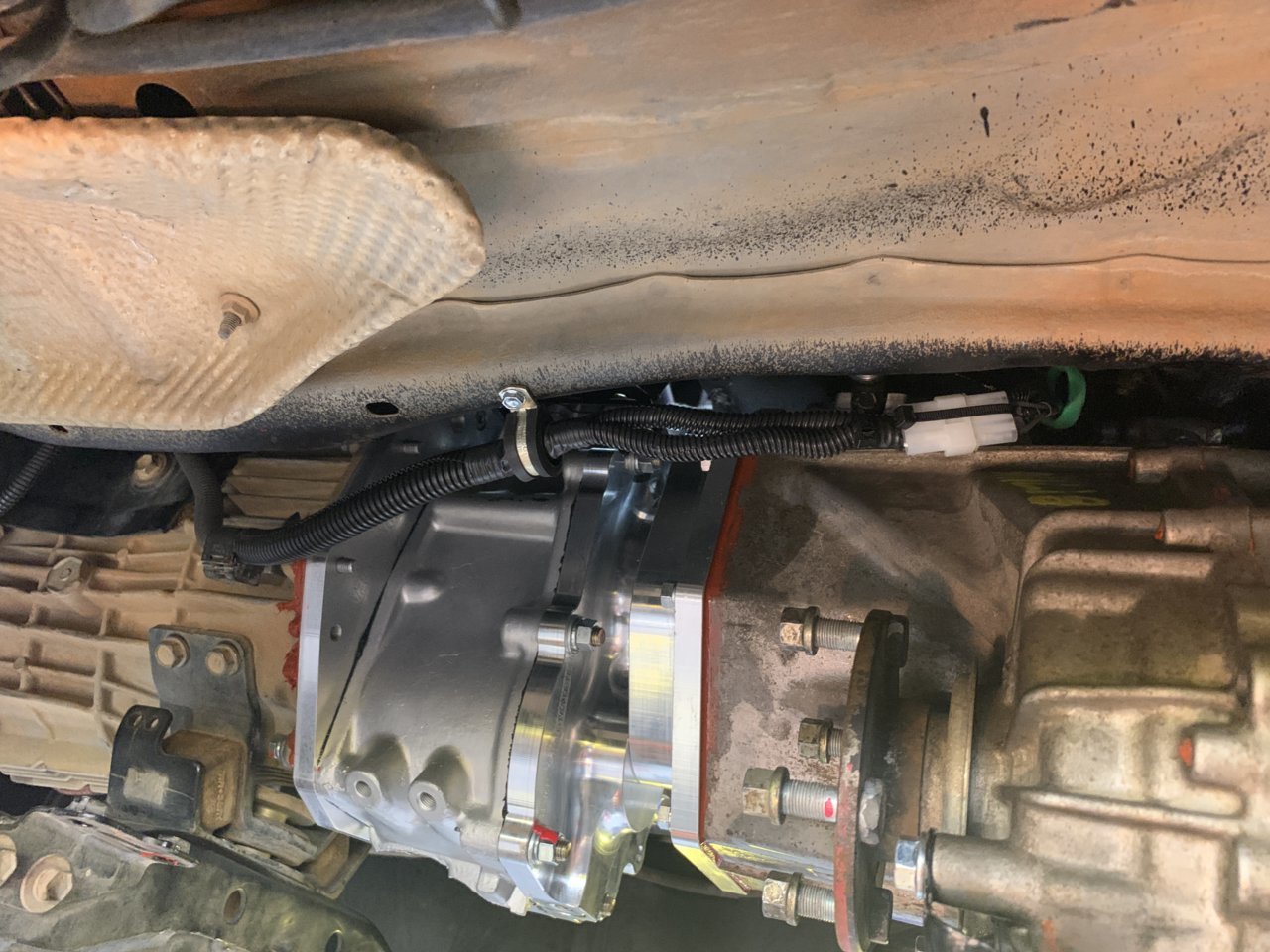

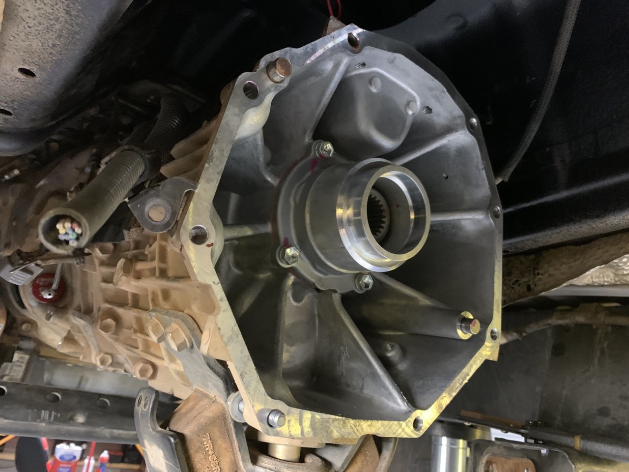

    Put the transmission back up and tapped in the oil seal extension and the coupler for the t-case. Also snaked the hydraulic hose up nearly and safely. I'll get pics of that tomorrow.
    We got the crawl box and the FJ case up and in without too much trouble

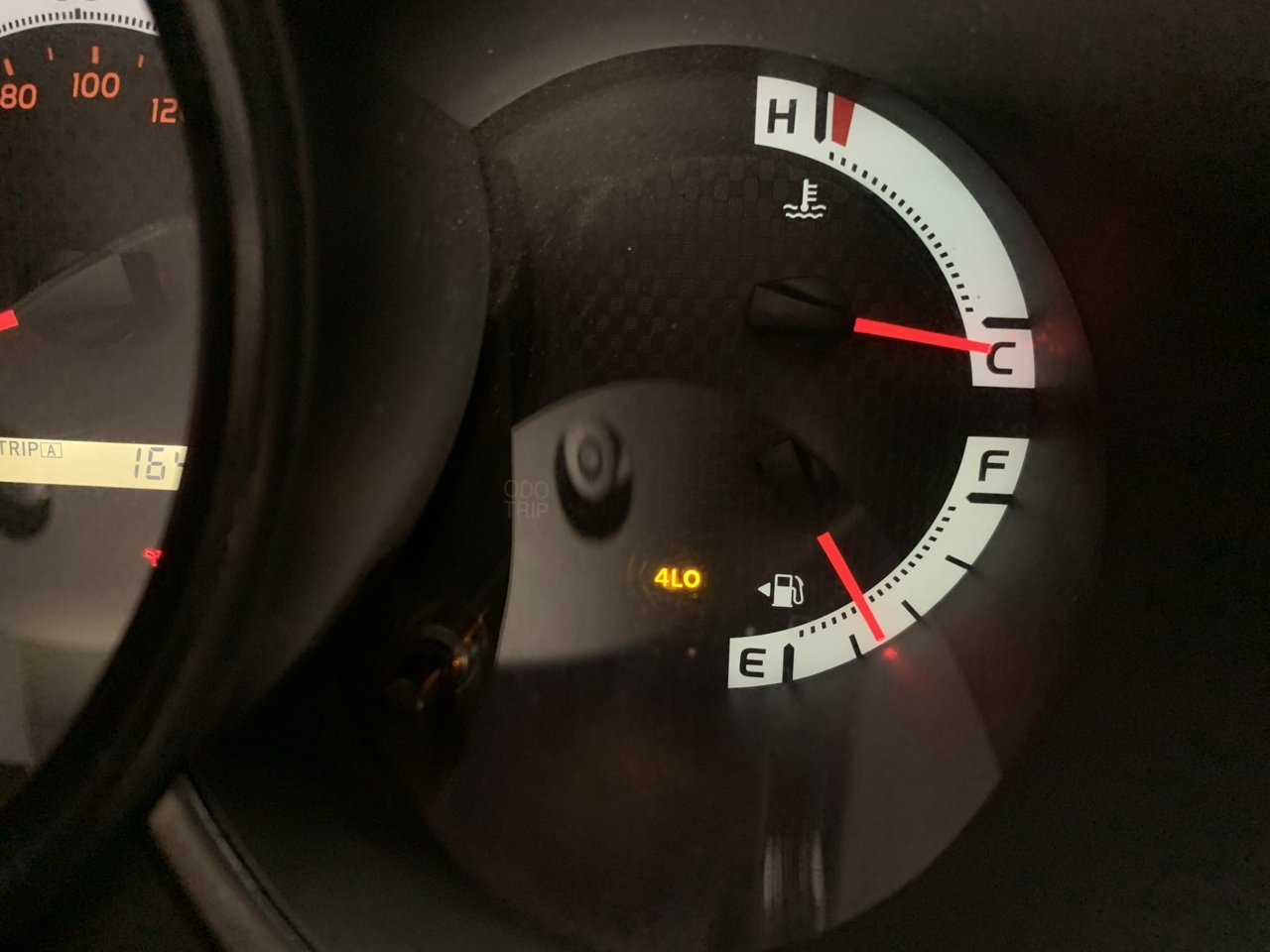

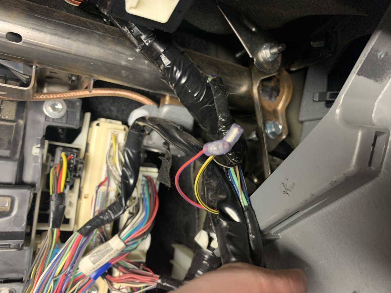

    After double checking all the bolts and sealing up everything we got to work on the wiring harness. You can see where we extended the pig tail and secured it to the tub with a self tapper

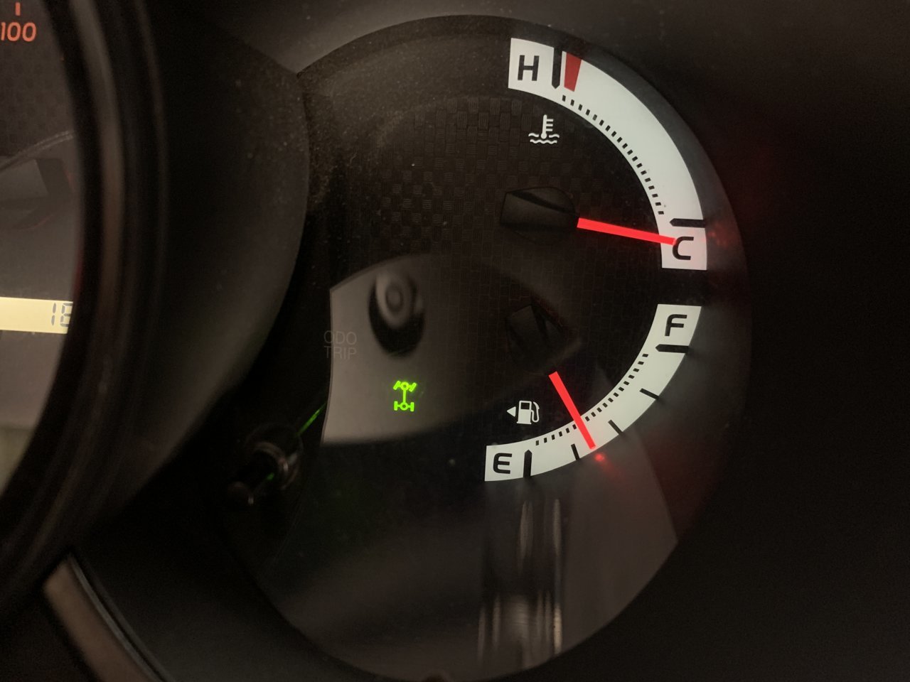

    There was a bit of confusion with the wiring harness and the 4x4 ECU. It took a few minutes of WTFs to realize my truck has a combination pre and post 2008 Tacoma harness. Which is weird because it's a 2013. Luckily the wire colors didn't matter and they didn't change the pins in any of the plugs. We tested, mixed and matched, and then connected the wires from the correct pins with wires of incorrect color combinations and it worked!
    2WD Low
    4WD Low
    4WD High
    Hell yeah!
    Here's how it's looking inside right now.
    Tomorrow we'll finish up the FJ tube and double check clearance between all the sticks and shifters and seal up the new hole in the floor. As long as everything clears I'll just drive it home like that and finish it all up later to look best and as factory as four fucking shifters can.

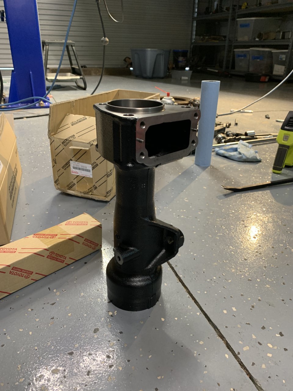

    Called Camelback Toyota three times and no one ever got back to me about them sending the wrong parts. I ordered the correct one AGAIN and it should be here Friday. I really need to be on the road home by Friday afternoon at the latest. I'm just going to go ahead and take next week off as well to go to Utah again.
    Today wasn't as productive as we would have hoped. The FJ tube was actually a Taco/Auto FJ tube, not a manual FJ tube that I needed. So, I put the front diff back together so we could move forward. We debated the ADD bypass switch but decided not to worry about unless the FJ tube doesn't arrive on time. Fingers crossed that shit gets here Friday.

    Got the front diff tube all taken care of :thumbsup:
