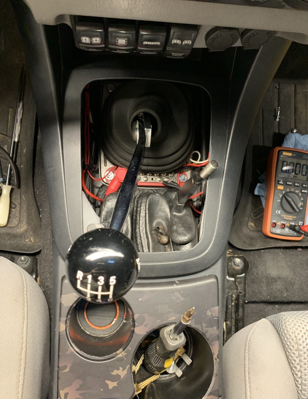

    Good so far!
    Weeps a bit out the shifter even with 2 qts but I am loving this thing!
    4.7:1 is so, so nice

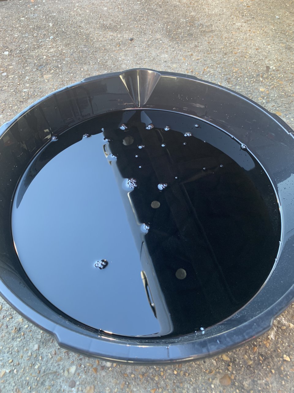

    From NC to Texas to Moab in less than 48 hours! I did change the oil after the first 500 miles but it was mostly because it was leaking like a stuck piggy and I wanted to know how much was still in it. Turns out it was about 1.5 qts but the oil was blown all over the under side of the truck so it looked like a lot more than it was.
    Half a quart looks like a lot when it's blown around into a fine mist
    Like my lift?
    First change, a lot more than I was expecting and I was happy to see it.

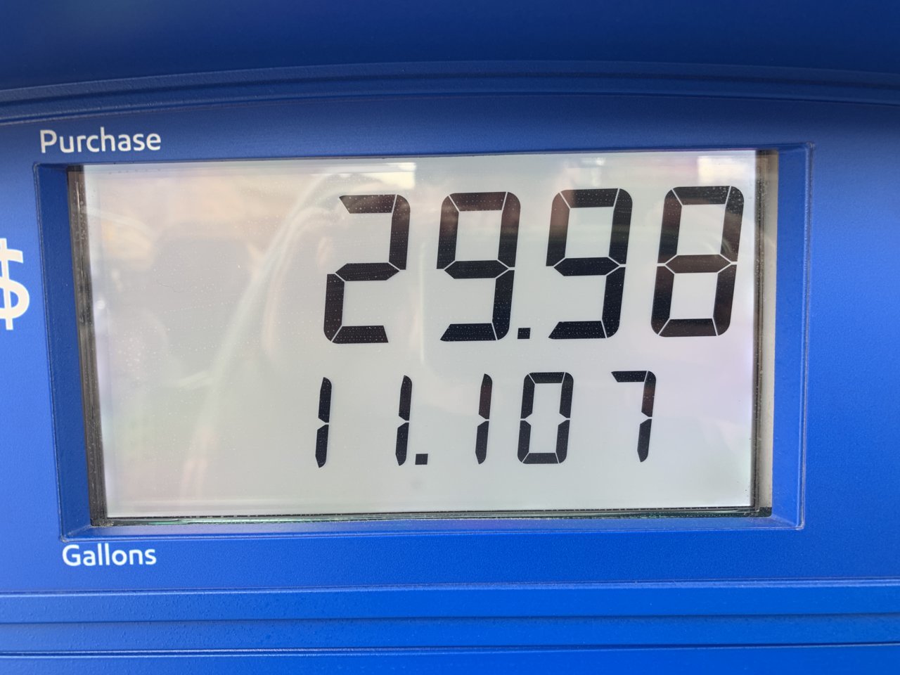

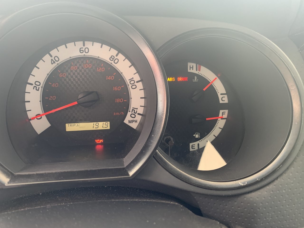

    Hey so this weird thing has happened since the install. And I cannot make any sense of it. I constantly bitch about my fuel economy, 12.8-13.3 is normal. Even on the highway. Since the install my fuel economy has gone UP.
    Here's my most recent fill-up
    I was showing about half a tank
    Corrected trip meter for tire size is 206.2 miles driven
    Fuel
    That's 18.5 mpg
    I've NEVER gotten 18.5.
    On the way back from NC I was consistently getting 16+ mpg
    I expected to lose fuel economy, not gain it!
