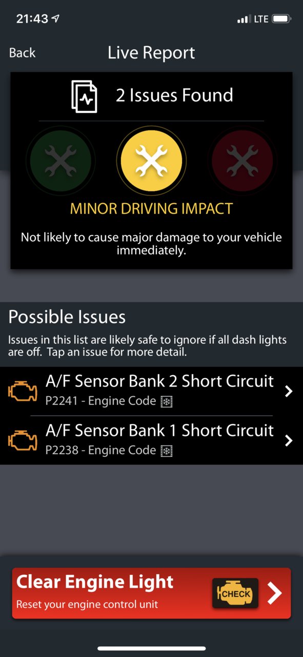

    My grandmother got me a code reader for Christmas a few years back. It's pretty cool, it just stays plugged into the port and it connects to your phone via Bluetooth.
    Here's a screenshot from it

    I'm guessing you fixed your O2 sensors or whatever lol

    Actually I get that code about every 5th start. Ever since those dickheads at the clutch shop replaced my sensors.

    Lame. Probably crappy aftermarket sensors. Electronics and durable parts I use genuine Toyota. Wear items and maintenance I generally use aftermarket.

    They're Bosche, pretty decent name brand for that kind of thing. I bought them online and had the shop swap them in. Figured it would be easy enough since they'd already have the trans dropped. They're in the correct place and the connections are good. Haven't been able to put my finger on it.
