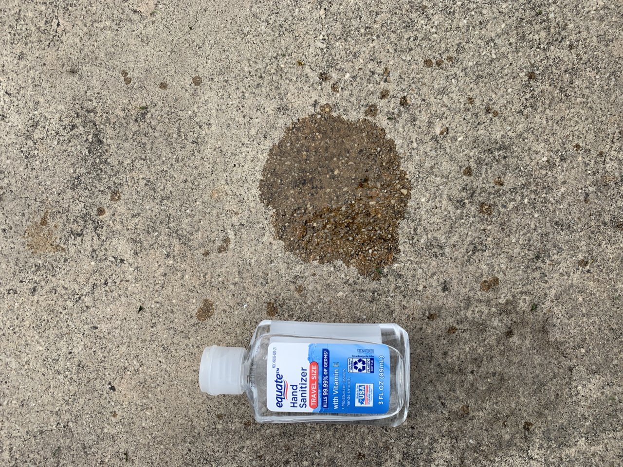

    Just sucks. Take some pics when ya get it apart. Even if ya got to spend a little extra to get it correct in the long run it would be worth it.

    I completely agree.
    I had considered taking the whole thing to a machine shop so they could get both mating surfaces perfectly smooth. The cast for the box itself was garbage. It's not smooth at all on the outside so I can only imagine the mating surfaces are the same way. On the Marlin cases, it looks like that's something they addressed and may have resolved.

    Good idea they might be able to surface mill it straight and add groves for o-rings

    Hadn't thought of the o-rings till you brought it up. It's worth a shot.

    Can add a little rtv also if needed with the orings.

    I think what I will do is try resealing the entire thing first. If it's still pissing oil after that, I'll take it to a machine shop and go from there. If it's still pissing oil after that, I will suck it up and live with a pissy crawl box. Or just put in a fucking Atlas II and be done with it..

    When ya have it apart get some prusion blue and put on it and tighten it up and see what your pattern is. Take pics. It will show you high and lows in the castings. You might see it’s not worth it. Maybe you can take the highs of by hand.

    It did that in a half hour.

    I expected it to gush out around the shifter until it found a happy level but I wasn't expecting it to leak everywhere else.
