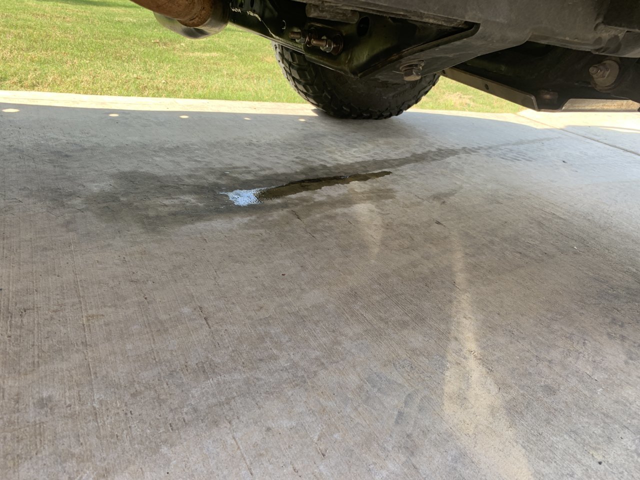

    Fun fact: if you remove the adapter plates you void the warranty on a Marlin crawl box crawl box purchased through Marlin.
    This morning:
    And it's still weeping at every seam.
    I just got off the phone with Marlin, they said they'll "do me a favor" and check the torque on the adapter and send it back because removing the adapter plates, even to clock it, voids the warranty.

    So does that mean you have to take it out again and send it back to them?

    How about using some gasket material rather than RTV?

    That's what they want, but I don't think I want them breaking the seals that are now good. I have one leak to contend with now instead of 3.5.
    That's what I was just thinking about. Some thick ass cork make-ur-own gasket. I'm just trying to build up the motivation to deal with it again.

    Might be better with sheet rubber. 1/8" or 3/16" should be plenty thick enough to make up any variation in the machining.

    Was literally just looking for some 1/8.
    And neoprene rubber.
