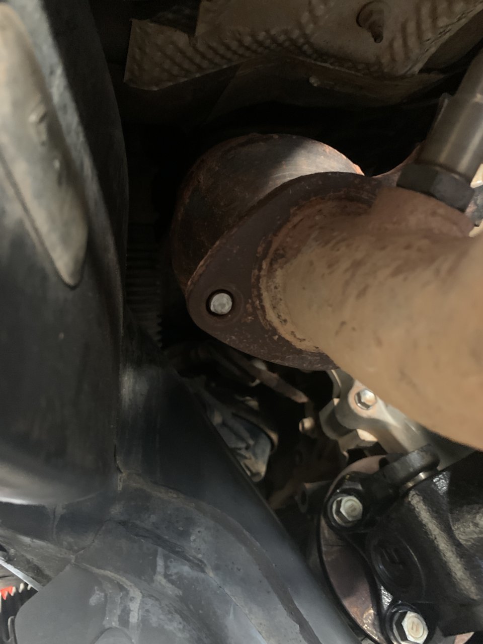

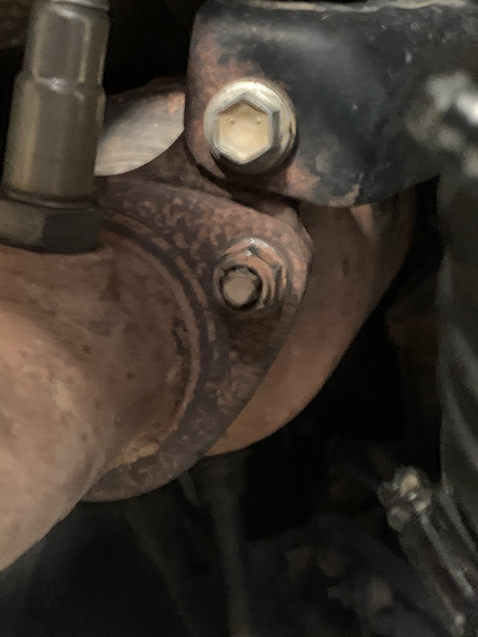

    So that's my excuse to go get the exhaust re-routed behind the transfer case. Mostly because I don't feel motivated enough to fuck with it. But why can't it ever be the first thing that you're working on that breaks? Now I've got to put everything back together.

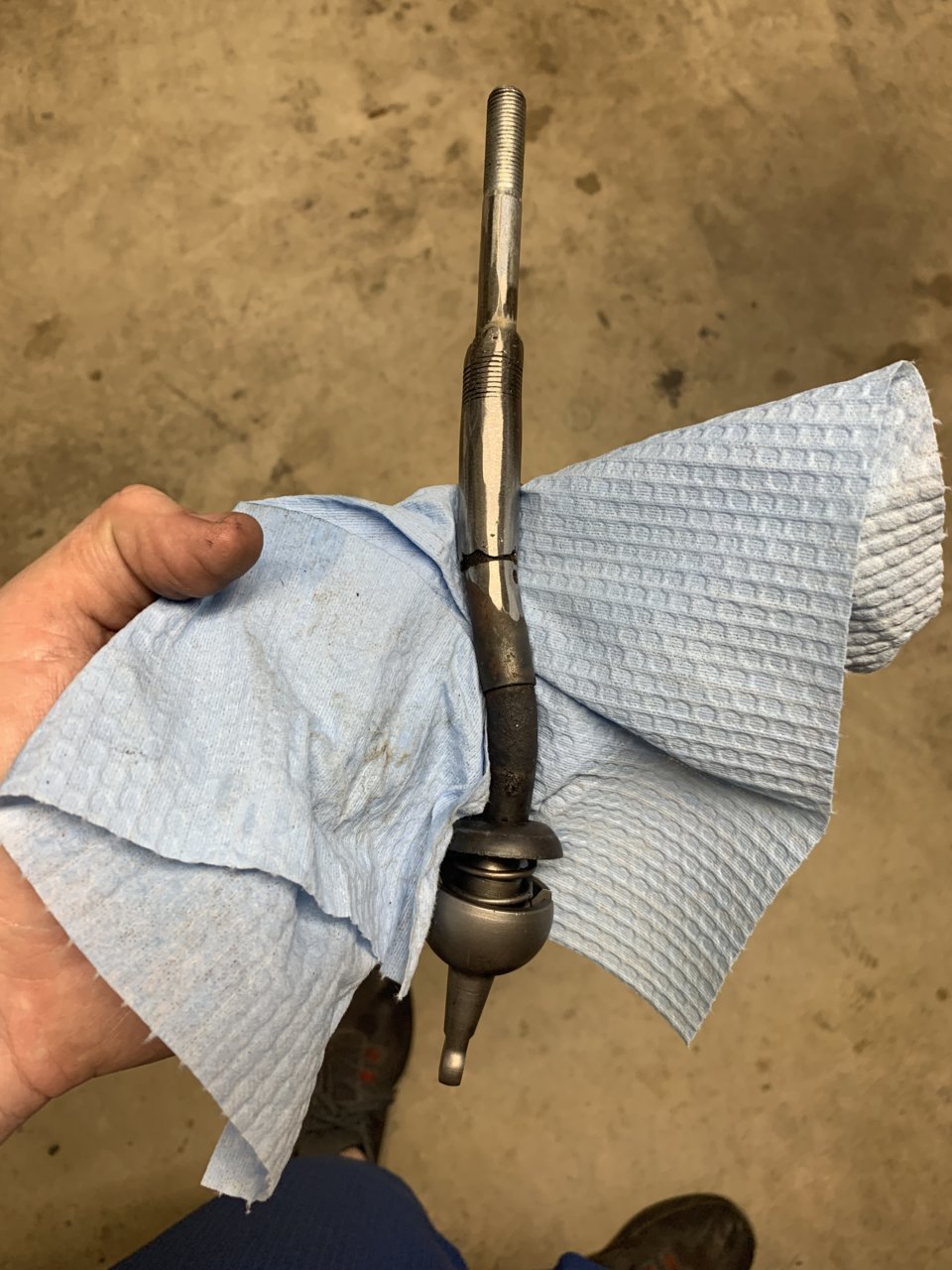

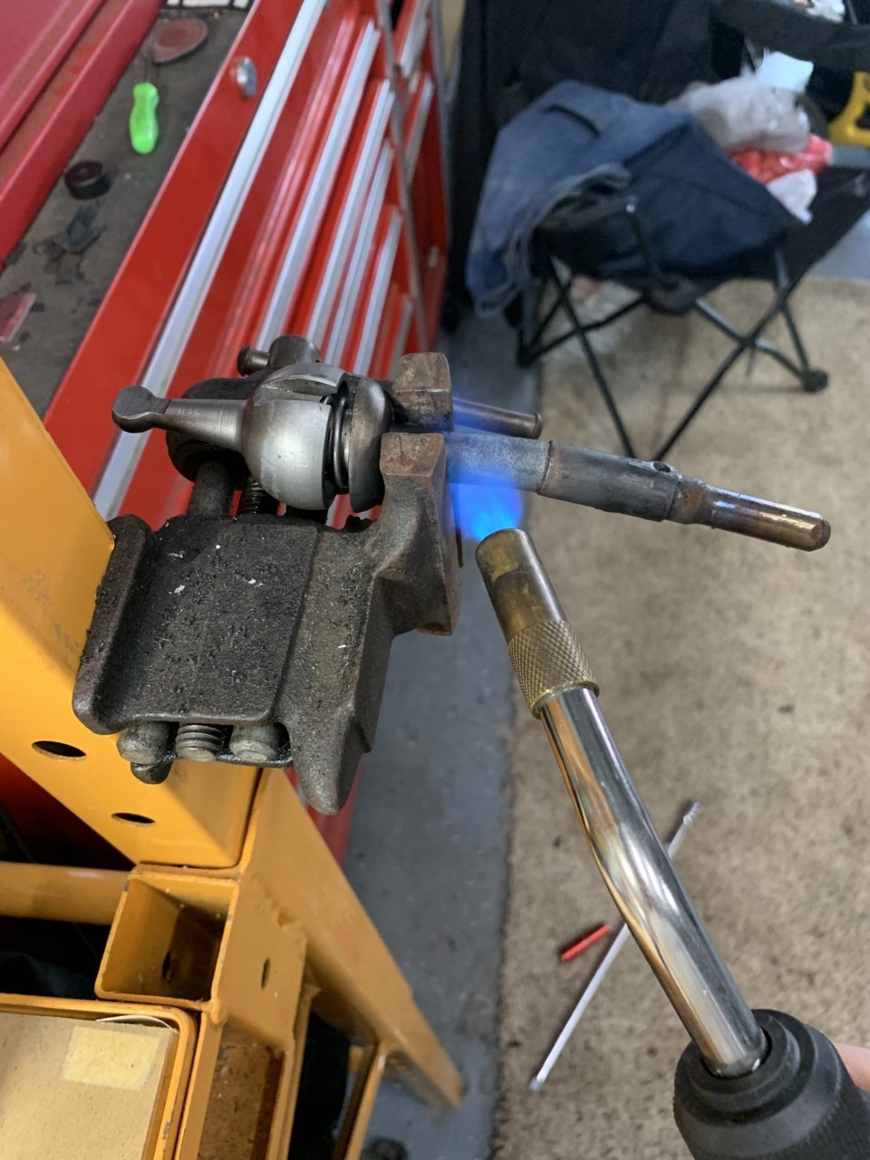

    Pull and twist hard on that fat boy from Marlin. There a skinny one inside that is a lot easier to work with. I welded a thin pipe nipple to it, cut it to length, then welded a threaded bolt. You could probably drill and pin it. Hell, you could probably JB weld it, it doesn't get a lot of force on it and it'll be covered by a bit anyway. All the bending I did on that stick was to the skinny stick and the bolt.
    Edit: here's some pics
    Looks like this
    That torch will work but it will take all your life but it's all I had available at the time in NC. Oxy/Acetylene will get it red hot in 1/10 the time.

    Ahh...I didn't realize that would come apart like that. That explains why yours looked like it was way down in opening in your initial test videos. Any chance you have pics of that? the radesigns ones should be simple. I just need to cut and weld an extension.

    Pics added to the other post.
    A deep well socket and extension will make short work of bending the shifters and the deep well won't put any pressure on the threads.
    I just heated and bent the RADesigns shifters.

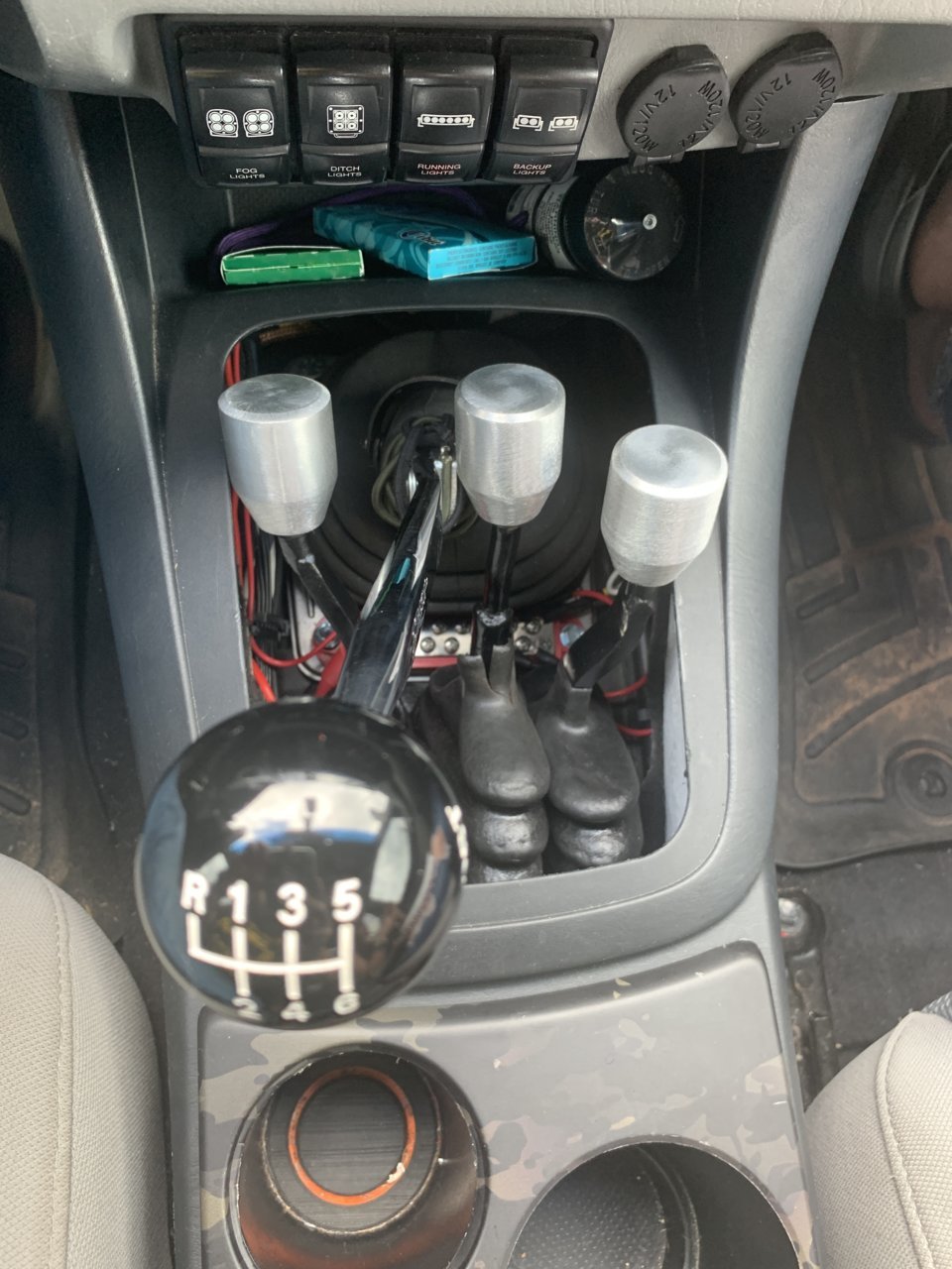

    You can kinda see them all here. I'll snap a better picture of all three when I pull the box or again.
    I also did not flip the Hurst shifter. I wanted to keep the trim around the shifter and wouldn't have been able to with it flipped. I just moved it as far towards the driver side as I could to clear the crawl box shifter.
