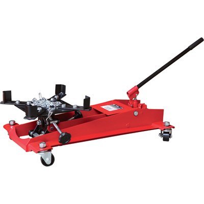

    Yeah there is just no way to balance that thing on there especially without the crawlbox attached, and it has to be spot on perfectly vertical and line up with the holes.
    I am seriously considering a 4 point adapter something like this for next time round:
    https://www.911motorsports.net/4-point-Jack-Adapter--for-Floor-and-Transmission-Jacks_p_34.html
  18. May 7, 2020 at 5:20 PM
    #3898
    hoverlover
    hoverlover [OP] Never pet a burning dog.
    Apr 4, 2016
    #183342
    10,838
    C-137, Laniakea, Virgo, Milky Way, Earth, USA, TX
    Things. Stuff. Lots of bad decisions.
    Mostly Zip-Ties
    That looks like it would work pretty good
    I had seen this one
    At Northern Tools but for a few bucks more yours looks like it'll work a lot better. Fingers crossed I don't have to do this again any time soon.
    Still no leaks
    Hopefully it stays that way
    :fingerscrossed::fingerscrossed:

    I looked at those too but I honestly dont know how much better it would be than the HF trans jack. It's a wider platform with arms, but unless the arms adjust height or you can tilt that platform 45 degrees you're still on a flat surface. Would love to see one with a tcase on it angled to install.
