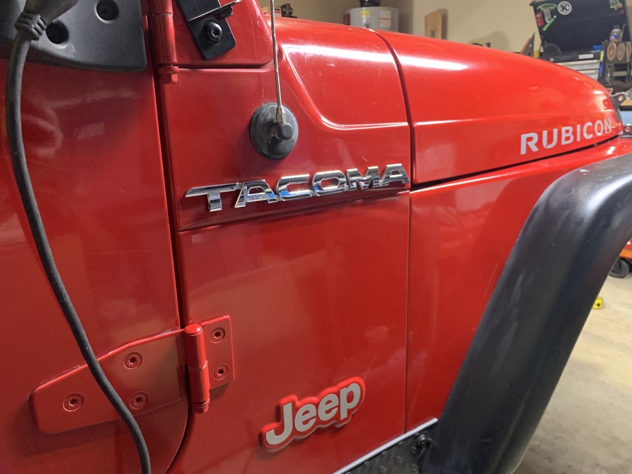

    I knew it! It's a Prius with Jeep fenders!

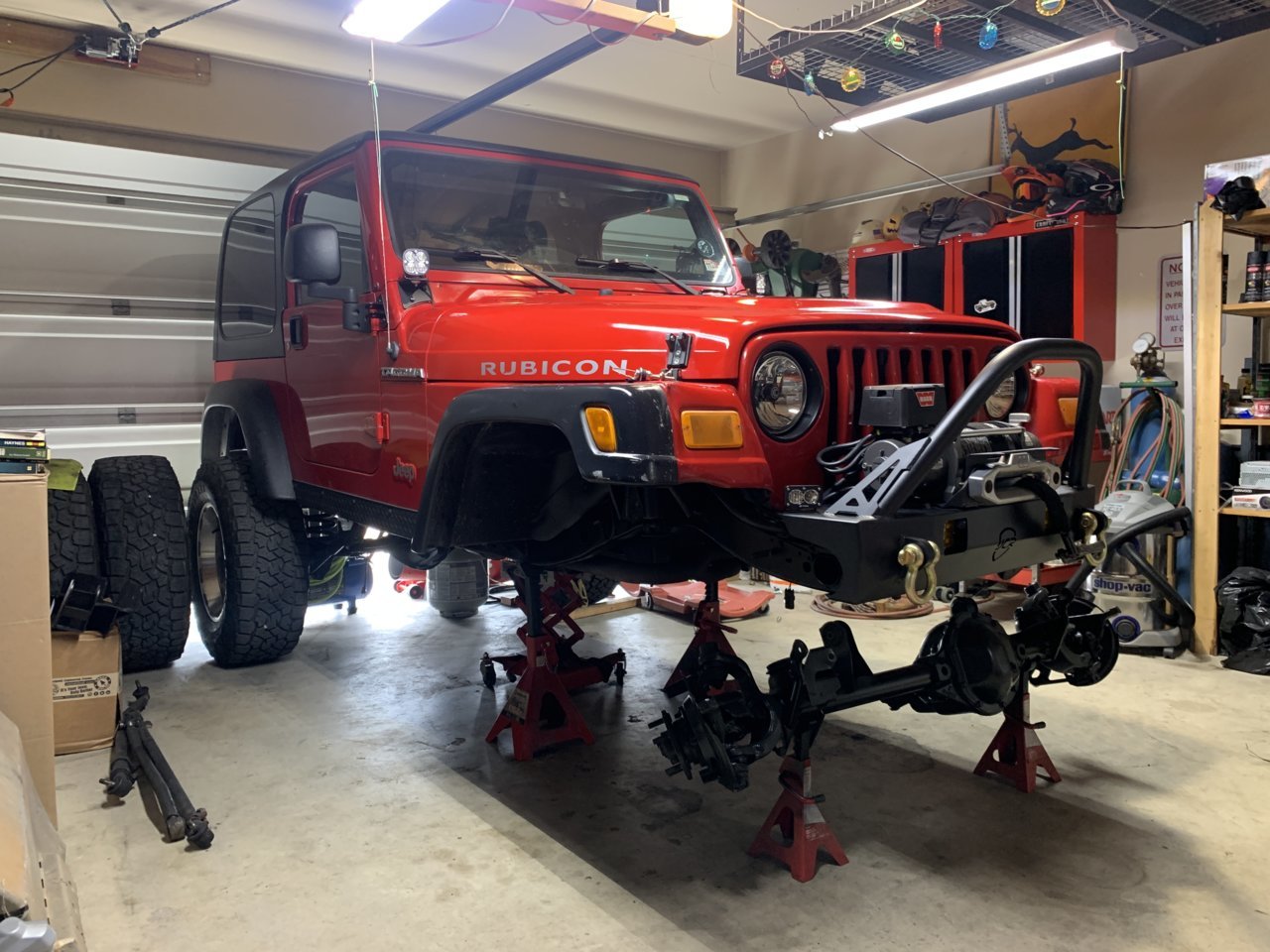

    Now that the cat's out of the bag, I can dump pics

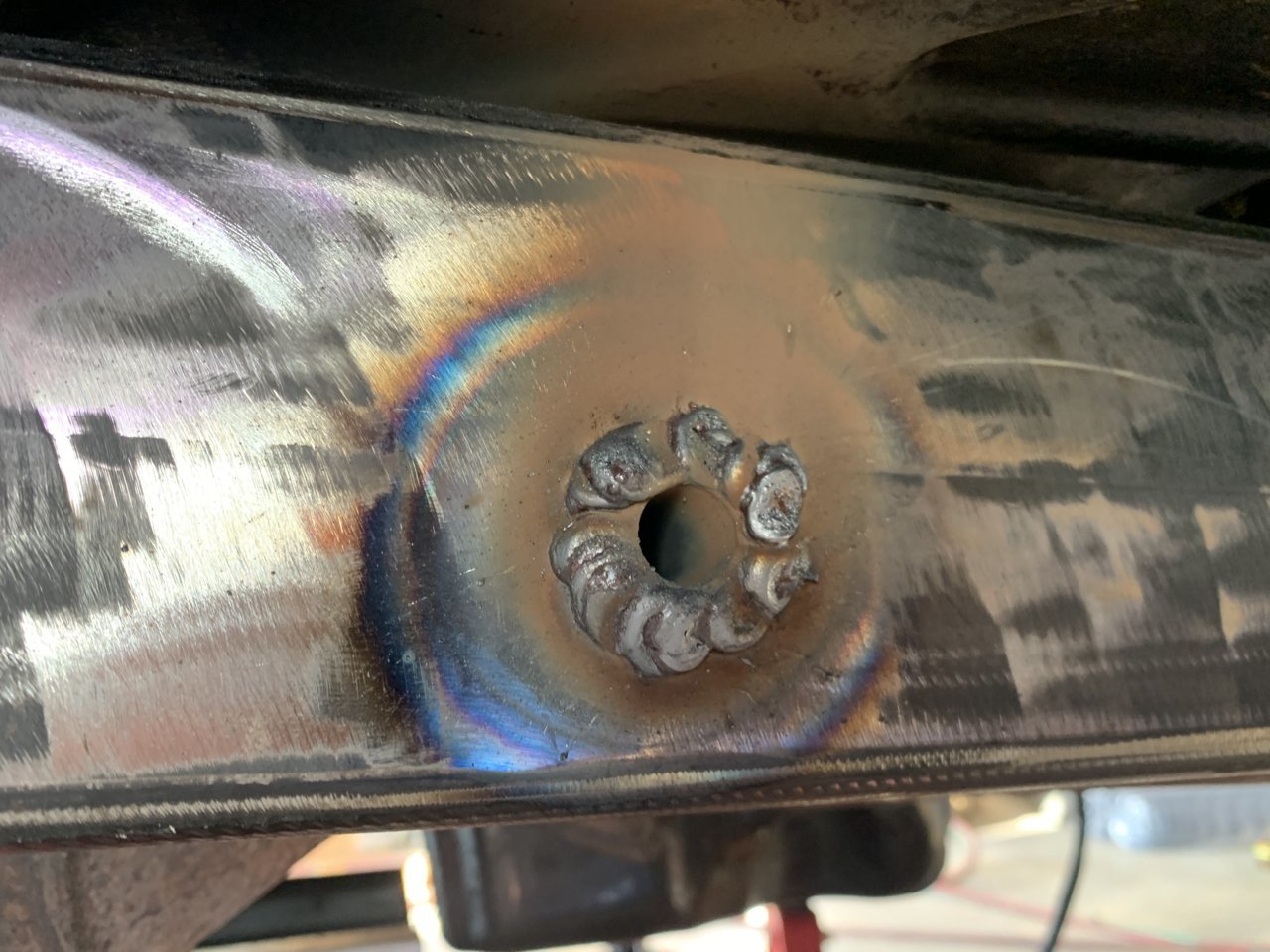

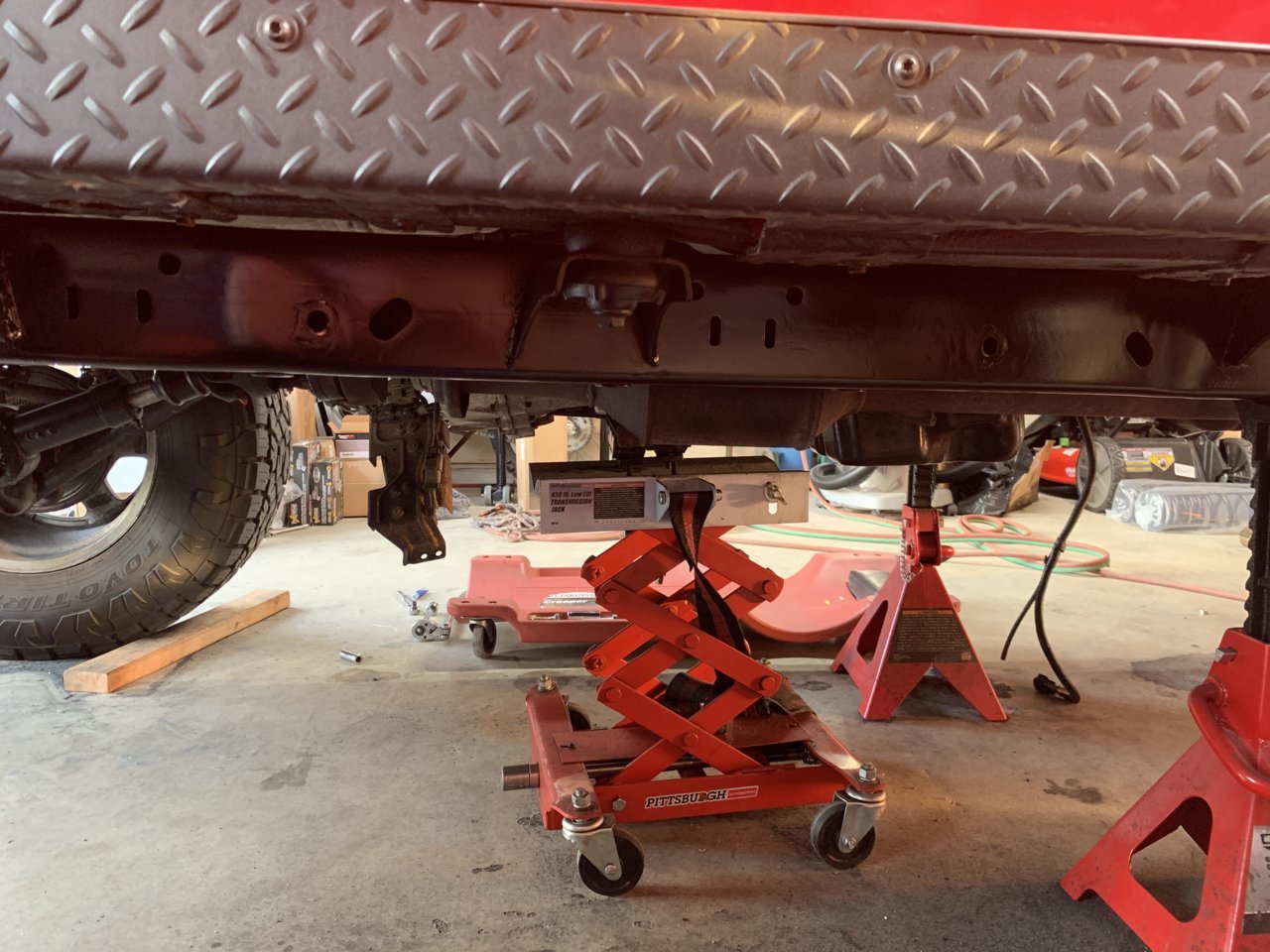

    Here's what I'm working on today
    I drilled more holed in the frame for a couple more sleeves to go in.

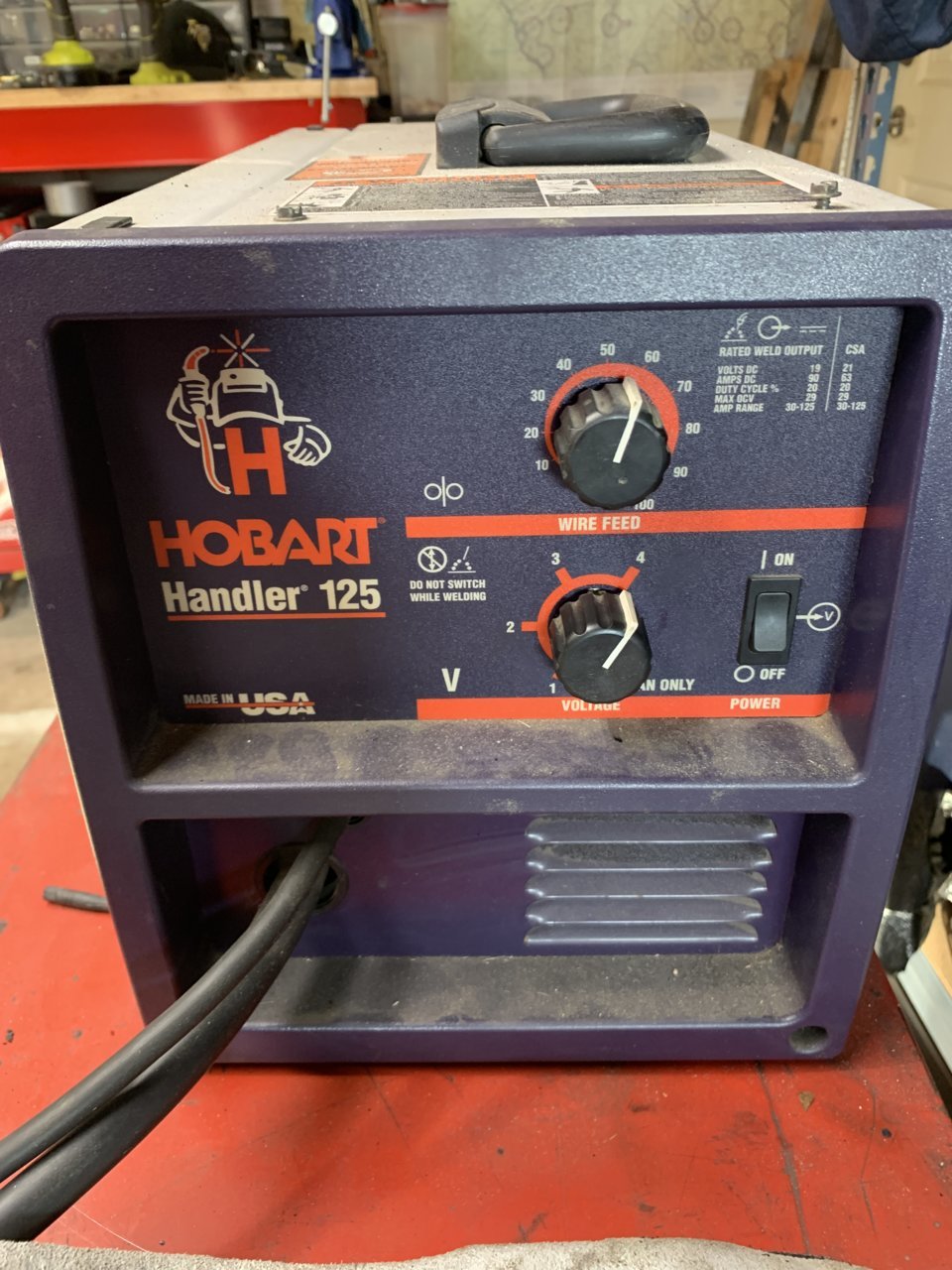

    My welder is rated for 3/16 but I've been able to do 1/4" by going real slow and creeping the puddle where I need it. The sleeves and frame are 5/16", the welder is struggling to penetrate. I've resorted to pre-heating the sleeve and the frame to red-hot and then attacking as much as I can before 1) I pop my shitty circuit breaker and 2) the metal cools too much to work. It's slow going.
    The welds aren't pretty but I did them myself in my garage with my tiny welder
    They're getting ground flat anyway to fit the new center skid and control arm mounts

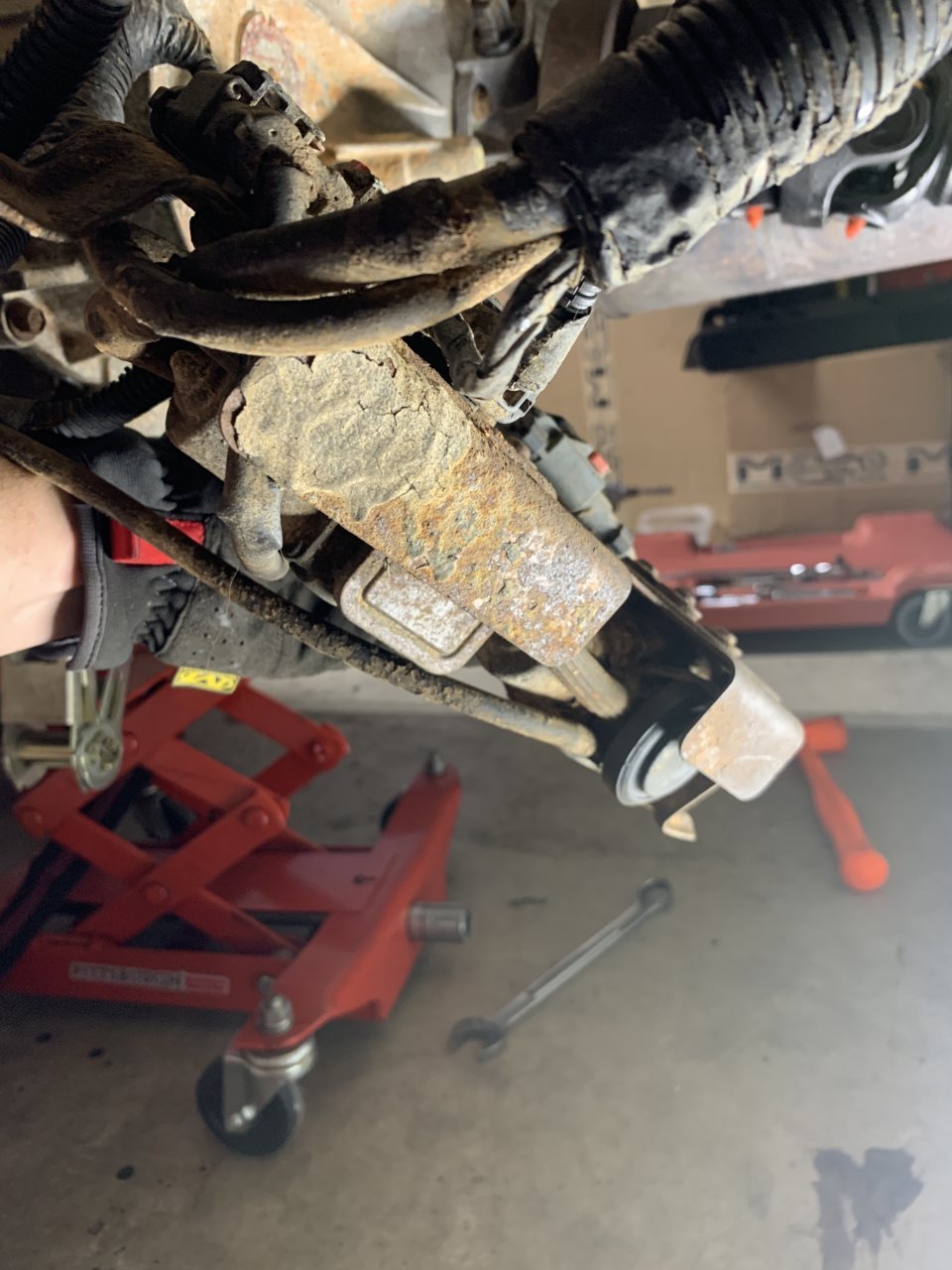

    Before - nasty and rusted underneath
    After - Like new

    Where's the rust?

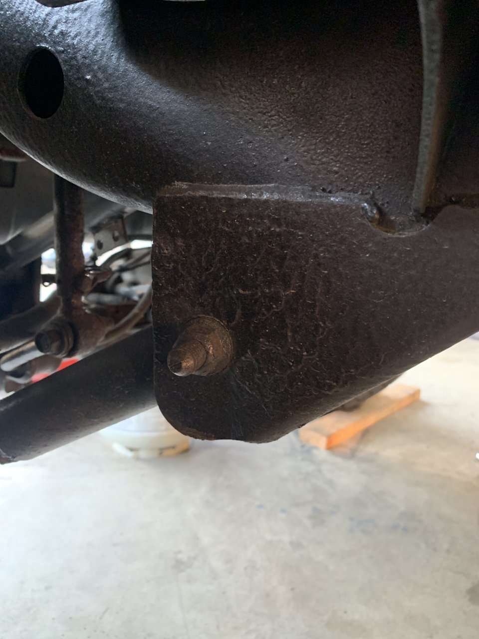

    Pretty much on everything from the tub down
    See how the paint looks lumpy? And the bolt is all rusted? Underneath that rubber under coat it all looks like this
    They covered up the issue, which doesn't stop rust so I'm fixing it by grinding it all the way down to the steel and repainting it, completely eliminating the rust altogether.

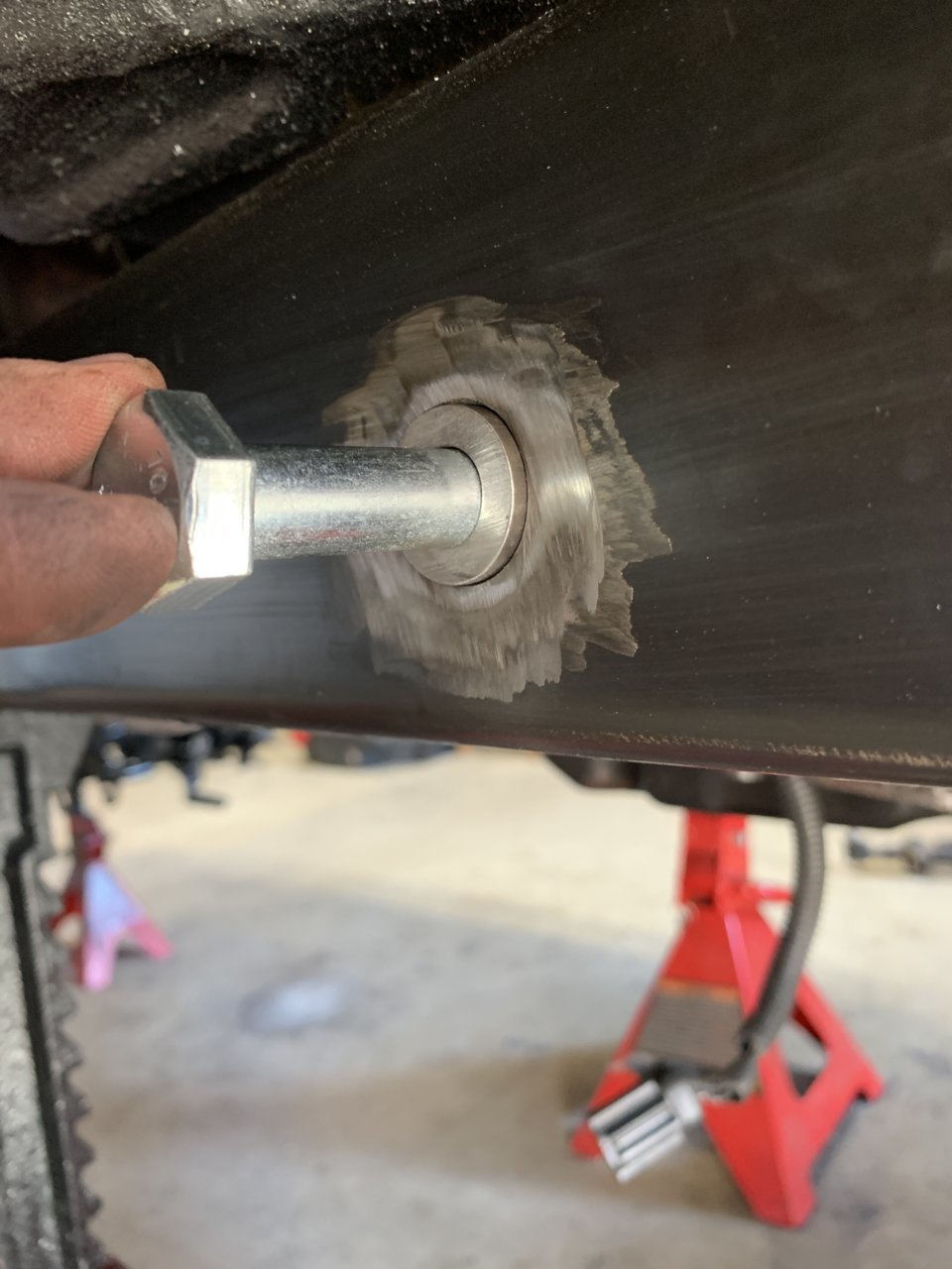

    I need a bigger welder.
    Once the sleeves are in place, I need to use the sleeve as a guide and drill a 9/16" hole through the back side of the frame. The problem I'm having is the drill bit seems to be grabbing about 3/32" of the sleeve. Over the length of the sleeve, the drill bit produces enough torque on the sleeve to spin it, breaking the shitty weld.
