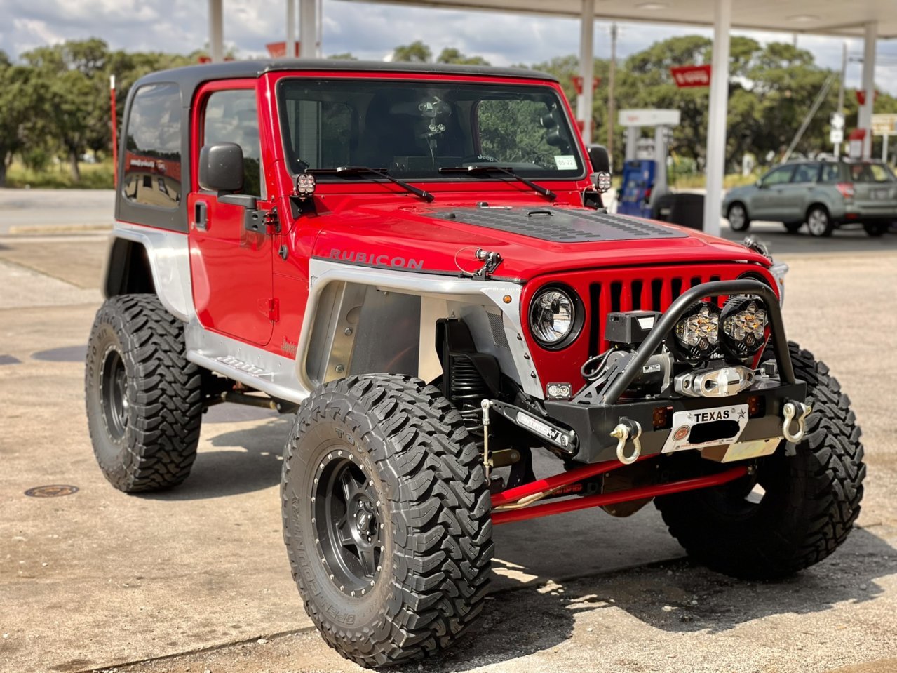

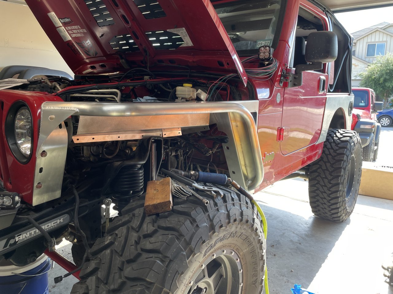

    Big day tomorrow, I've got some high clearance fenders coming in. I'll be cutting almost 4" out of my hood so the suspension can cycle without the up-travel limit created by the hood and front fenders.
    It's going from this - these are my current fenders with 37's
    To this - these are high clearance fenders pictured with 40's so I'll have a few inches to spare.
    I'm also going to have the same aluminum inner fender which I think looks pretty snazzy and keeps everything out of the engine compartment. Ignore the fact that I cut giant holes in the hood. They'll keep mud out and increase flow across the radiator.
    If you look at the lines on the hood you can see how much higher the fenders will sit. The goal is a very low stance with a lot of ground clearance and flexibility. Low center of gravity, ample of travel: that's the goal. I'll eventually get some 16"-travel King dual rate coilovers under her similar to this
    (Same fenders! Purrrty)

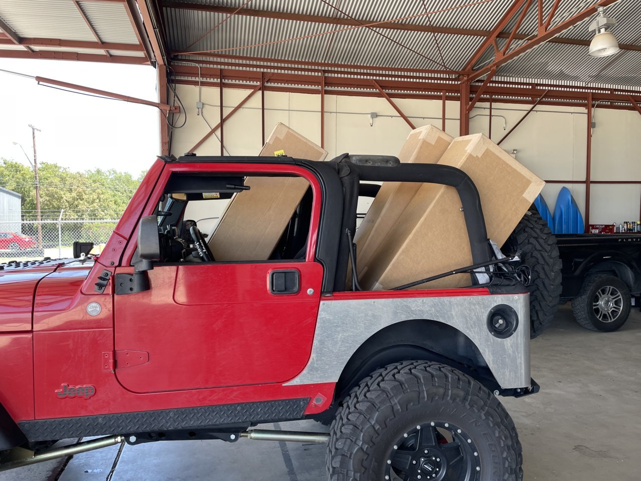

    Well, got nothing done today. FedEx sucks. 4 boxes got shipped together, one arrived, three got lost. This happens every single time I have a FedEx delivery. Maybe tomorrow, not holding my breath.

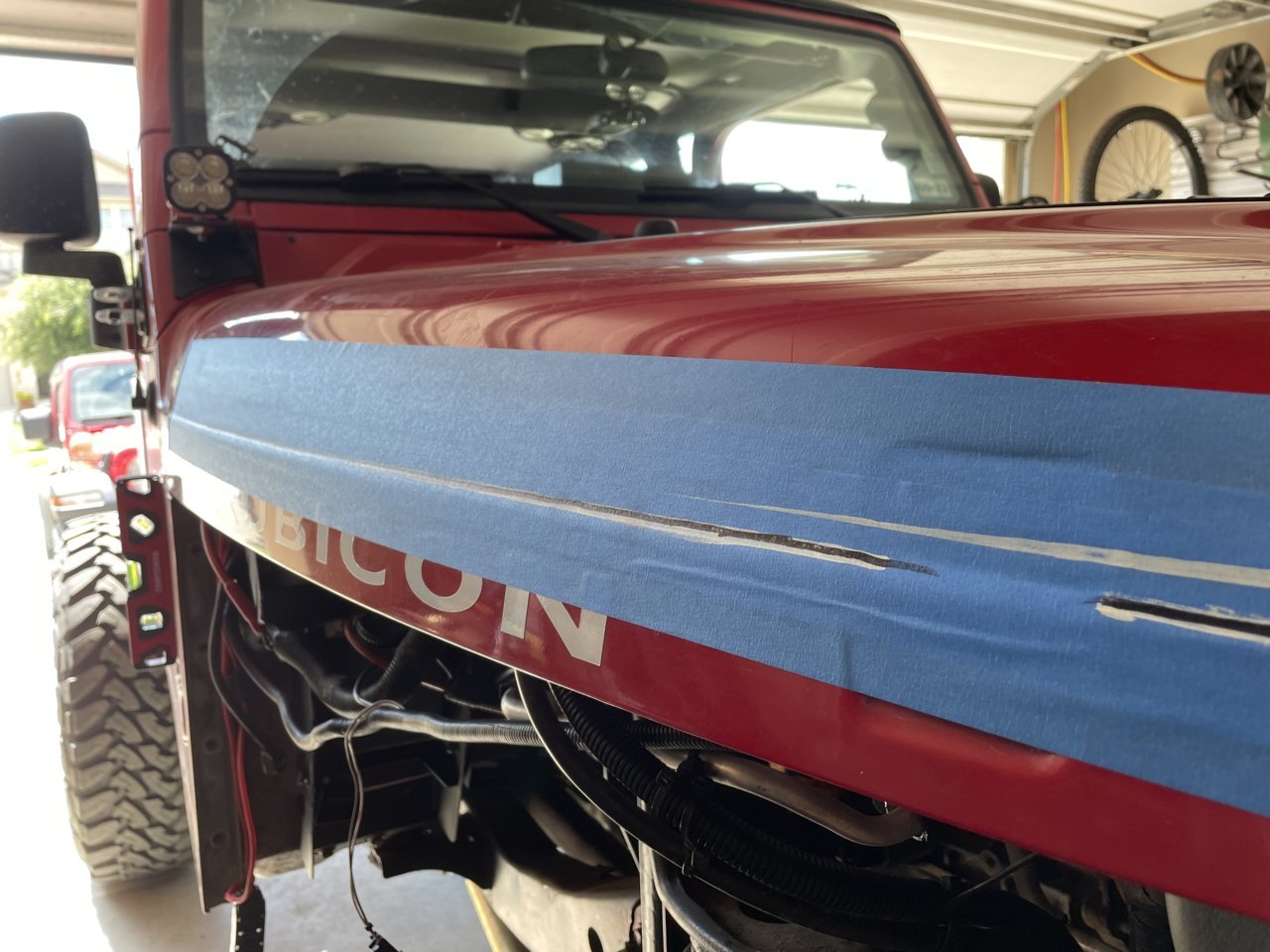

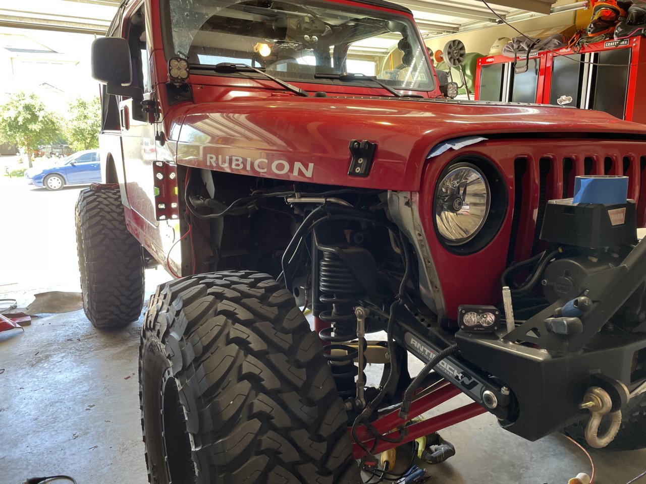

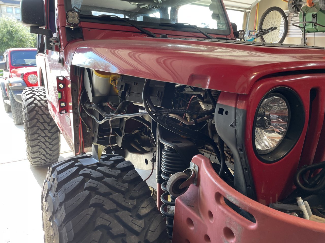

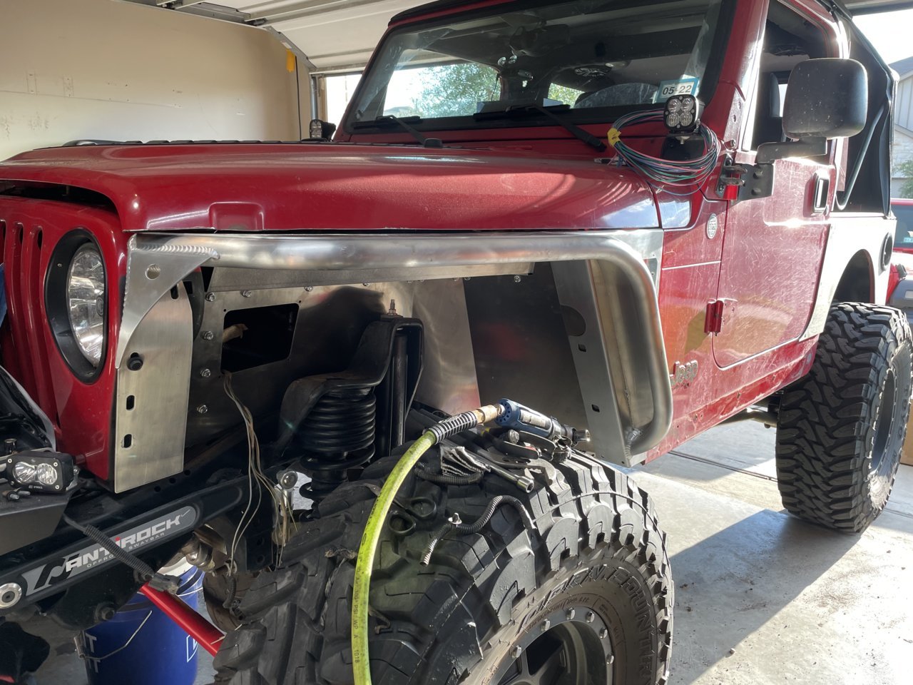

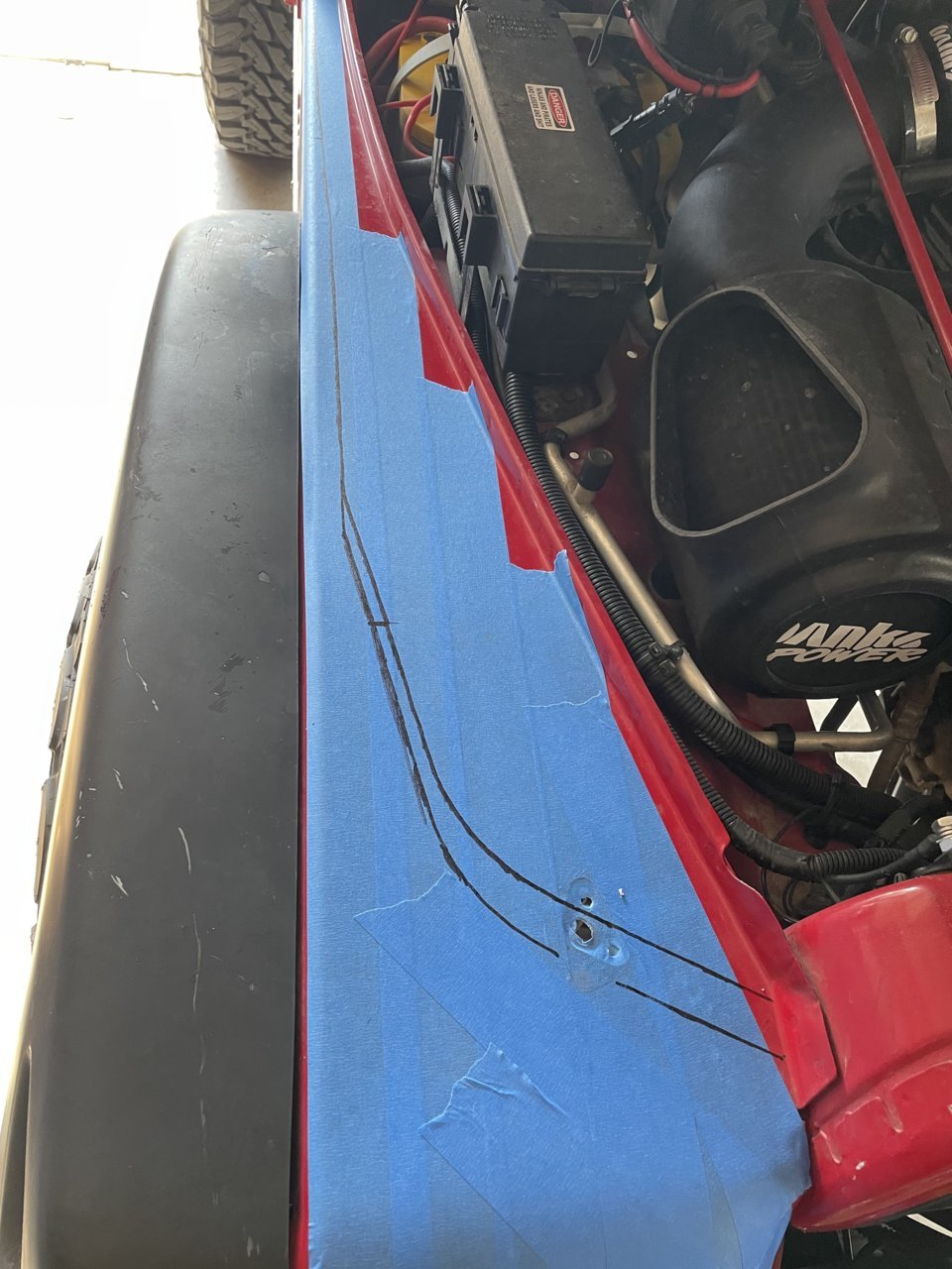

    Had a few setbacks at home but I still managed to get some work done today and I am loving it!
    I was so tempted to just put in the fender liners and leave it like this. The pics might not look great but it looked pretty cool with no front fenders at all. Anyway, here's the old hood line.
    Stenciled
    Cut
    New fender, working on the liner
    Fender and liner getting lined up with the tub. I need to cut a bit more out of the hood. I'm a little annoyed with that because I measured 50 times and then made one super clean cut on both sides. Of well, I'd rather have too much than not enough.
    Can't wait to get finished up!
    The driver's side is about 85% done. I've just got to finish the hood, attach the latch, wire the blinkers and fog light, and figure out what I'm going to do with the window washer fluid bottle.
    More to come

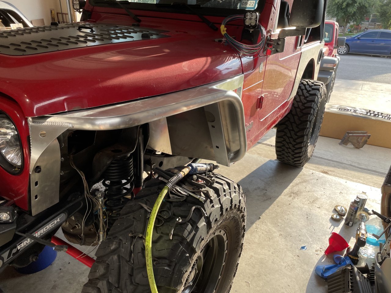

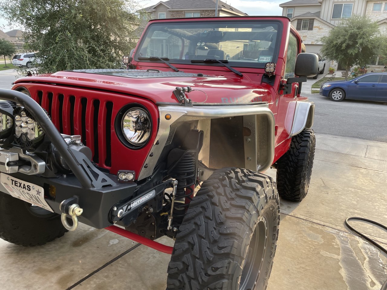

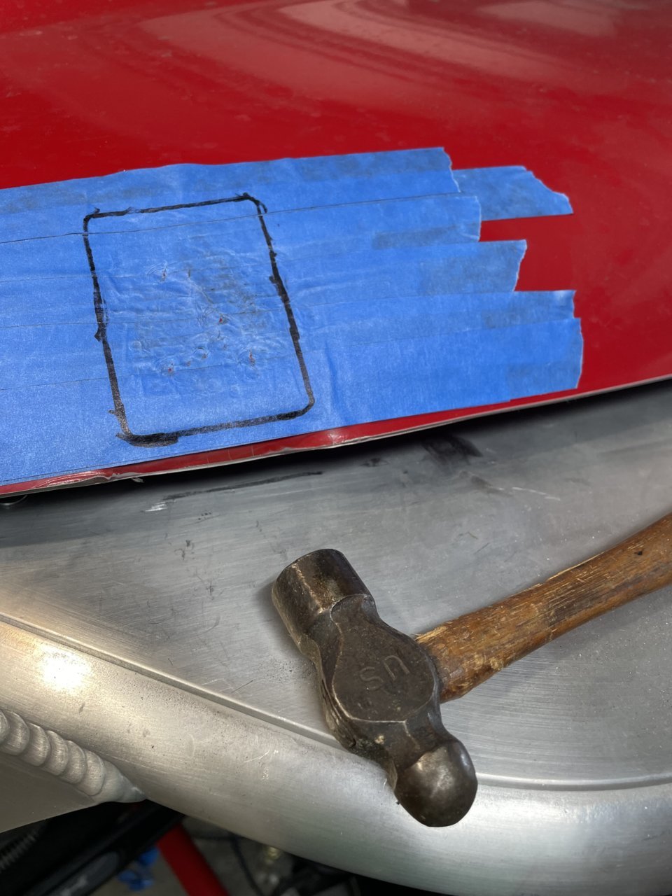

    (*clears throat, channels Hank Hill*)
    Boyh I tellhu hwut.
    Cutting fenders: cake walk.
    Cutting hood: not a drop of sweat.
    INTENTIONALLY DENTING HOOD FOR LATCHES: .... Traumatizing.

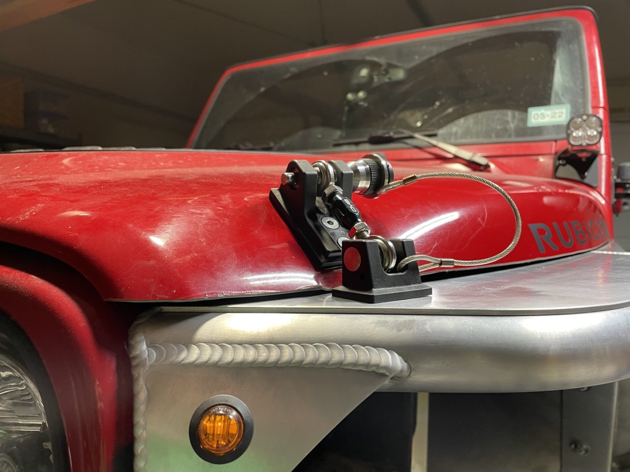

    What the picture doesn't do justice of is showing the rounded edge of the hood I had to hammer flat with (my great grandfather's) ball peen hammer. The latches require an elongated flat area to bolt down to the hood but when I cut 3" out the flat spots went with it. So I had to get creative.
    Overall, not too shabby, I say.
    The front fenders are done. The fender liners are in, the battery has been relocated, the AC lines bent to a new route, the computer, cruise control, horn, blinkers... It'll be shorter to tell you what wasn't moved: the engine is where it was originally. I moved just about everything else. Took about 20 hours but it's done and I love the result. I'll get pictures when I get the rear done. I'm still self-quarantined with my covid-positive wife so I may get a start on it tomorrow.

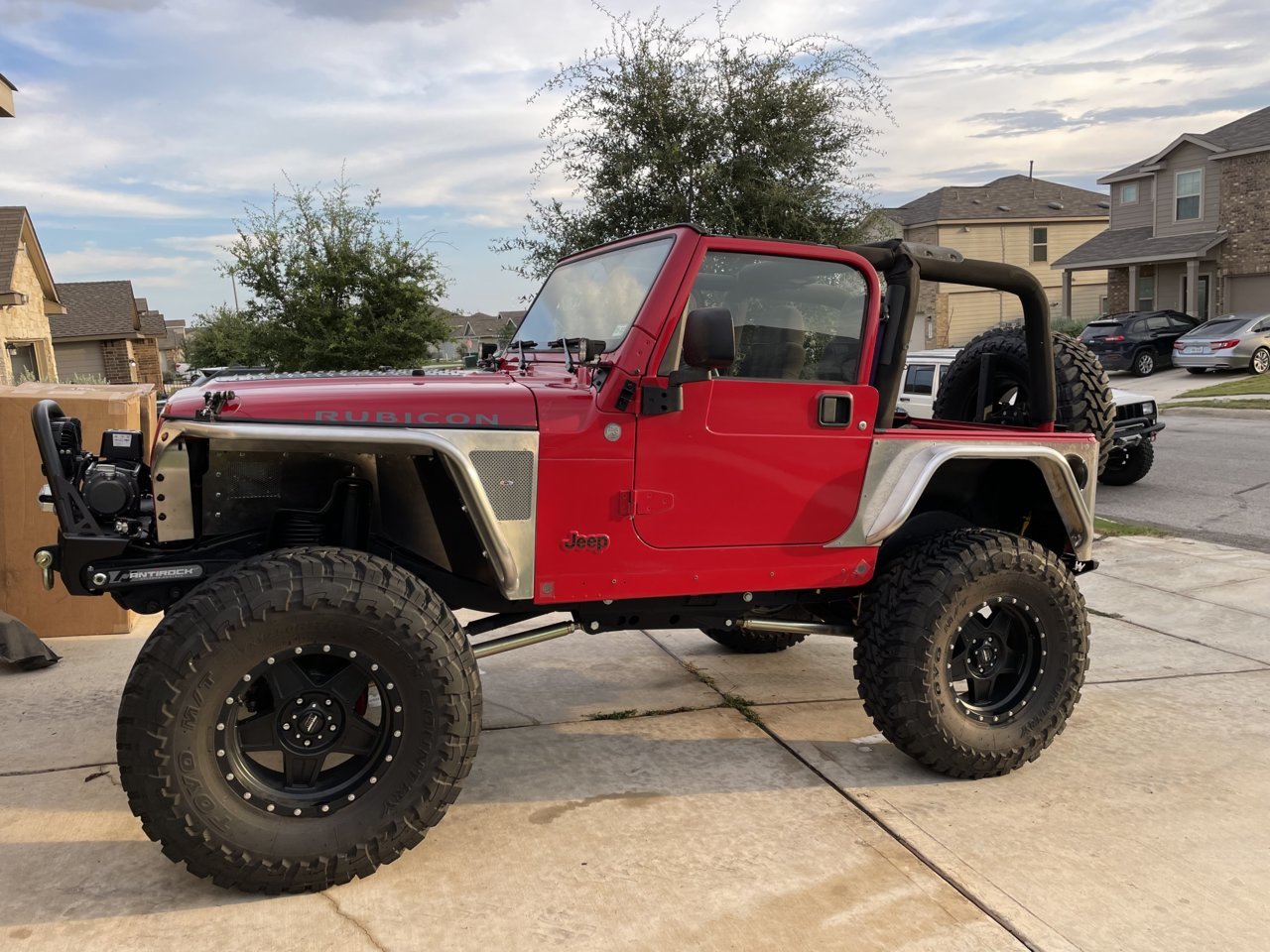

    Before
    After
    Sliders should ship soon enough.

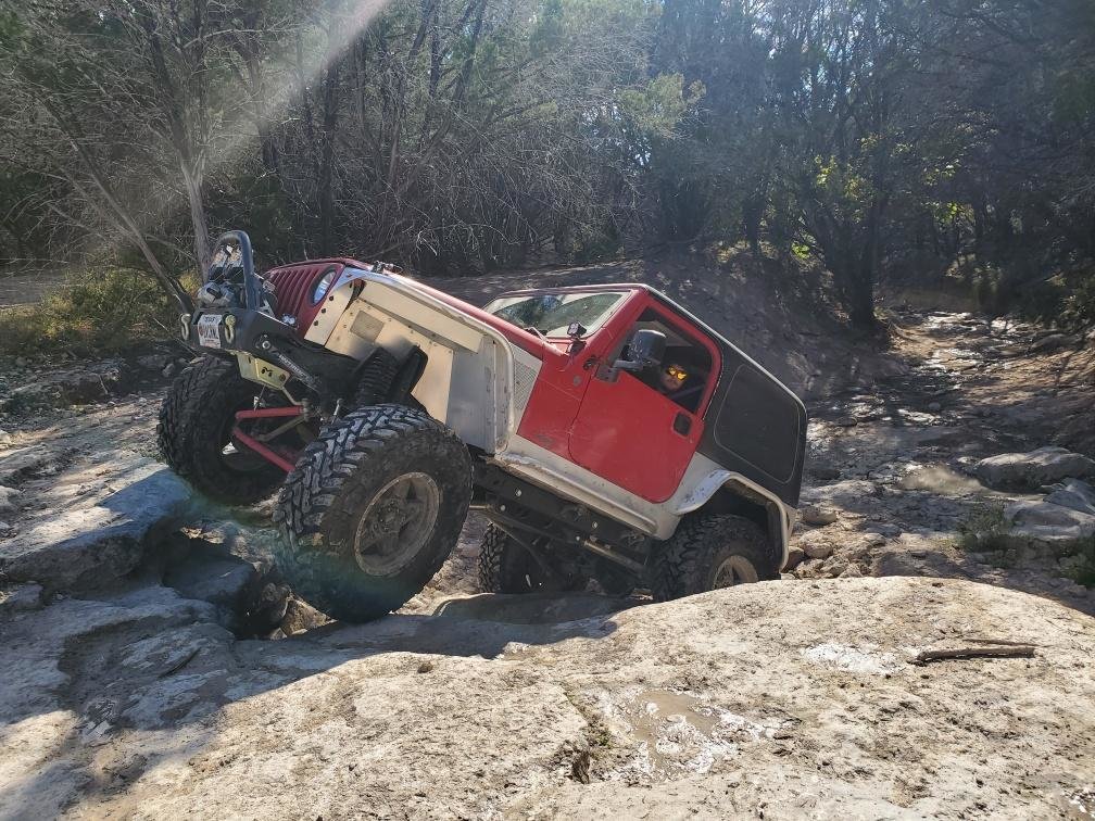

    I had bought a soft top and the hardest for it last December and finally got around to installing it. I'm pretty certain the top was for the 97-03's because it just did not fit right. I know when you get them they're small and take a few weeks to stretch out proper but I was popping seams and it leaked when it rains because of it. I ended up selling it all but I should have kept the frame. I paid $220 for everything and now I can't find a frame in decent condition for less than $500 :frusty:. So the hard top is back on it for now. I don't mind, it's quiet and the AC is much more effective but I loved having the top down when I could.

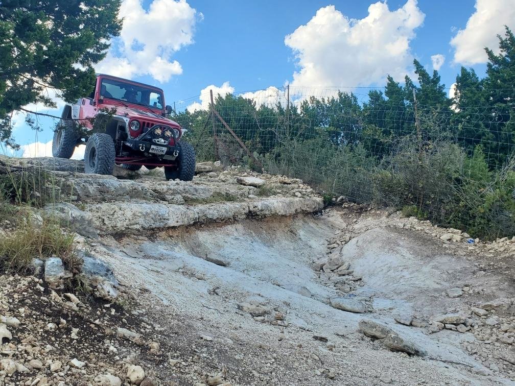

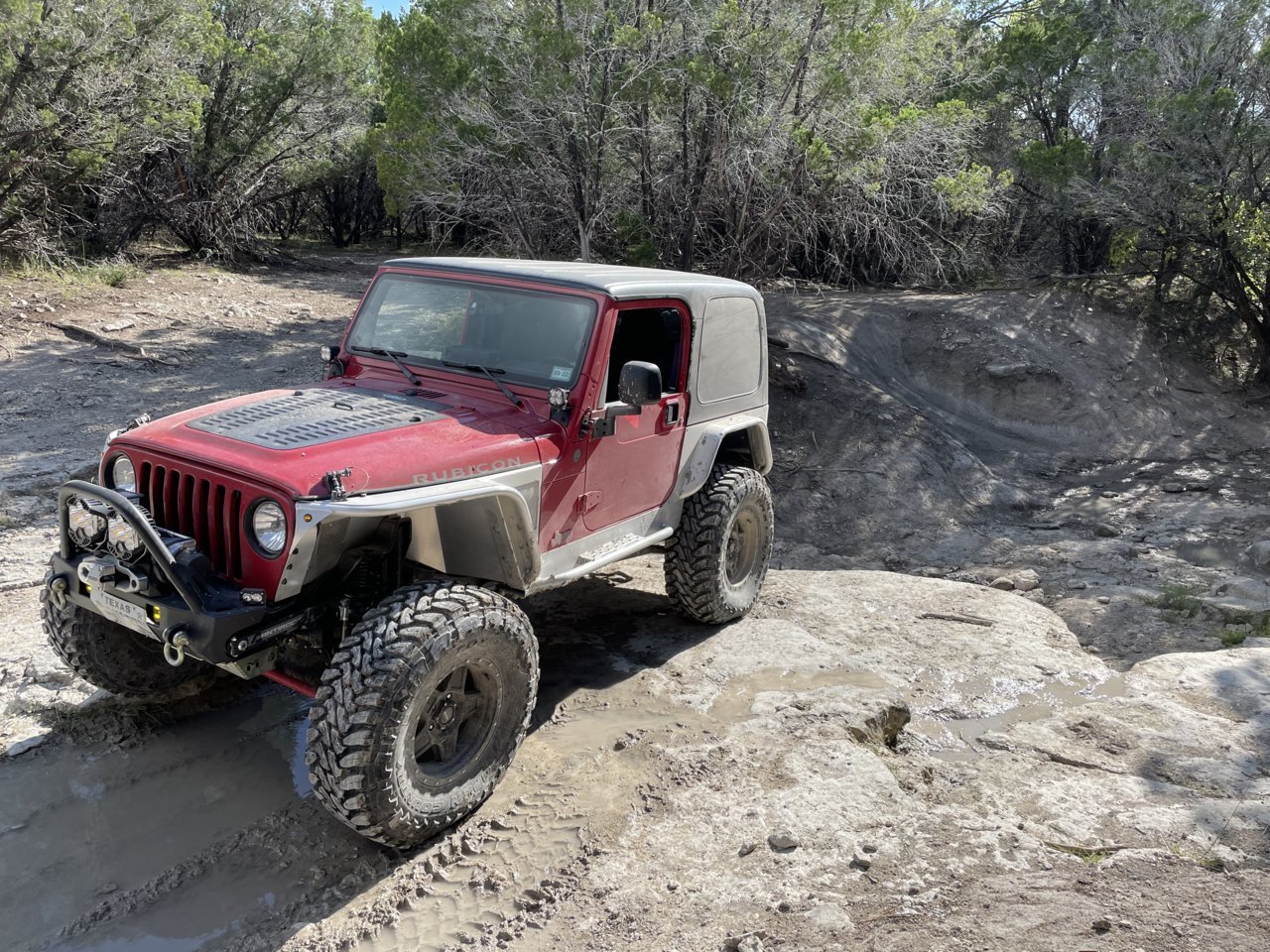

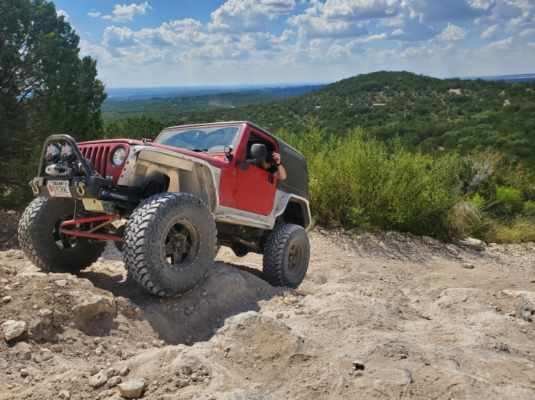

    I took it out to HF for my birthday this past weekend and was having a great time running 4's and a few 5's. I didn't get too crazy because I was in my own and my wife isn't the best spotter but we had a good time nonetheless. The Jeep did great! Drove there, ran every trail I pointed it at, and drive back home without issue. Can't ask for more! I do need to replace the pump for the front locker, though. I broke the plastic nipple when I replaced all the air lines and did my best to repair it but it's leaking and can't build sufficient pressure to engage the front locker. That would have made a few things I did a lot easier. I wanted to try the harder lines on a few things and just couldn't get the front to hook up when I needed it to and ended up taking an easier line because of it. But I never had to use a bypass! I didn't get many pics but here's a few the wife took
    Those two guys stopped to watch but weren't interested in running more challenging trails
    She got video of this one, I'll post it up later because it was super smooth!
    I wish I had video coming up this one. The waterfall was higher than the hood and had been torn up pretty good, but I found a way up it :D
    I literally just now realized I have a GoPro and should have taken it! Guess I gotta go back!
