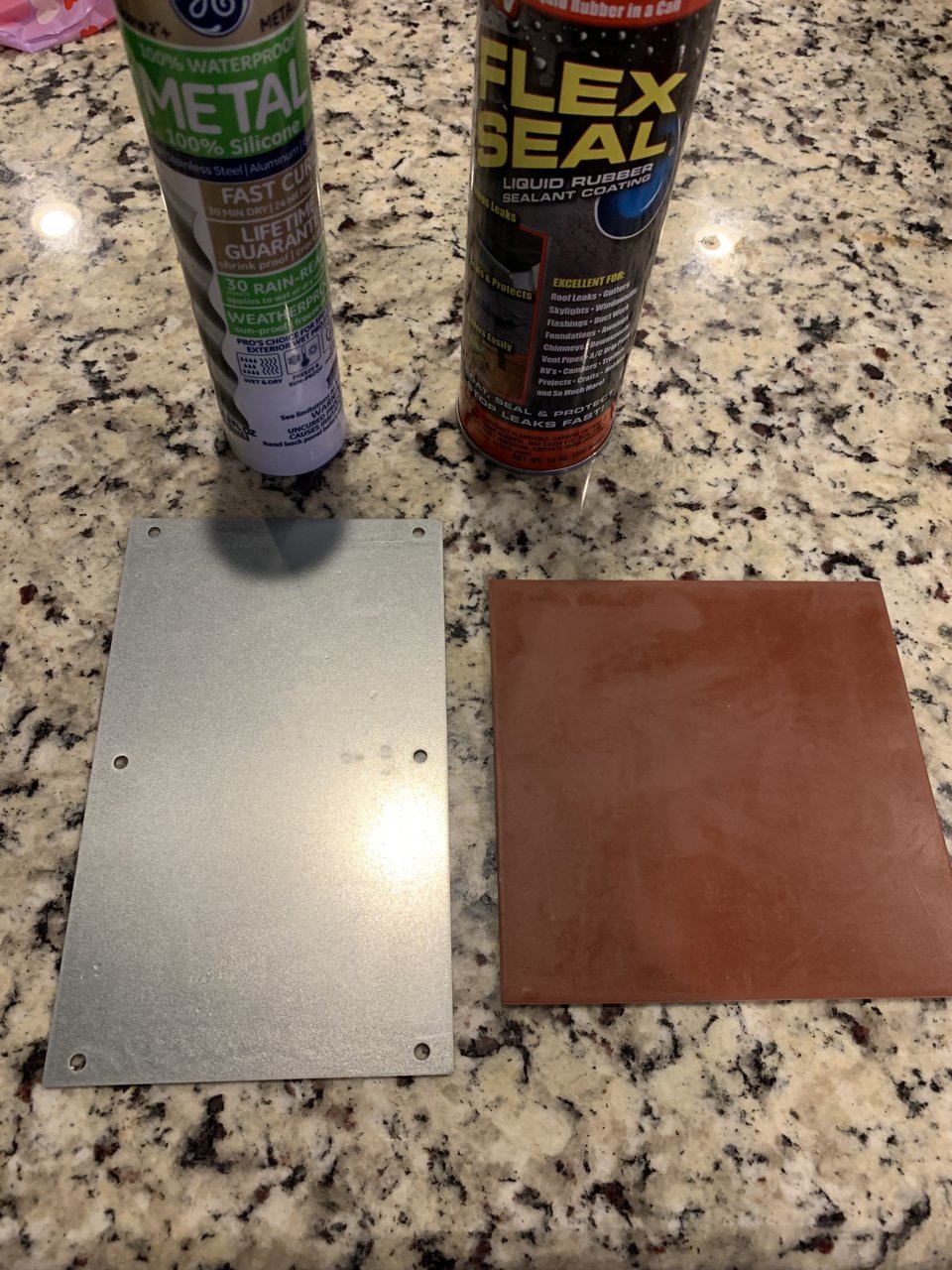

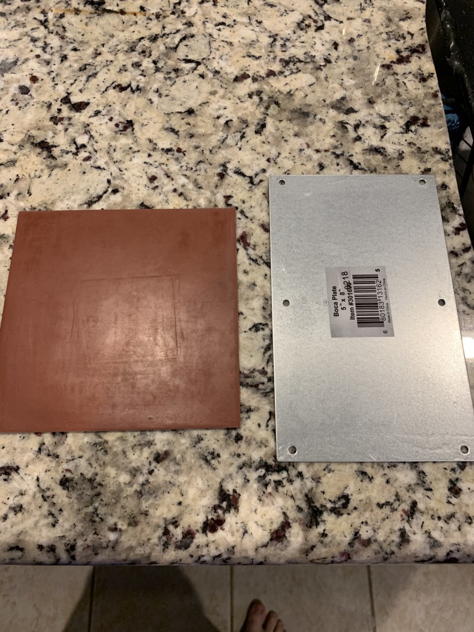

    I found some 1/16th steel at Lowe's in the plumbing isle. I got two of them and a 1/16th 6x6 rubber. I'm going to use a 4" hole saw, metal/metal sealant, and a few bolts to basically sandwich the shift boot to and between the tub. I'm thinking the bottom will be permanently sealed and resistant to the elements but the top will be removable to access the boot and the top of the case. I'll put some pics up in a few for a visual.

    @Bigdaddy4760
    @BassAckwards
    What do you guys think about this?
    From left to right, bottom of the truck to the shift knob.
    Transfer case, shift boot, plate, rubber gasket trimmed to fit, silicone and metal/metal sealant between, body tub.
    I'll add the metal/metal sealant between the plate and the tub and then give it a layer of flex seal from the bottom. Hey, it actually works pretty damn good.
    I believe a 4" hole saw in just the right place should be sufficient for the tcase shifter and it'll give me a half inch on either side of the plate to effectively seal it up.
    I'll have to play with the boot some to see exactly how and where I want to fit it. That's subject to change for now.
    Then it'll be silicone sealant between the rubber seal (trimmed to fit) and the body tub, and around the boot from above. Then rubber boot and then top plate. I might do a strip of silicone sealant between the top plate and the tub as well for extra measure. I'd like to tack weld some bolts into the existing holes in the bottom plate and then punch a few extra holes in the tub so I can bolt the top plate to the bottom plate from above, pinching everything firmly between.
    BassAckwards likes this.

    looks like it will work great.

    Yeah that's been tricky. Trying to play it all out in my head going off of other people's installs.
