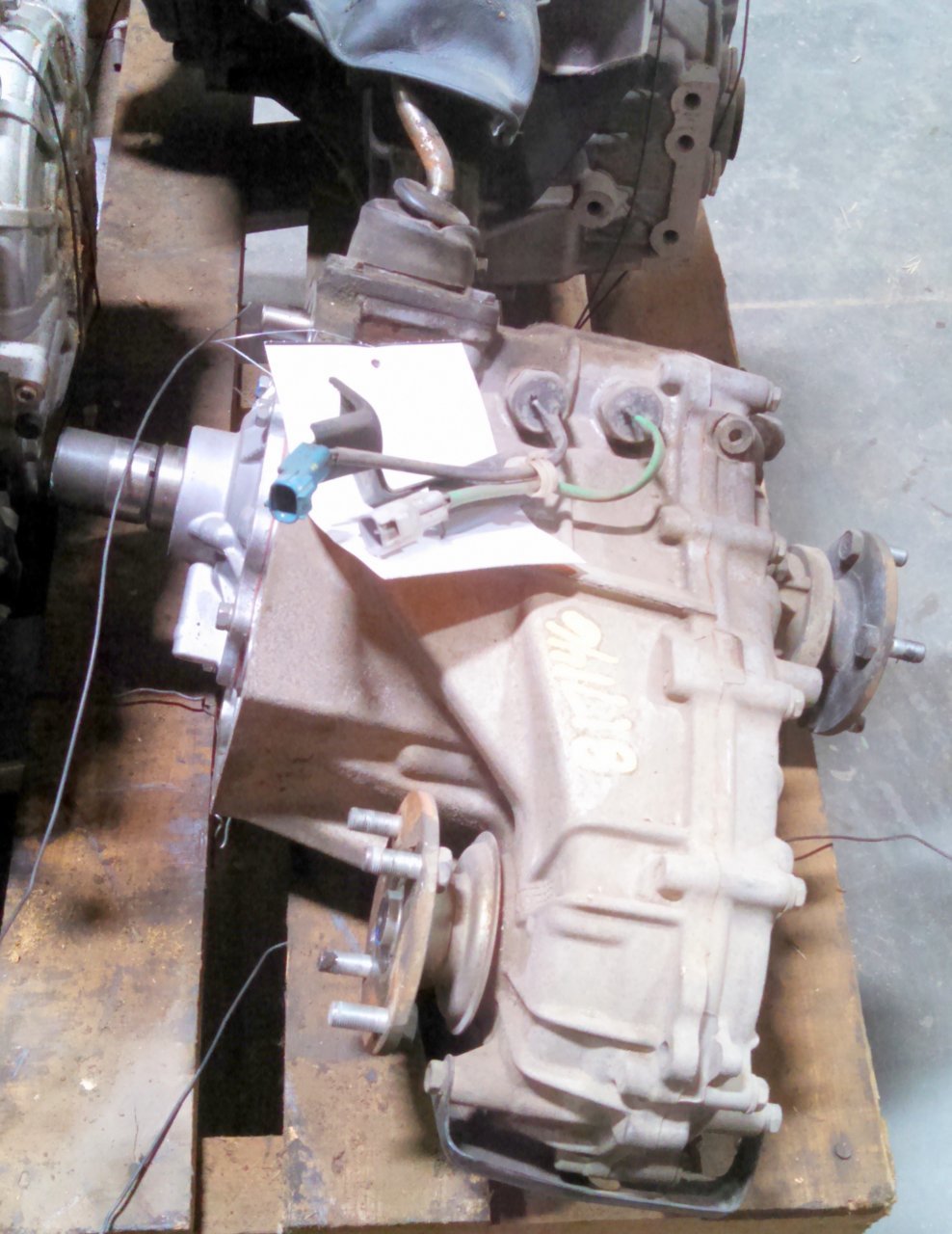

    Well, just going off of the pics they sent of the case I'm getting
    It looks like they're sending everything from the case up to the shift knob so unless they cut any other boot off it looks like that's all it comes with. On the boot itself, it looks like there is a ring bitched around the base of the boot. I'm assuming that's where it comes through the body to the interior.
    I dunno, it's hard to say.

    Alex, found out that the A/T FJ t-case shifter has a boot and they are readily available. It is smaller and separate, but i think i can make it work. part number 58280-35330.
    Here is a shitty pic, but you can kinda see it.

    Well if you plan to add the FJ tube and do away with the ADD altogether you'll need the twin sticks to make use of 2Lo. If you keep the ADD you can have 2lo with a single stick but you'll have to wire up a switch to engage/disengage the ADD for 4wd.
    If you're going to do it, may as well do it while it's out. Do it once do it right, ya know? For your truck, I'd keep the ADD, wire the switch, and go single stick for sexy interior cleanliness.
    To install twin sticks you'll have to modify the arms inside the case. It's not hard, you're just removing some extra material so one control arm can slide past the other. Shouldn't take more than an hour or so to split the case, install the input shaft, remove the extra material, install the twins, and put everything back together.
