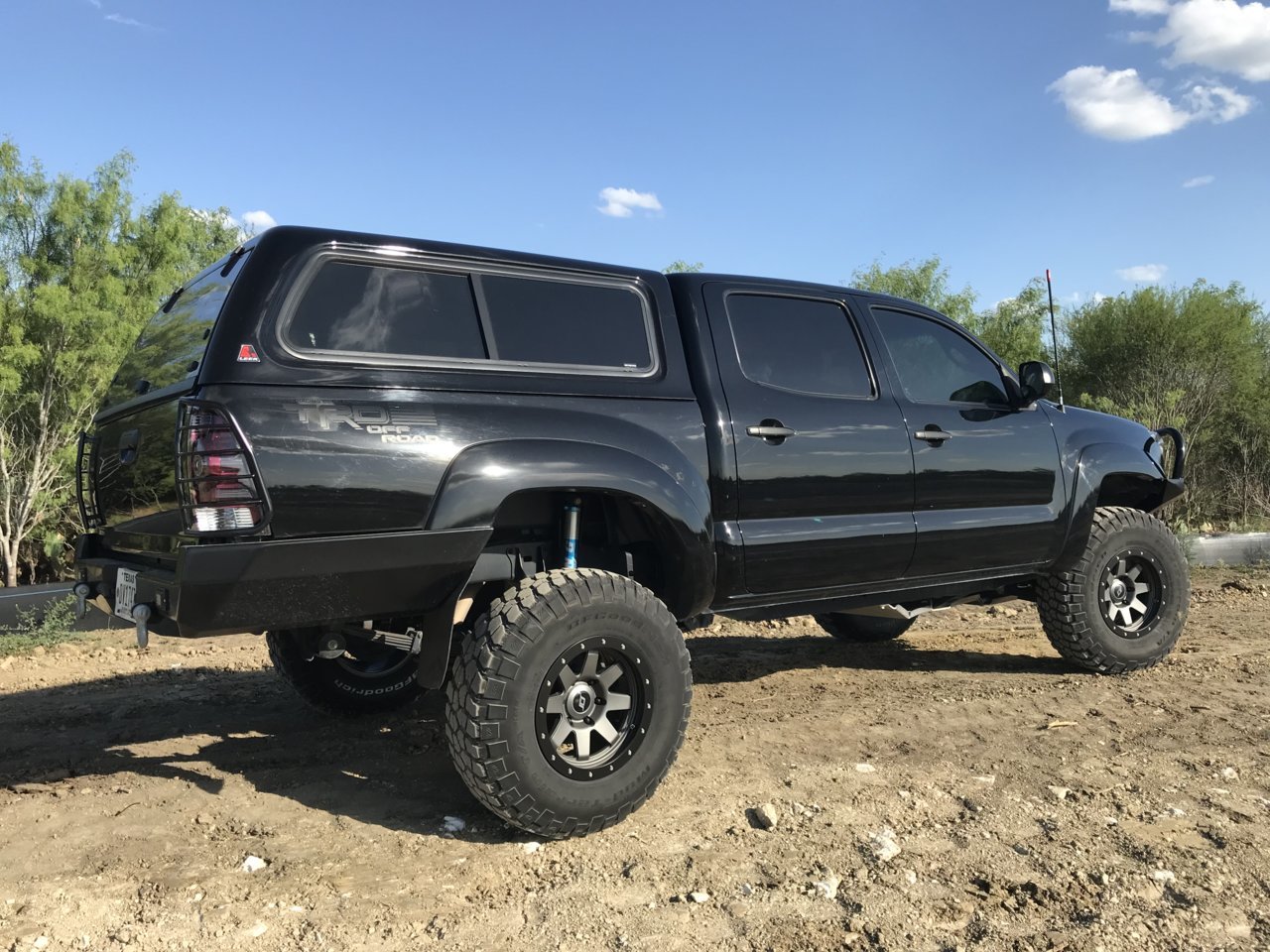

    New rims look great!

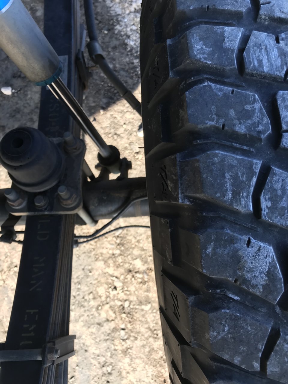

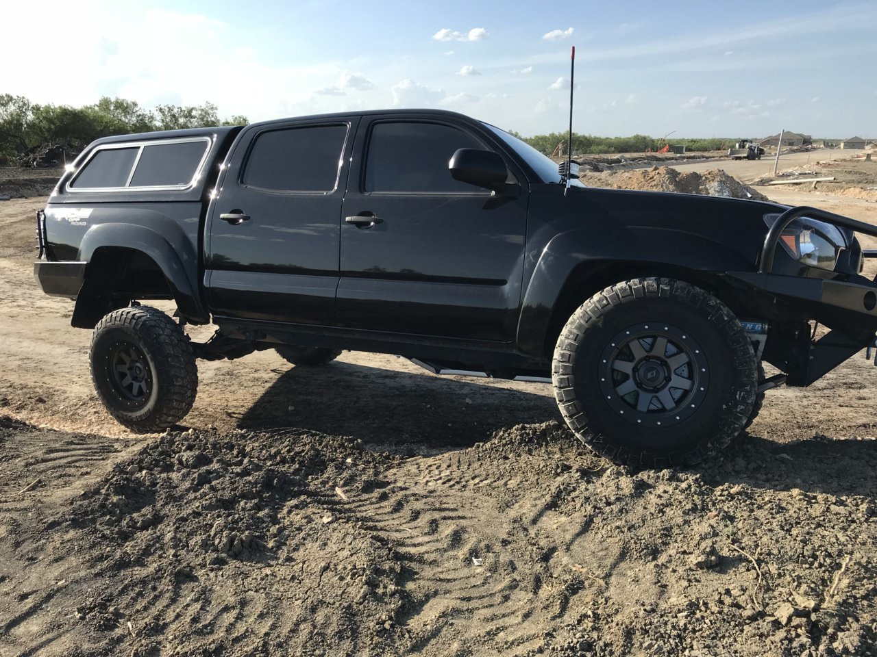

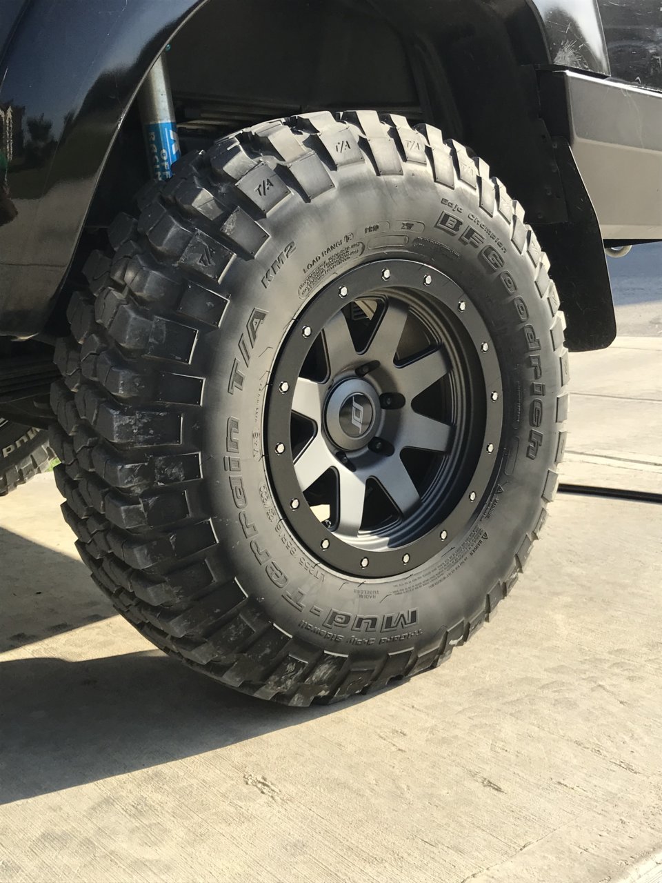

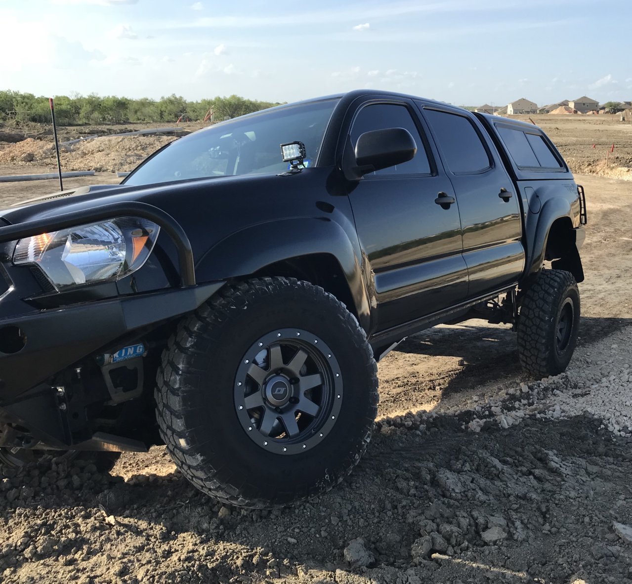

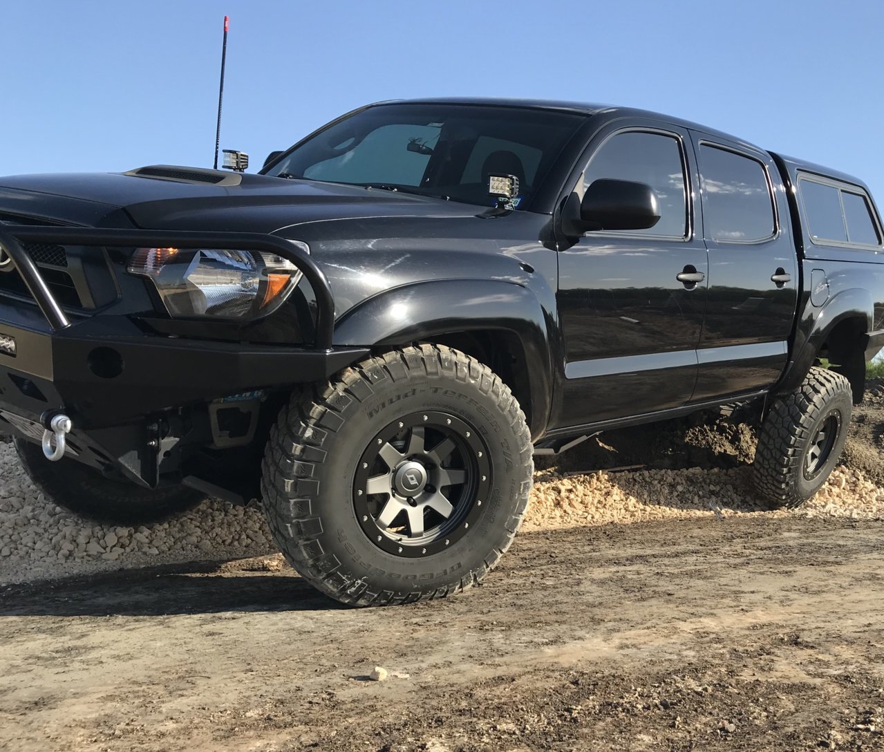

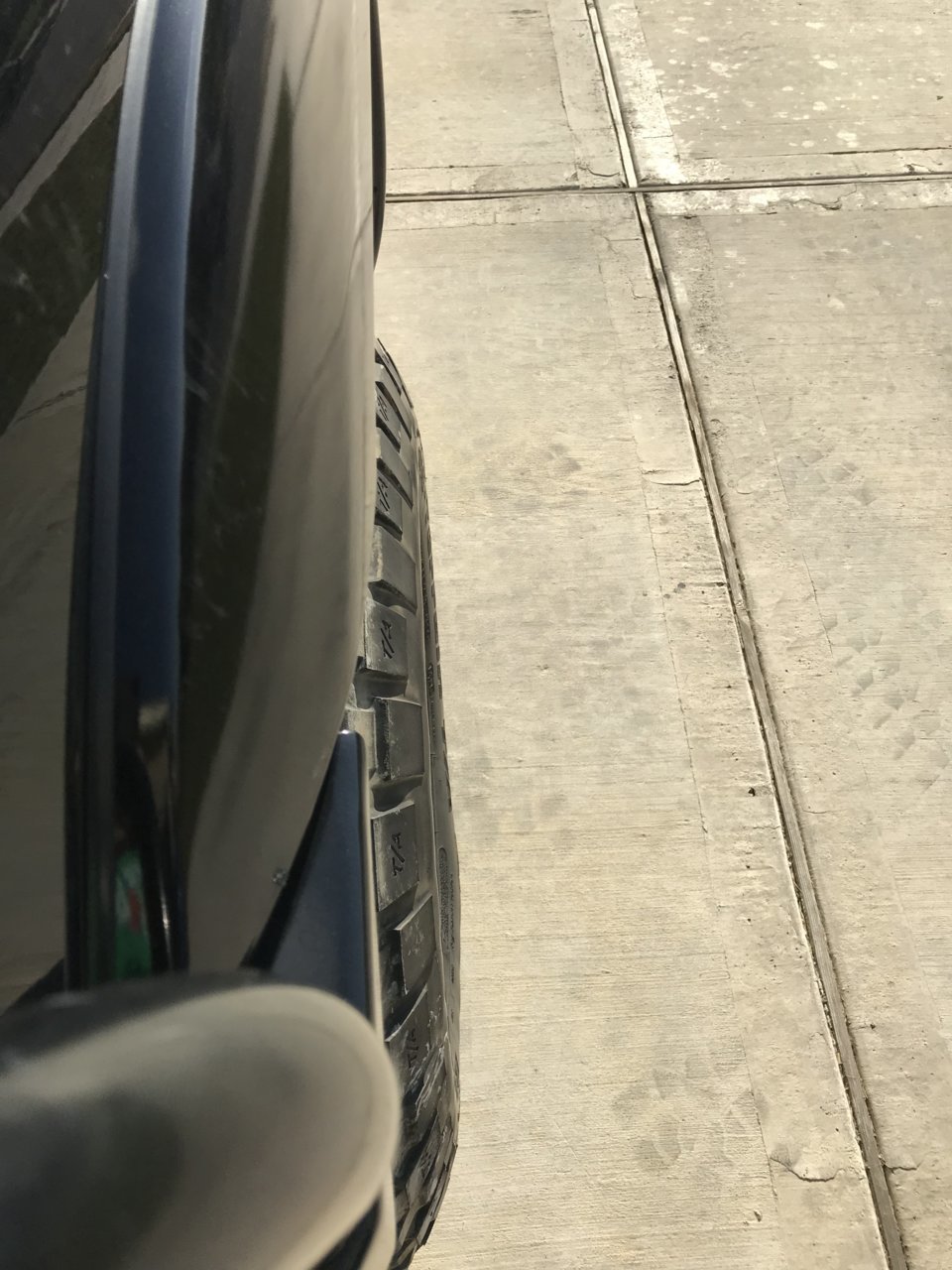

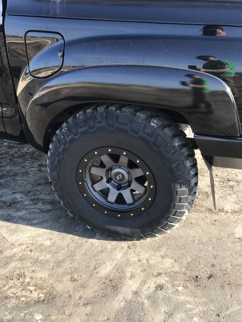

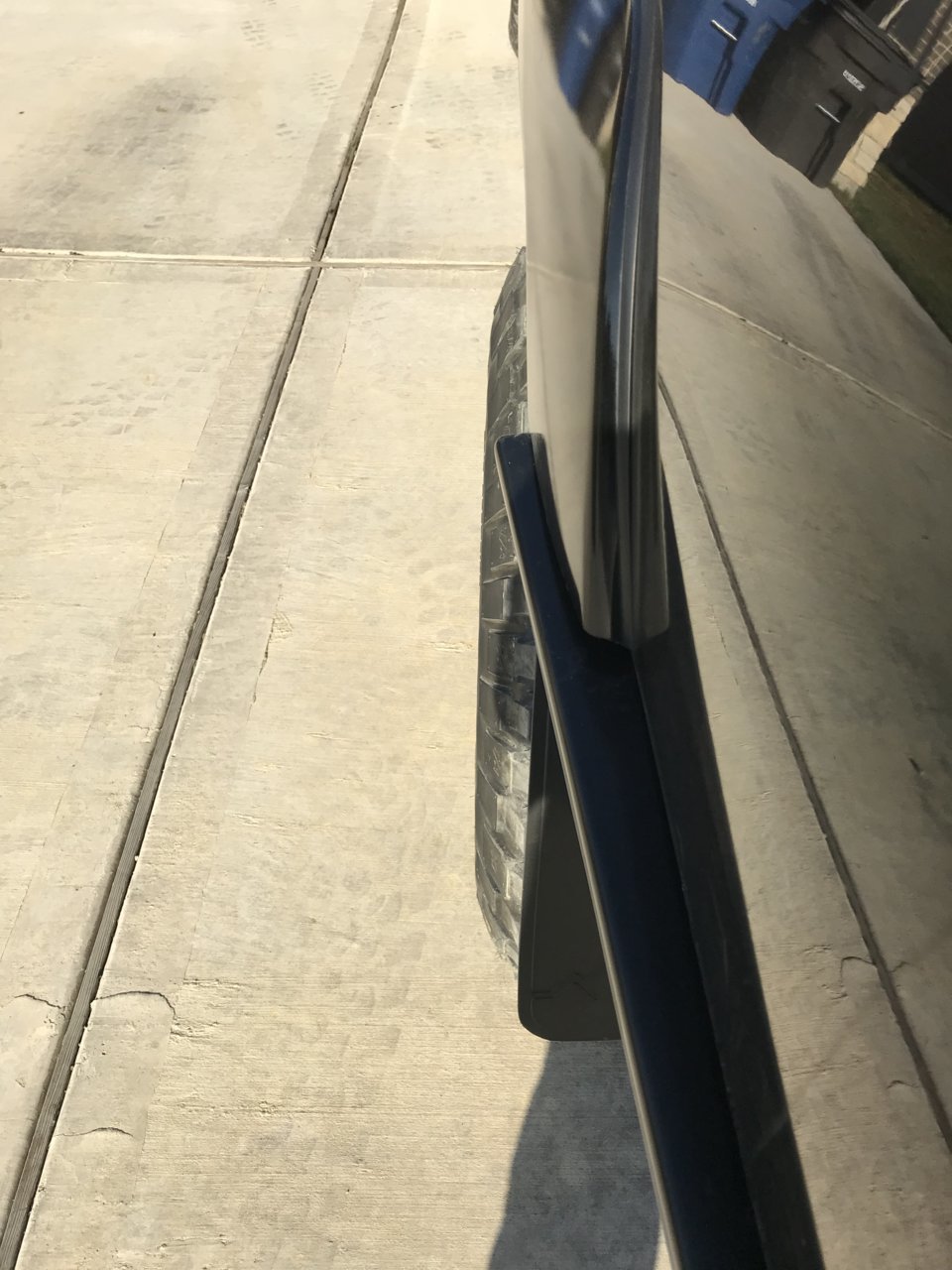

    Thanks!
    I'm really happy with them! The old rims made the tires sit really far inboard and the truck looked like it one of those railroad service trucks.
    Now the tires sit just outside the wheel well as they should.
    I'm thinking I'm going to stick with the 255's after all. Until I can fit 35's at least. Sticking with the pizza cutters for now will give me more time to save up for gears and the front locker and plan out the fender hack a bit better. I'd rather take my time than rush that kind of thing.

    Looks pretty good as is. I went with 265, 75, 16 and think they look fine. While I really want 285, I have no real need or practical use. I would like to do it though. You could always go a touch bigger next and not have to cut or do anything to it.

    285's look pretty good but they do take some work to make them fit right. Nothing wrong with 265's! I will say, if you want taller and no trimming, 255's are a great size.
    My wife kind of talked me into keeping with the 255's until I do the labor to for the 35's. For now I'm going to hold off until I have the gears and locker installed and prep the wheel wells. I'm probably going to have to change up the intake and fender liners too.

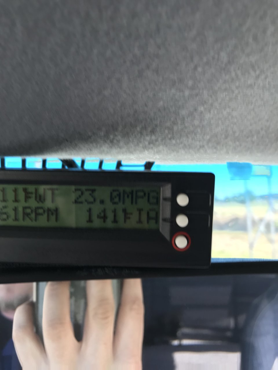

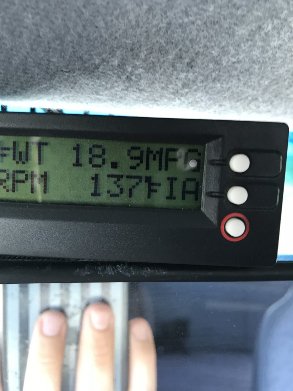

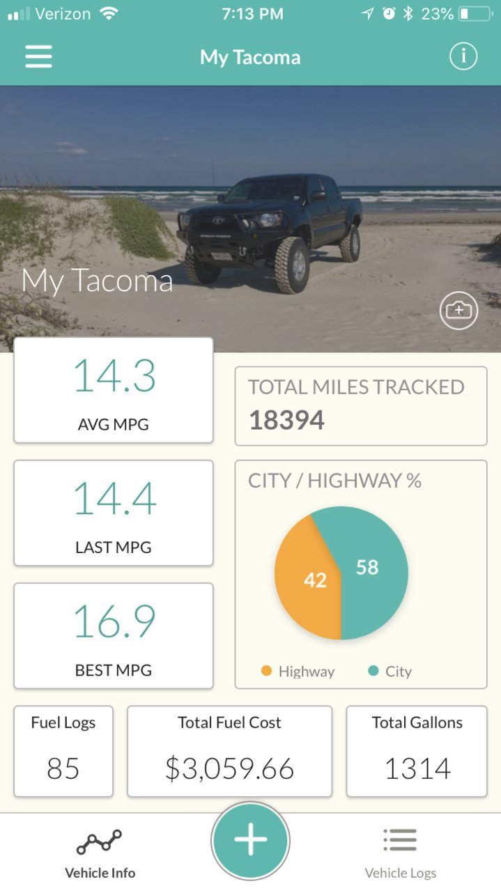

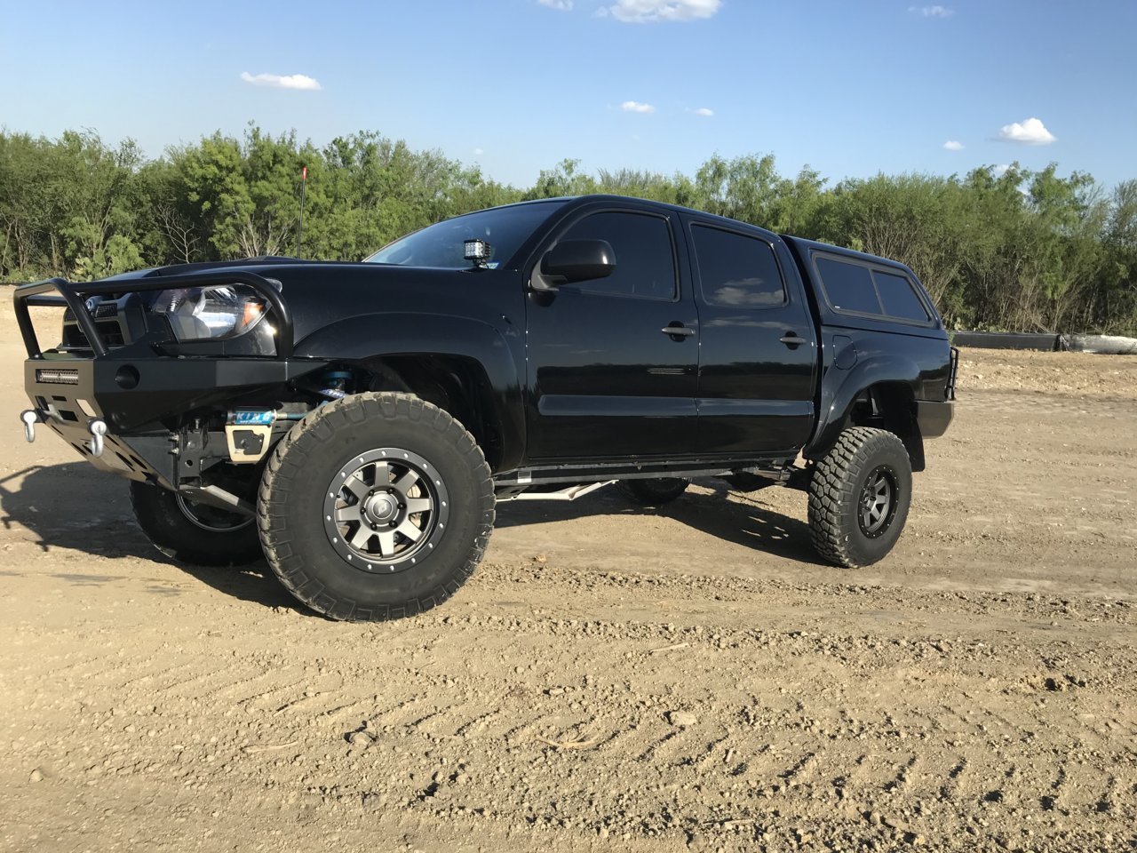

    Jaysus I need to regear. This is almost embarrassing. The truck gets 14.3 mpg average right now. My 98 Jeep Cherokee with 6" of full long travel and 33x12.50's gets around 18 in the city and 22+ on the highway with 4.56's.
    Jeep - taken today, 7/2/18
    62B3C1F8-55A0-4529-9D7D-9ADCC54963CD.jpg 7C3D46E7-7EB2-40C5-A4E7-312D15851ED2.jpg
    Truck

    I get 14.5 mpg on a regular basis. If I get to wide open hiway maybe 18, with a strong tail wind.

    I do about the same, just wish I had more tailwinds lol
    I’ve been experimenting with mid-grade and the last couple fill-ups it’s showed 1-1.5 mpg improvement. Not really worth the extra mileage but the truck does run much better. No more knocking at lower RPM, so that’s a plus.

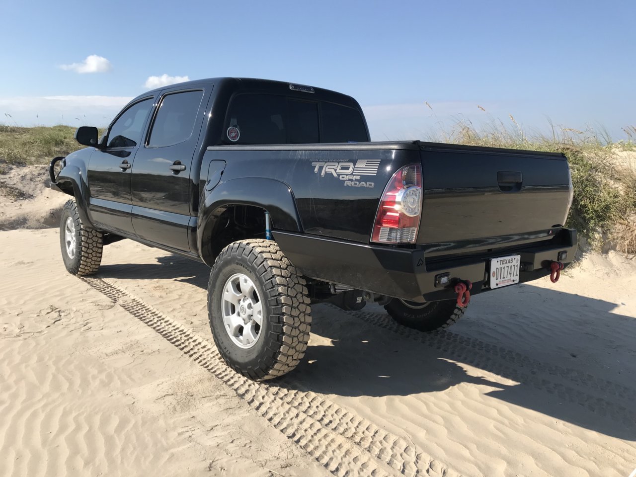

    For Sale - Pelfreybilt rear high clearance bumper. Used but in excellent condition. I will include the rigid back up lights and wiring harness for them as well. If you need help installing it, I will be happy to assist and supply beer in my shop.
    More pics can be found throughout my build and are available on request.
    The catch - it won’t be available until I can get the dual swing out bumper on.

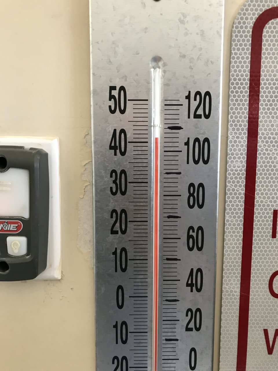

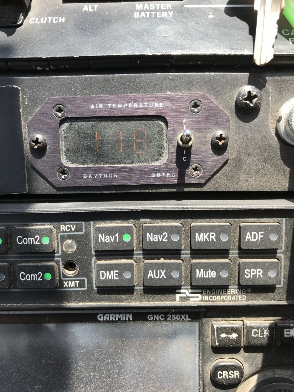

    Not as hot as last year but still damn toasty. And humid!

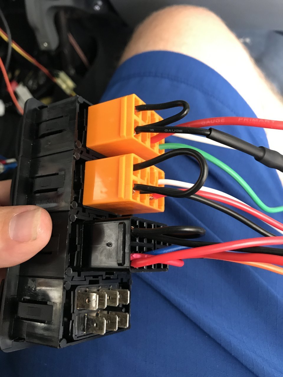

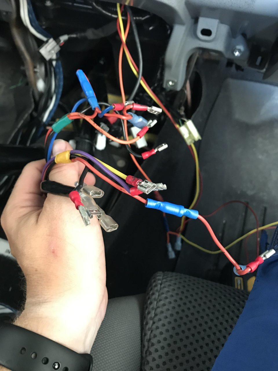

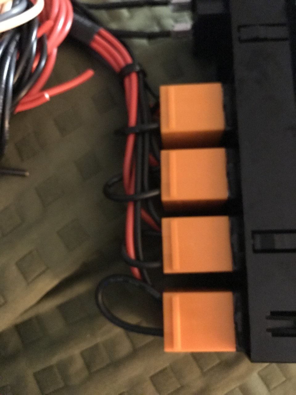

    Started on re-wiring everything in the truck yesterday. The first time I did it I was in a rush and just made everything work. The second time I didn't finish and went back to the way it was the first time. Third time's a charm. It took me all day yesterday to build new harnesses and pull out the crap from before and I'm still only about 1/3 of the way through.
    I was successful in rerouting the fog light switch to the new OTRATTW switch and ran all the wires for the A-TRAC over to the left side of the steering wheel. Now I just need to get the proper size factory looking switch to replace the original. Anyone know a good vendor?
    I also built a Bussman 5 relay and fuse box to run anything that'll require a relay. Wish I had more real estate under the hood though.
    Everything is going from this
    To this
    To this
    And beyond.
    Once I get everything in I'm going to label everything with a label maker, drill-twist all the wires, sheath them, and mount the harness up and out of sight. I've also got some rock lights and interior lights to install but honestly...
    ... I'm probably going to hold off on that until fall. I just won't do any night wheeling.
