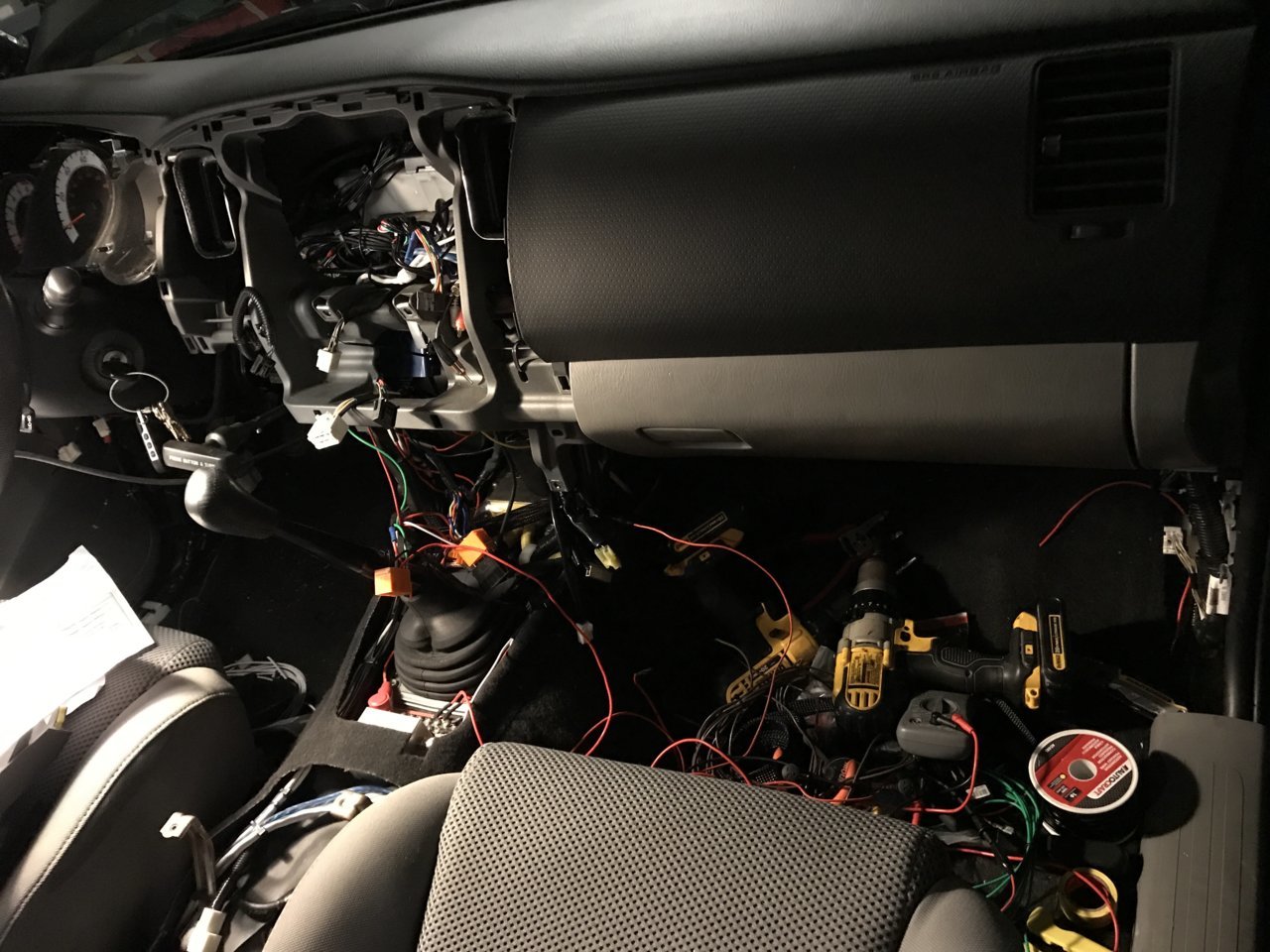

    I'm on day... Four? Fuck, day four of operation long circuit with the truck. I've built three all new harnesses and have one more to go. I still need to find a new A-TRAC switch the size and style of the factory fog light switch to the left of the steering wheel. Anyone know where I could find something like that?
    The truck has looked basically like this since Monday night.

    So I think it's done. I redid all the wiring I had hastily installed previously and made it something worth looking at. But most importantly, I made it safe. All accessories are on fuses and relays.
    The switches share a fused and relayed common power bank but that only supplies power for the LEDs in each switch.
    Power bank -
    This is located under the trim near my shifter and in front of the cup holders. When the key is in the Acc or On position, the relay is triggered and supplies power to the bank from my bluesea fuse block and 12. gauge wiring.
    The switches before -
    And after -
    I also rewired the fog light switch from left of the steering wheel to the new switches under the AC controls and ran the ATRAC switch to the old fog light switch left of the steering wheel.
    Special thanks to @Phoosa for the pics and info on the San Antonio thread! He also gave me a simple solution to finding that switch; I reused the fog light switch and I'll just find a replacement ATRAC switch cover to replace the fog light emblem.
    All the switches run through the firewall and out to a bus bar. This makes adding and subtracting accessories a breeze and should I have to do any maintenance on a wiring harness I can simply unscrew it's respective wire from the bar without having to redo an entire harness and break every little thing down.
    These are simply the signal wires from the switches for the relays - everything is all soldered and shrink wrapped too. I used clear shrink wrap on the buss bar for easier identification and because I like the look. the accessories get their power directly from the fuse block.
    Fog light switch details
    The ATRAC was exactly the same except the blue pin 85 wire is red with a black stripe.
    Harness construction.
    Not much to look at yet but it was coming along! In the end I changed a few things up but it was basically plug and play once I put it in.
