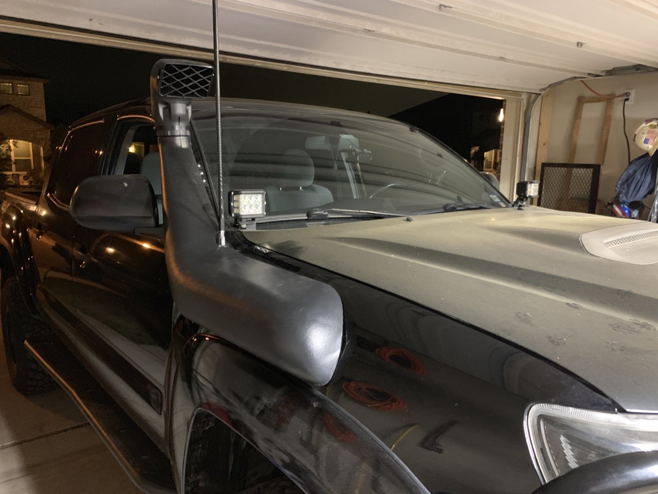

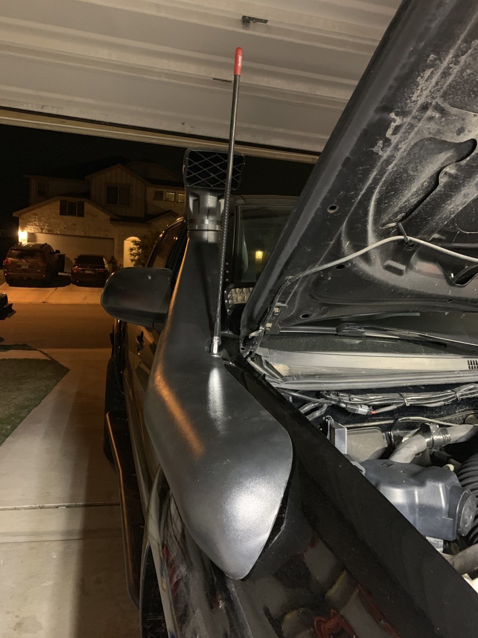

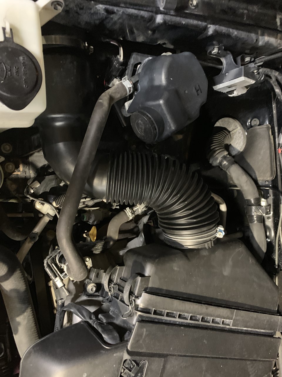

    More pics when there's daylight n stuff.
    Snorkelgang!

    Really need to paint that damn hood...

    Looks great Alex!
    Moar powar!!

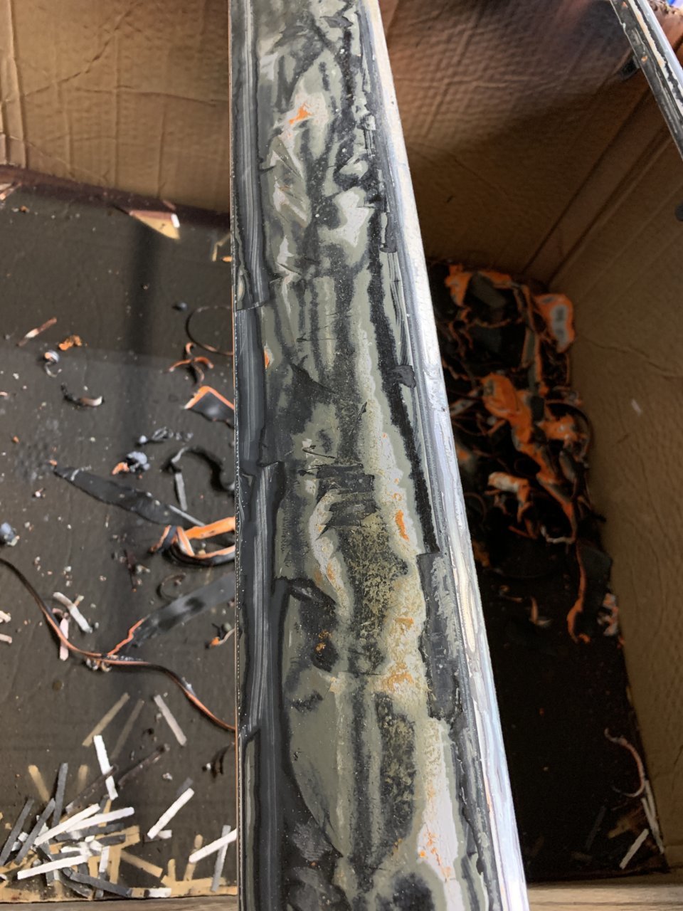

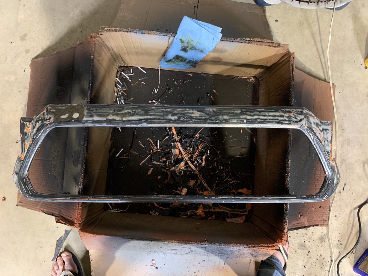

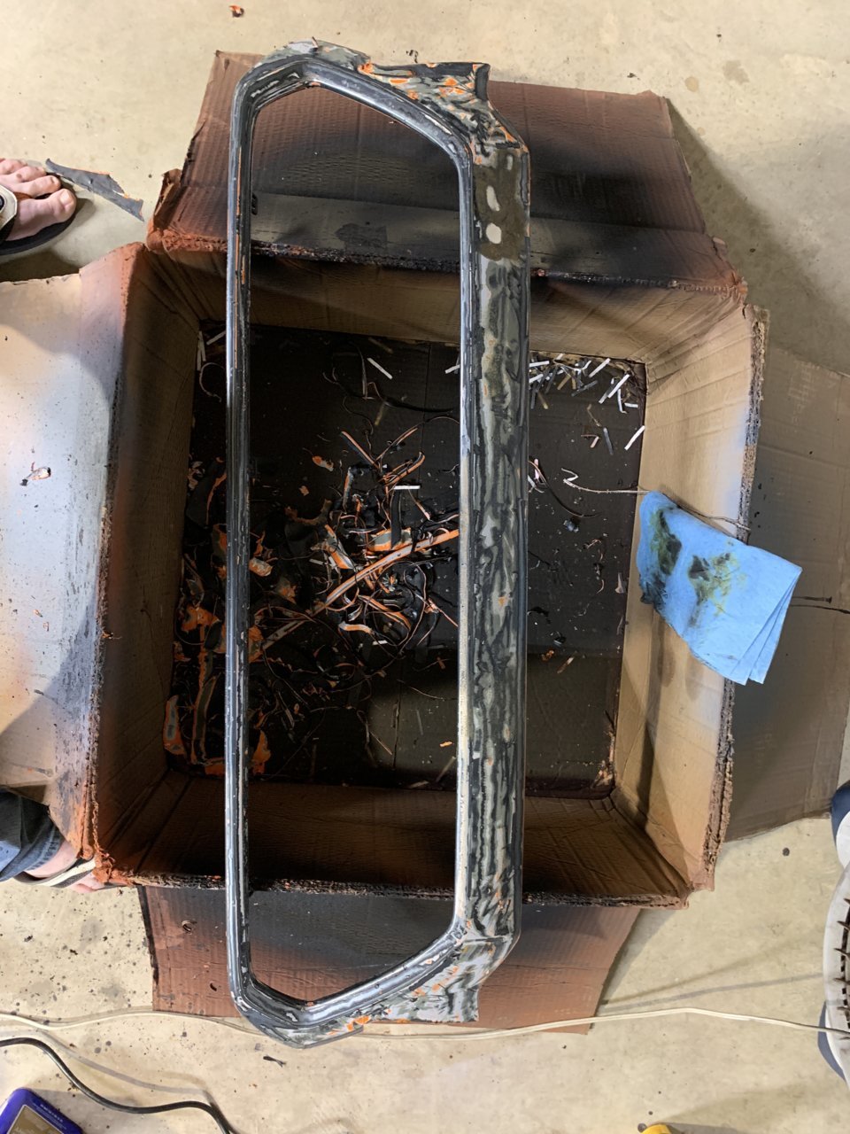

    Didn't like how much paint I had on the grill so after wet sanding it all perfect I scraped everything off
    Square one!
    I'll sand it all smooth to bare plastic again and do it right. Again.

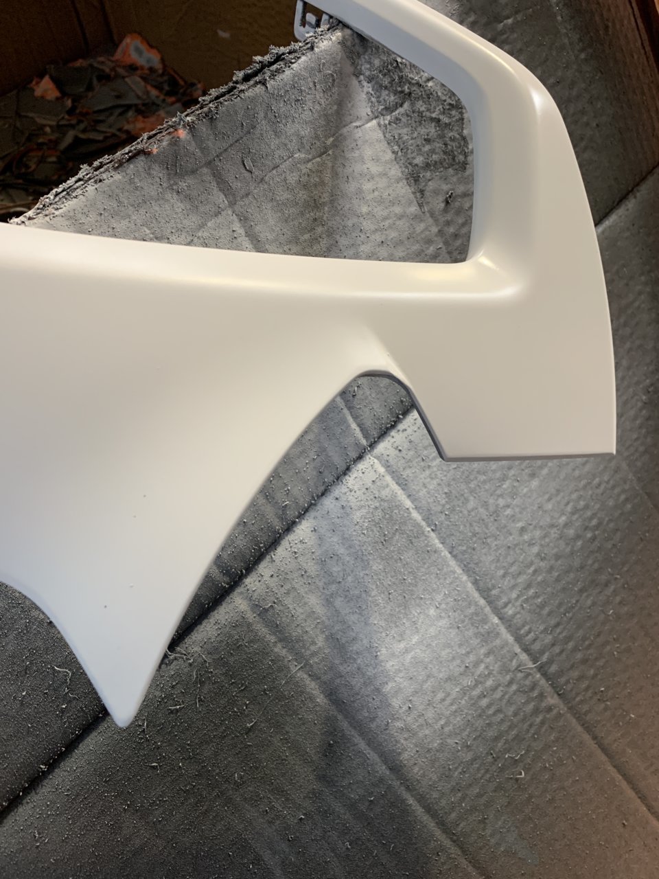

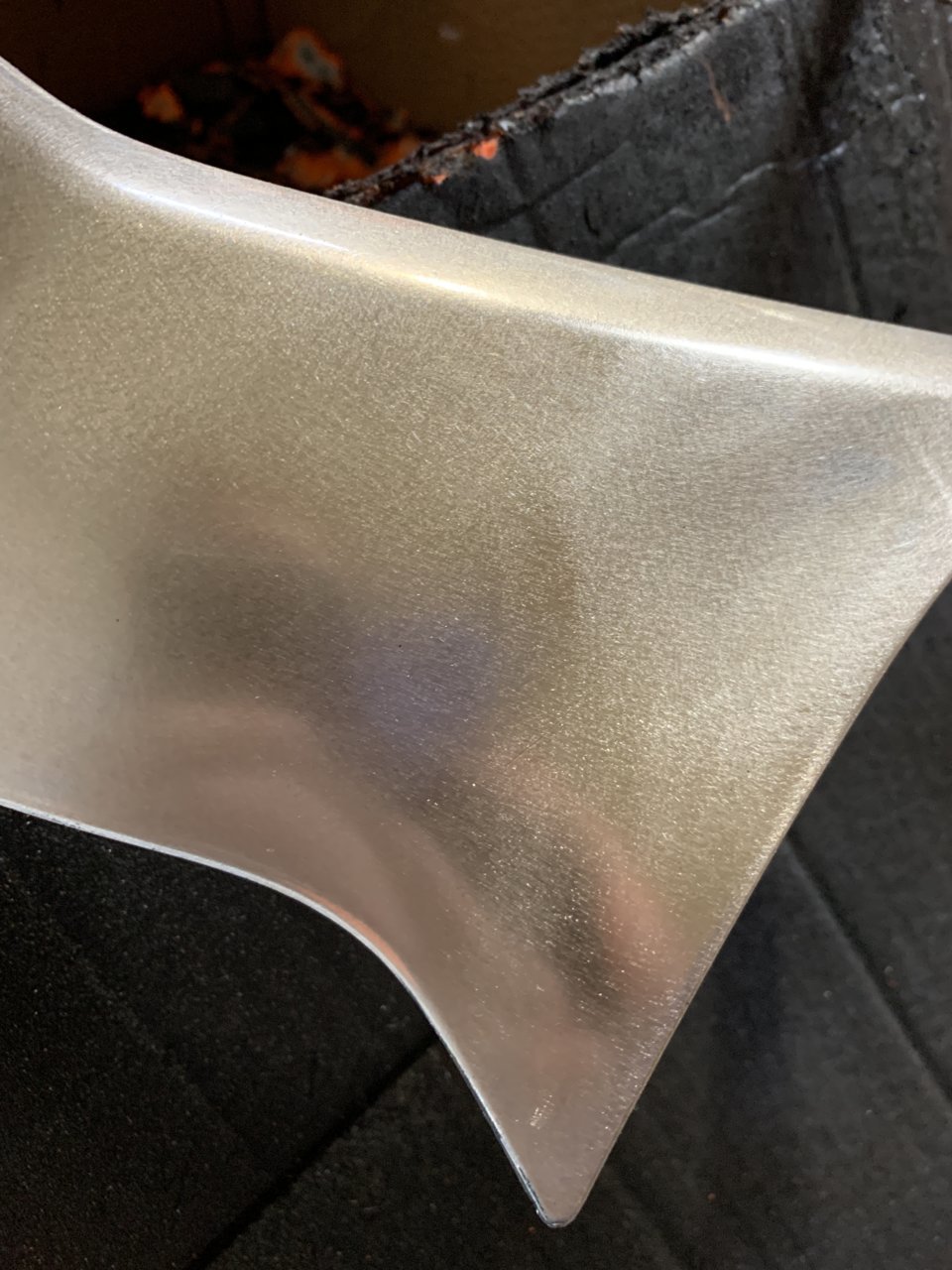

    Scraped the grill down to the plastic
    Sanded with 80 grit and got every bit of the paint off
    Primer went down smooth as silk

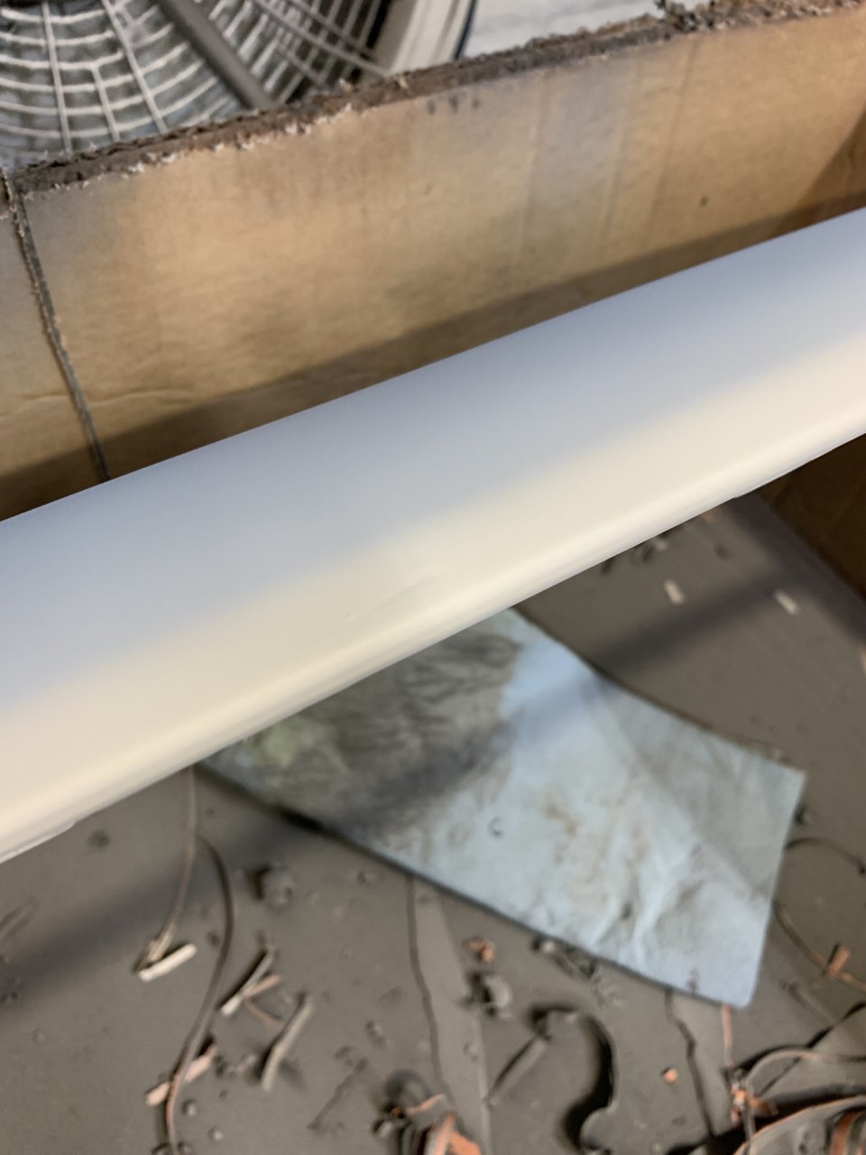

    But I did accidently touch the wet paint with the bottom of the can. I'll just sand it out. Should be done tonight or tomorrow with any luck.

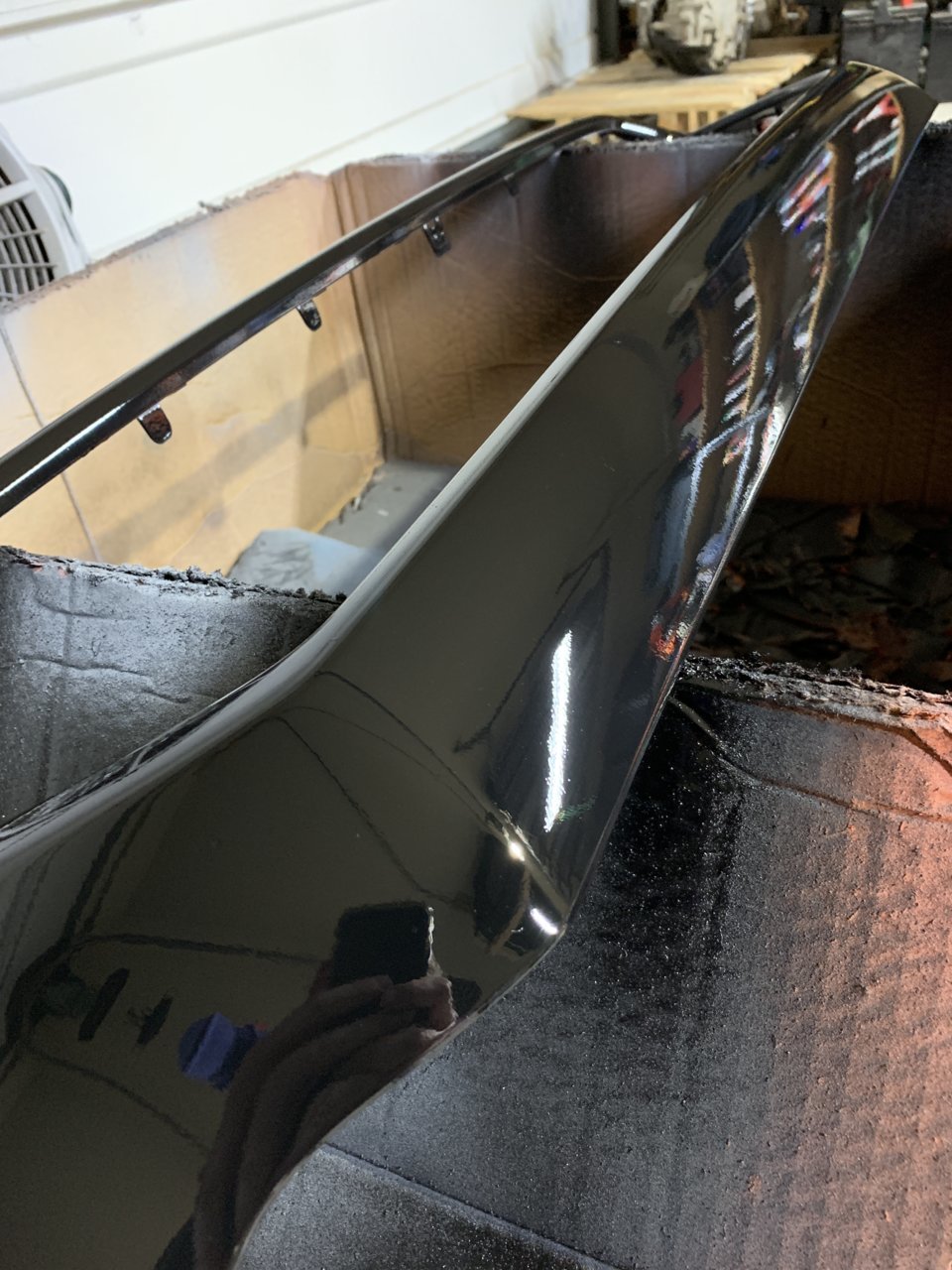

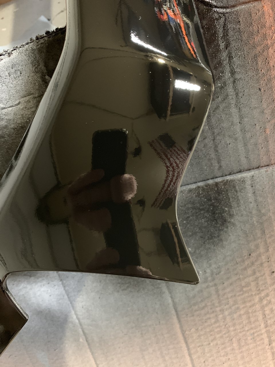

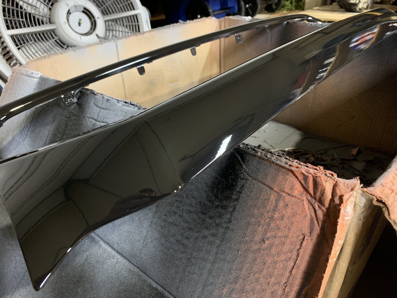

    First coat went down nice and even
    Second coat even smoother!
    Very happy with how this is coming out. I think one... Maybe two more coats of black should do it.
