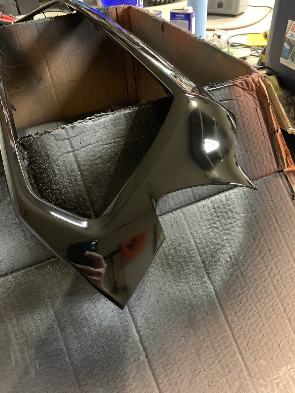

    Third coat.
    Netflix just called. Apparently I violated their terms of use when I painted this with a BLACK MIRROR finish.

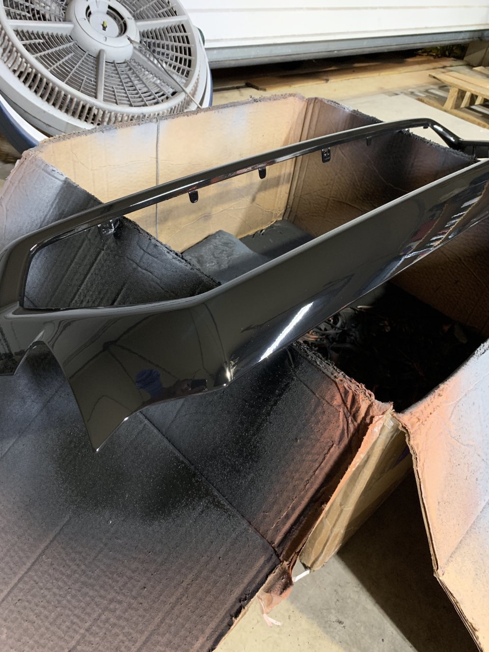

    4th coat, it just keeps looking better and better

    Just did the fifth

    That's the last
    I'll let it cure, wet sand, then clear coat and polish

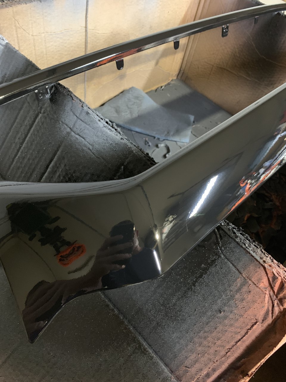

    I feel like if I try for more I'll ruin it. Every time I go to put down a layer I have wrinkle visions. Luckily the Krylon is good quality paint and has been nothing short of perfection

    I lied.
    Found a minor imperfection where the paint wasn't even and fixed it.
    7th coat.
    Honestly it just keeps getting better and better. That will be the last cost of black though. For real this time.

    Krylon is the shit
    So smooth and even. Zero orange peel, zero runs, zero wrinkle.

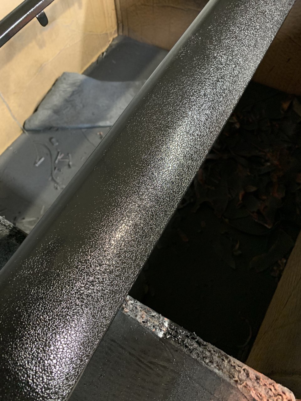

    I left the heater on in the garage all morning to keep the humidity down. I had a feeling I should wait until later in the day when the dew point dropped but the garage felt warm and dry so I started the clear.
    :frusty:
    Should have waited.
    Square one.

    That's what I'm going to try later on. It should sand out. It's weirdly smooth though. No texture, just looks like orange peel.
