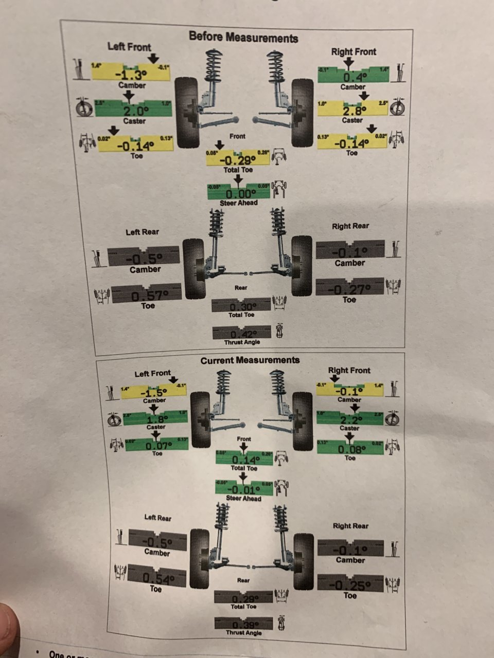

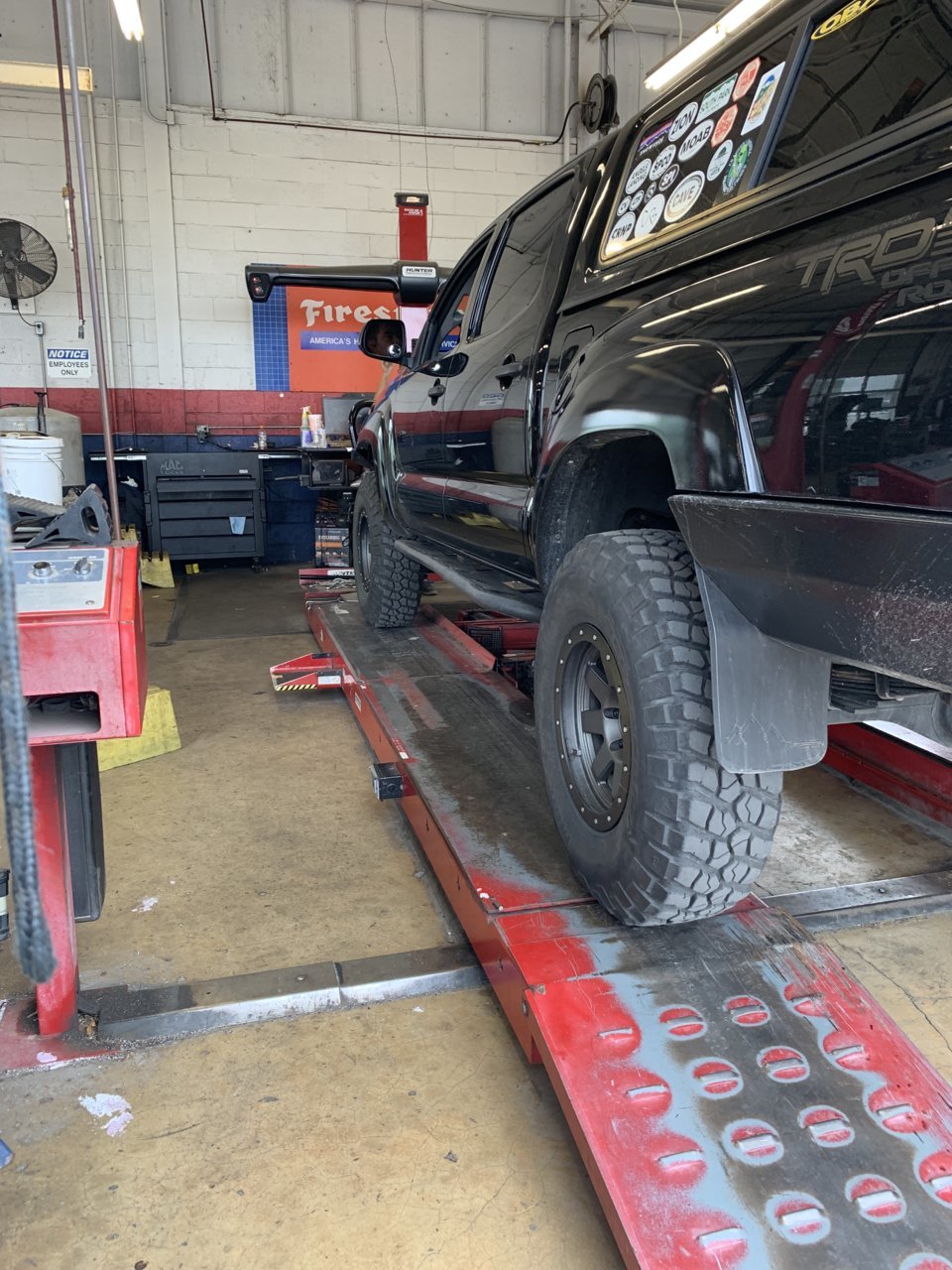

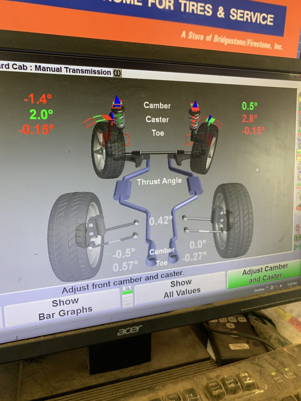

    After work I got a fresh alignment. Here's the before
    Thought the tech was going to melt my clutch getting it up there so I got him to put it in 4lo. He still cooked it.
    :bananadead:
    Here's the after
    Close enough!
    Truck is back to driving like it's on rails again. No more wandering, no more pulling! I'm good with that.

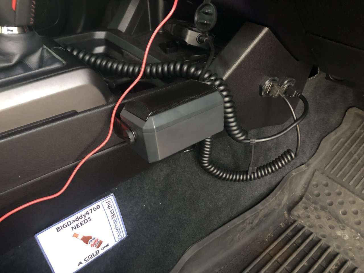

    Mark's (@LostHusker) install is cleeeeeeean
    I'd like to do something similar.

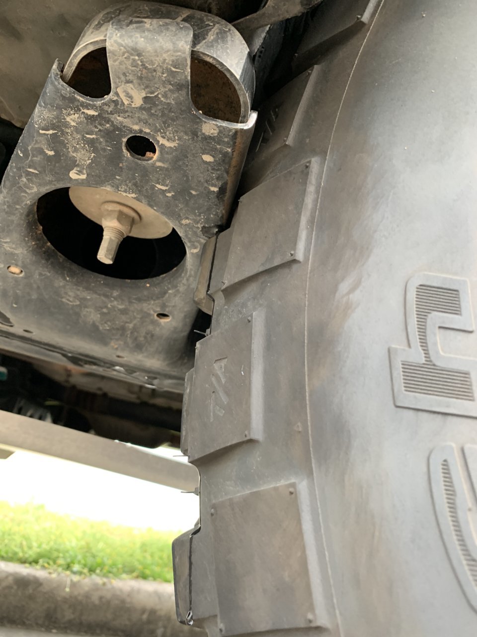

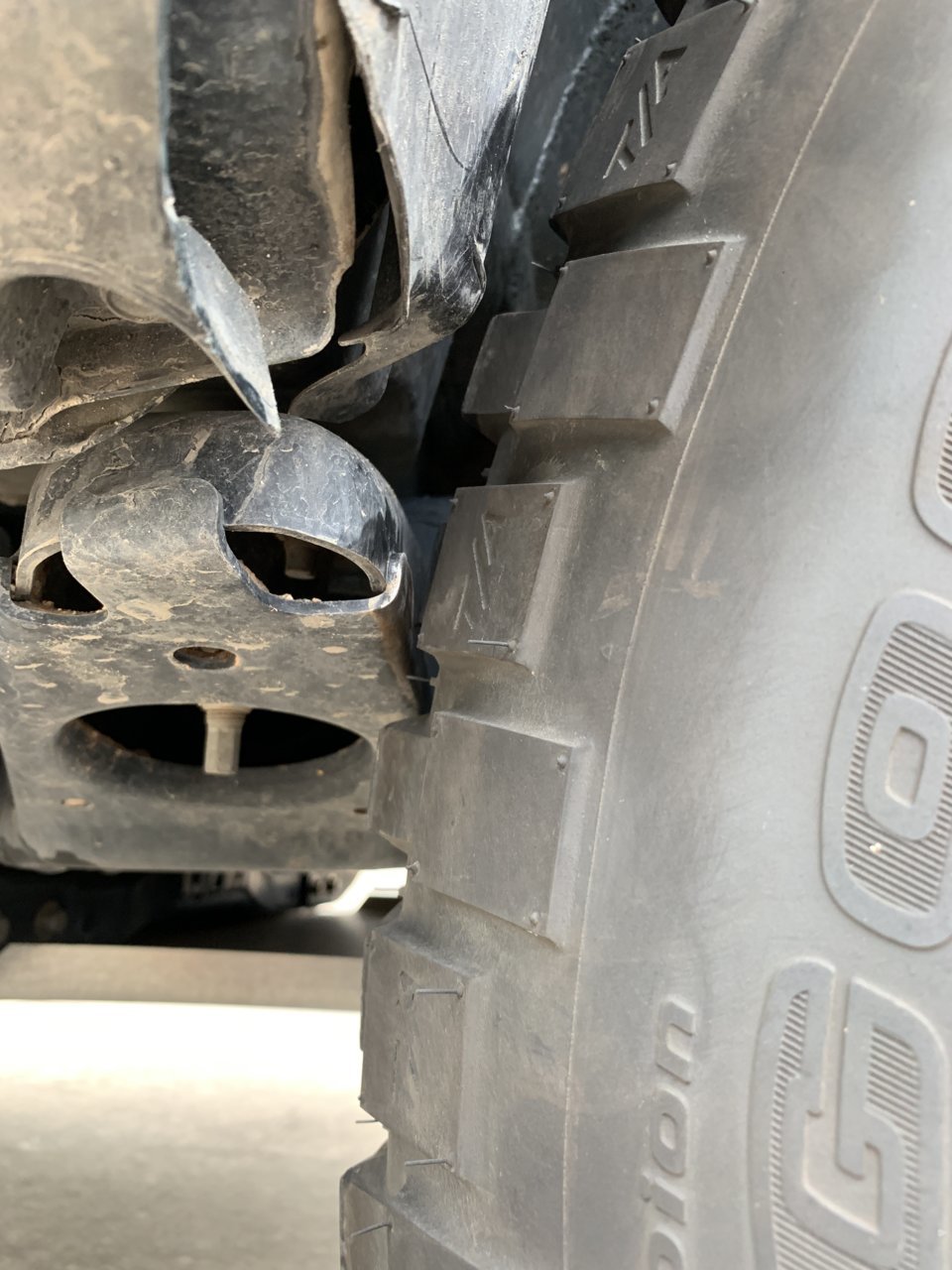

    Wasn't thinking after my alignment yesterday. I'd been there for a couple hours and was ready to roll. I need a bit more caster cuz
    That's on level ground
    And that's under mild compression.

    Yarlly

    Dats gonna be a jambolicious problem
  8. May 2, 2019 at 2:05 PM
    #1268
    hoverlover
    hoverlover [OP] Never pet a burning dog.
    Apr 4, 2016
    #183342
    10,844
    C-137, Laniakea, Virgo, Milky Way, Earth, USA, TX
    Things. Stuff. Lots of bad decisions.
    Mostly Zip-Ties
    Got it fixed yesterday :D
  9. May 2, 2019 at 2:05 PM
    #1269
    BassAckwards
    BassAckwards Well-Known Member
    May 3, 2016
    #186002
    27,902
    2009 Tacoma AWD Turbo 2TR-FE
    Full-time AWD & BorgWarner EFR 6258
    Im guessing more caster took care of it?
  10. May 2, 2019 at 2:05 PM
    #1270
    hoverlover
    Apr 4, 2016
    #183342
    10,844
    Mostly Zip-Ties
    Added 2.2 caster
  11. May 2, 2019 at 2:06 PM

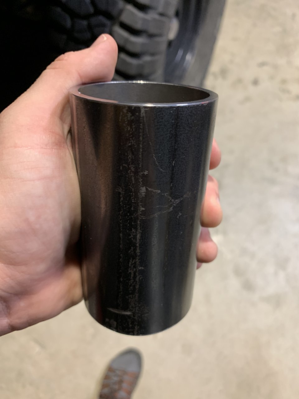

    I found a bunch of scrap 1/4" steel stock I'm going to practice some beads on. Including this little gem
