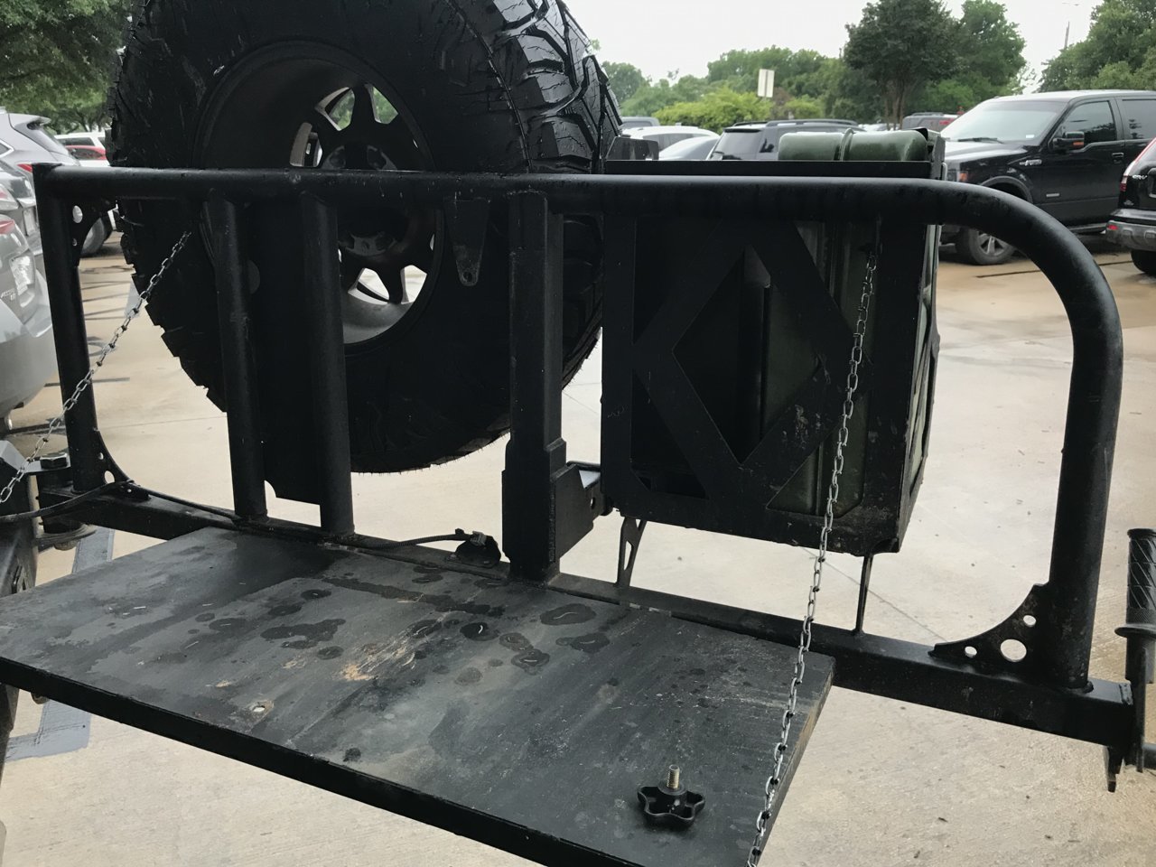

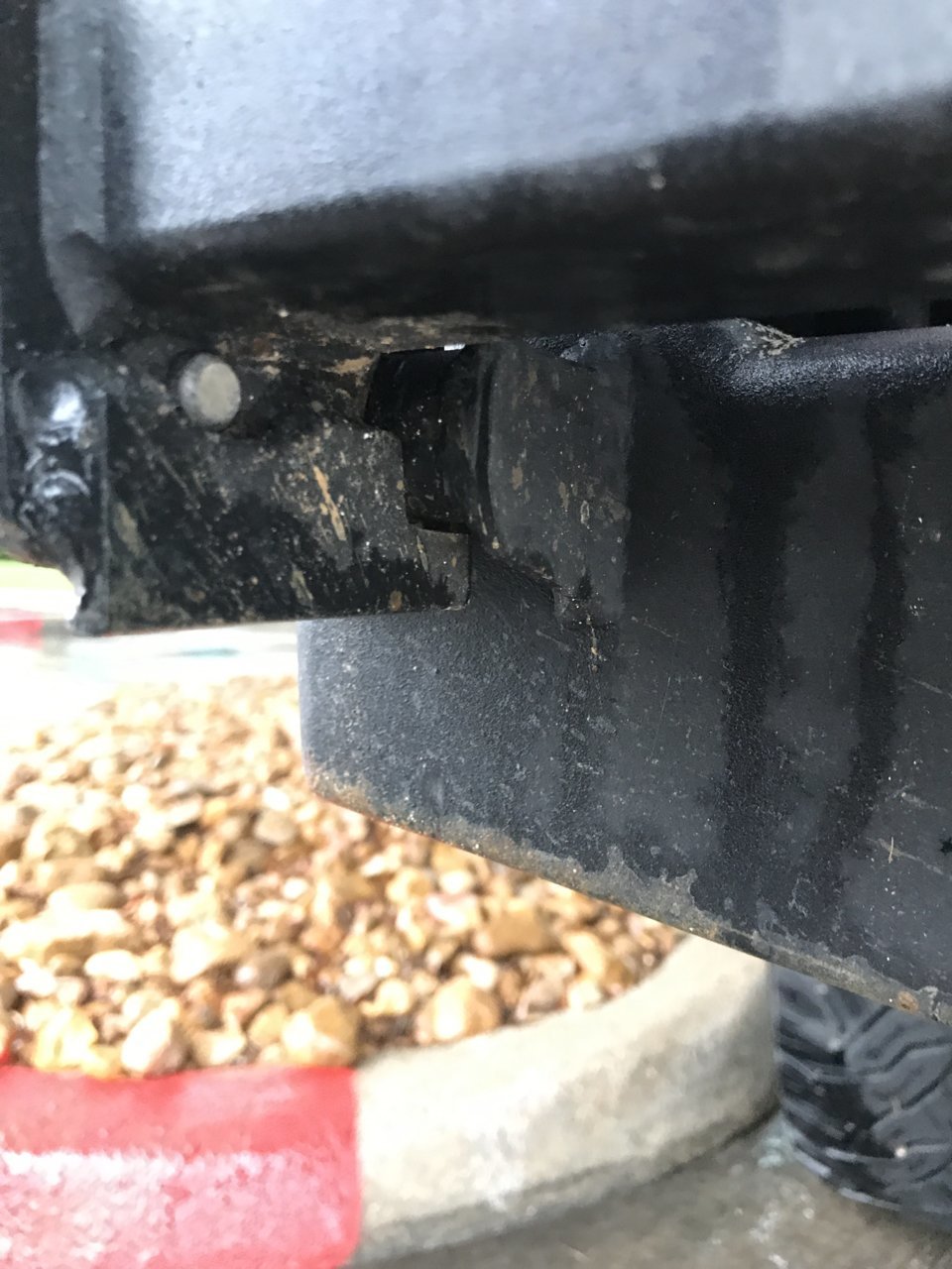

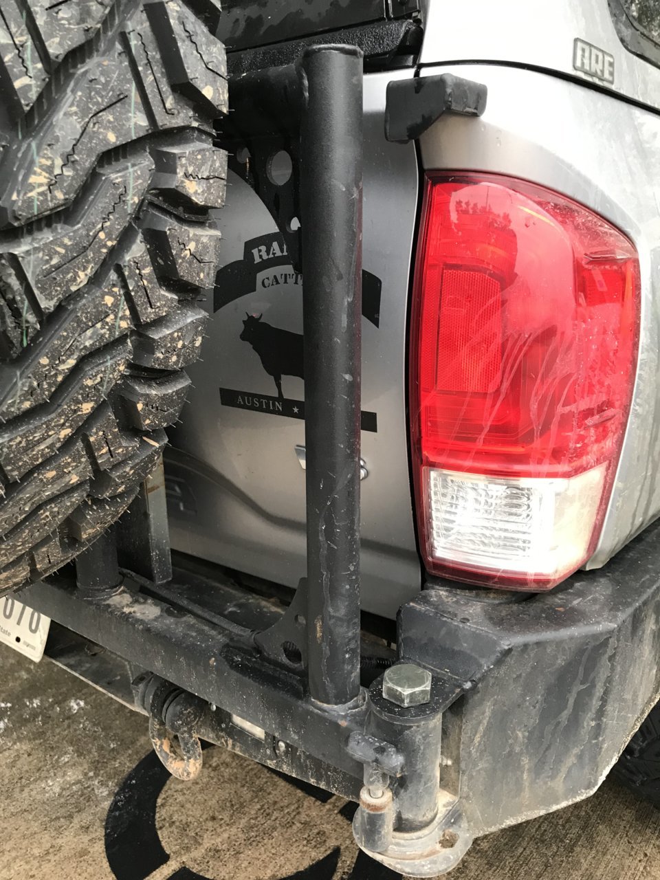

    Here’s how mine is built, I like it for the most part. It’s heavy as shit and I had a lot of banging when I’d hit a bump. The whole swing arm would jump up and slam down. It was super annoying so I added a small tab below the latch to stop it.

    Nice! I like how the latch attaches to the bumper. I think that's how I will do mine do I only have to worry about squaring up the hinge side to the bumper. The rounded steel doesn't have to be square, just level and in line with the latch. Thanks!

    Yeah it’s pretty simple and that’s cool. I added the center upright so I could mount the 2” receiver for my bike rack.

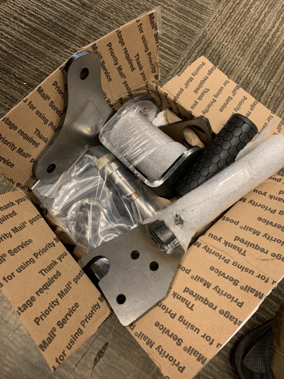

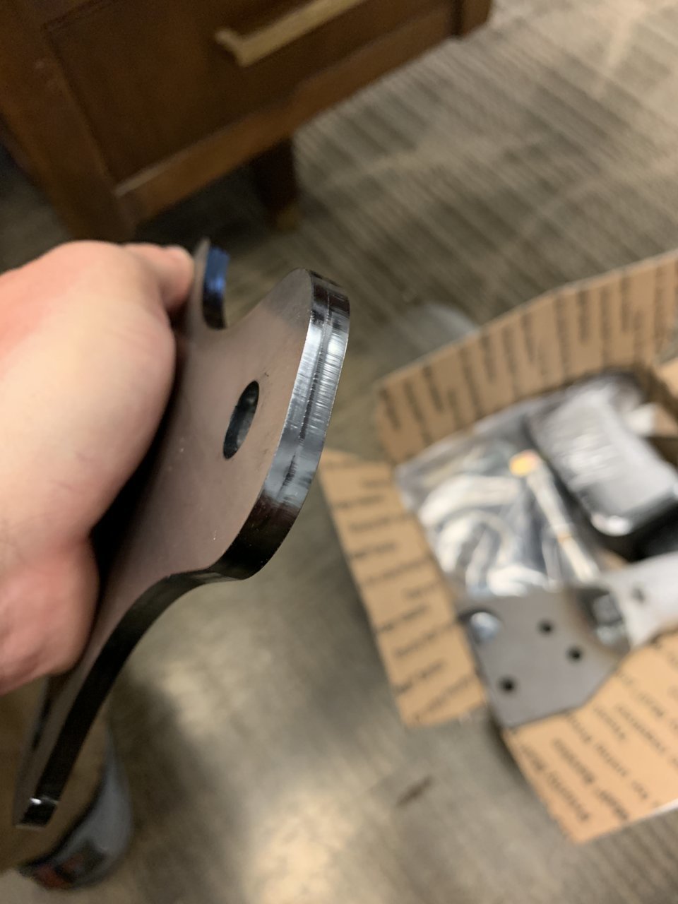

    Damn that was quick!
    These things aren't as beefy as I was expecting...
    They're way more beefy. They're the whole damn bull!
    Now I need a bigger welder. I wonder if I can rent one or something? One of those big ass Lincoln Electric self contained generator/welders or something. As much as I'd love to run 220 to the garage, I'm not planning on staying there much longer.

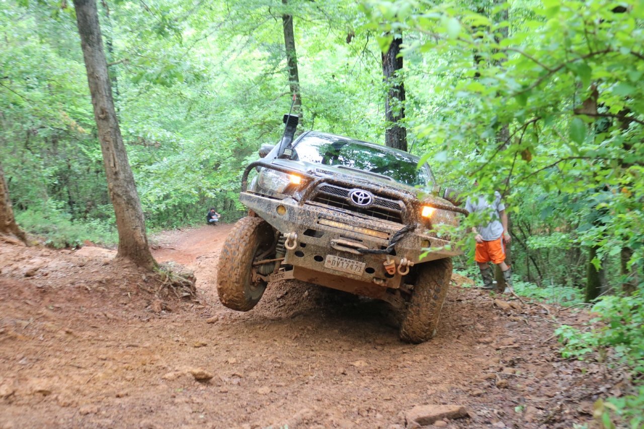

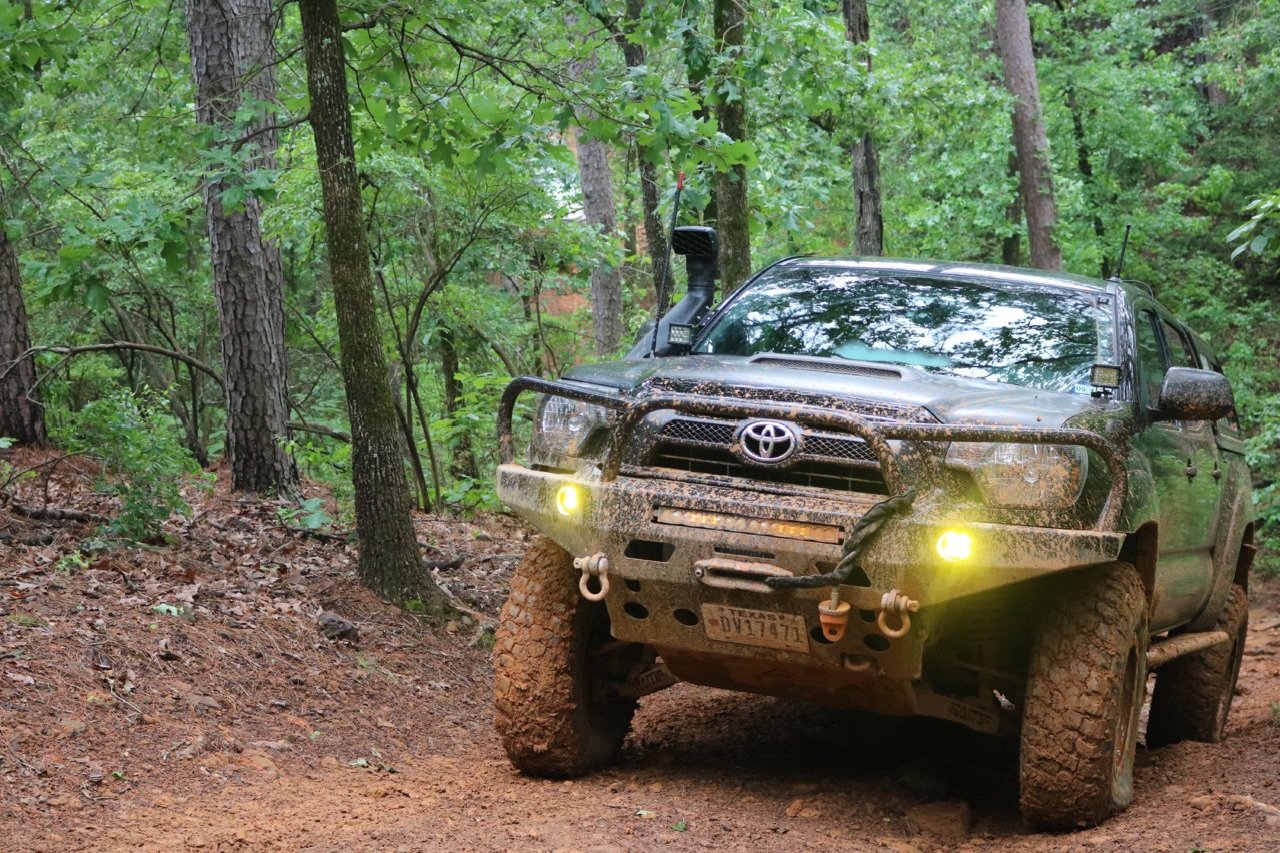

  16. May 11, 2019 at 10:24 AM
    #1336
    DiamondW
    DiamondW Stockblocker
    Feb 1, 2019
    #281480
    2,204
    Kent
    Gonzales Co. TX
    ‘06 AC SR5, ‘17 Tundra, ‘14 GX460
    That looks like a blast!
  17. May 11, 2019 at 10:26 AM
    #1337
    Bigdaddy4760
    Aug 6, 2017
    #226049
    77,337
    Maner
    Poolville Texas
    That looks like a lot of fun.
  18. May 11, 2019 at 10:36 AM
    #1338
    hoverlover
    hoverlover [OP] Never pet a burning dog.
    Apr 4, 2016
    #183342
    10,844
    C-137, Laniakea, Virgo, Milky Way, Earth, USA, TX
    Things. Stuff. Lots of bad decisions.
    Mostly Zip-Ties
    It was pretty cool, just trails everywhere. I want to move.
