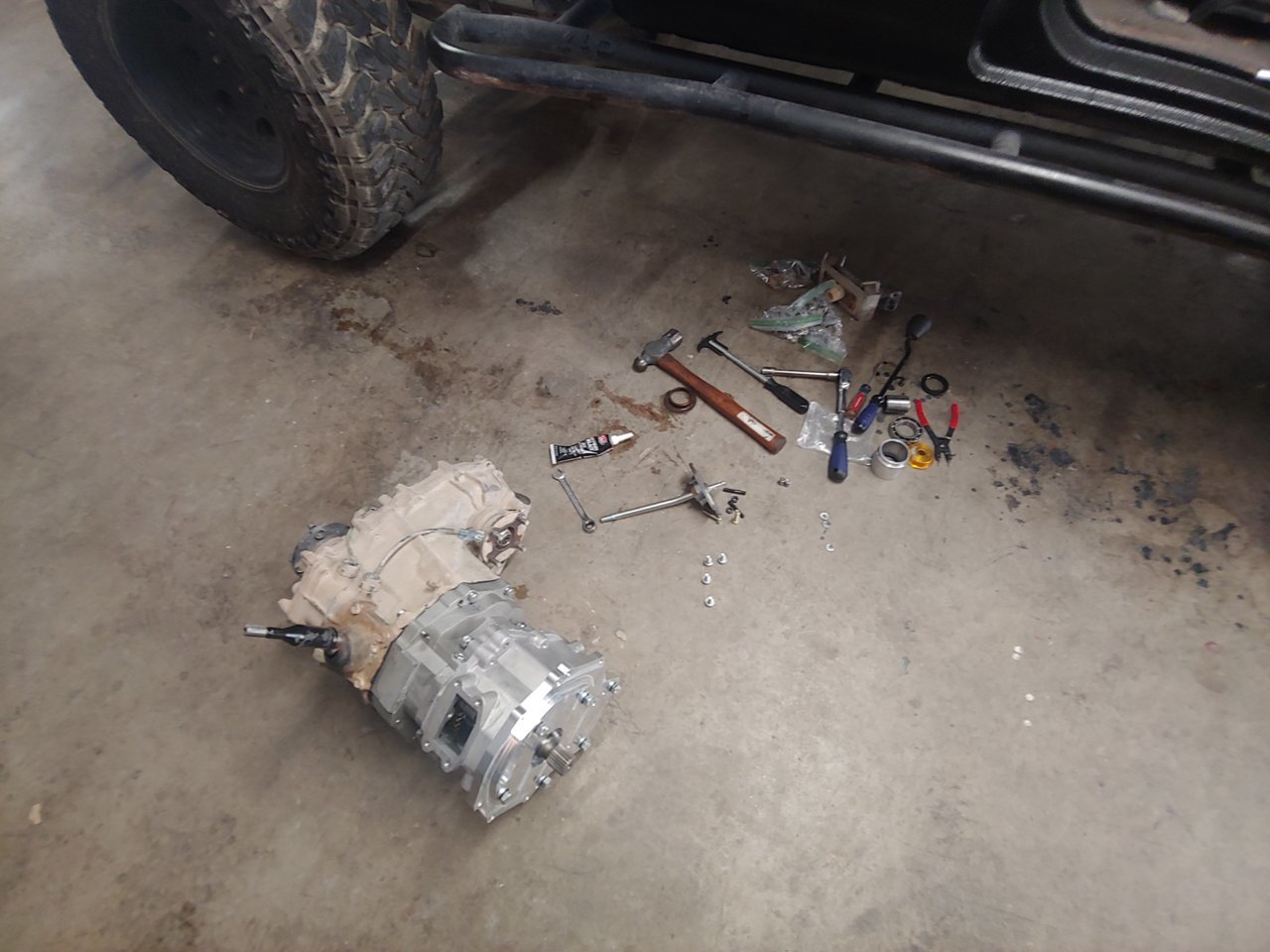

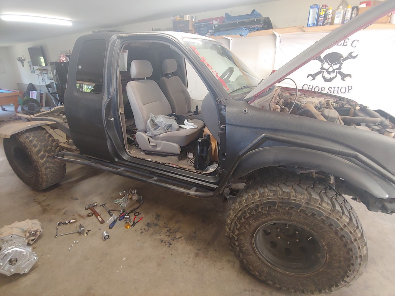

    Was in the middle of installimg Dylan's until lack of install instructions put a stop to it.

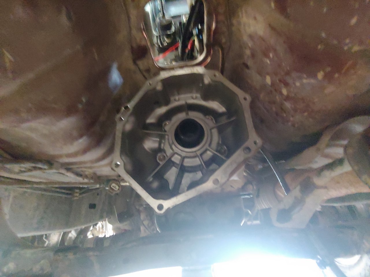

    The sleeve was too large to fit through the bearing, so I measured the stock and the new provided sleeve and it was 0.10 larger. No where in the instructions s did it say that the bearing had to be removed, but it was a requirement. Unfortunately we were working on a Sunday, so no one to call and verify this information.

    Transmission output shaft support bearing.
