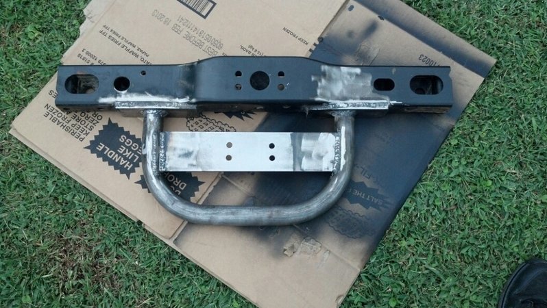

    You didn't add or modify a brace to the cross member?
    56B3ED51-0800-41BB-B286-58FFDEFA70D1.jpg 603D1E16-84EA-4AA7-91BF-F7E0655E2904.jpg
  8. Jul 24, 2019 at 10:02 PM
    #1608
    Beretta4x4
    Beretta4x4 What makes the green grass grow? TTC#0114
    Jan 20, 2016
    #175568
    30,285
    Josh
    Temple, TX
    6-speed death mobile
    No, but I could see that being a necessity. There's about 30 lbs more weight hanging off past the trans mount, not including the transfer case being pushed back nearly a foot. That's a lot of leverage on the stock transmission mount.
