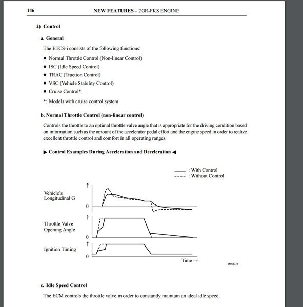

    First off, I'm relieved that Toyota has finally decided to do something about the auto trans shifting issues in the form of a flash update. I sincerely hope it works as advertised and you all can get back to enjoying your trucks (especially you, Smitty! :thumbsup:, no joke).
    Now, lets take this a step further and try to correct what I believe to be the root of all evil WRT the "stoned" throttle response on the 2GR-FKS - ETCS-I or "Electronic Throttle Control - Intelligent".
    Specifically, from the engine PDF pg 146 "Normal Throttle Control (Non-linear control)":
    My beef is with the delay in both throttle valve angle and ignition timing response (on accel AND decel) in order to realize (in part) excellent "comfort" in all operating ranges. That's all well and good but I'd like to counter this enhancement with the following observations (manual transmission):
    1. It's difficult to consistently and properly modulate engine speed when starting out on moderate to steep inclines. Tipping your foot into the skinny pedal when the clutch is at it's "catch" point is a soup sandwich at best;
    2. Initial "bog" in first gear can be dangerous in certain heavy traffic situations - I'd like my truck to go EXACTLY when I tell it to;
    3. Quick rev matching on downshift can be a shitshow- I've found that the 3-2 can be done nicely - if you absolutely STOMP the gas;
    4. Upshifts at speed while on the throttle result in.. you guessed it, a momentary "bog" feeling in the engine once you get back into the gas - sometimes. There are complaints about this in other threads; and
    5. Super long rev hang at high RPM while driving a "little more aggressively". Not a big deal I know, but super annoying nonetheless.
    Ok, sum the hell up.. I get it. I'D LIKE TO SEE A RE-CALIBRATION OF THE ETCS-I IN THE FORM OF A FLASH UPDATE TO MITIGATE THESE ISSUES. I WILL DEPEND ON MY FOOTWORK FOR SMOOTH OPERATION OF MY TACO, TOYOTA.
