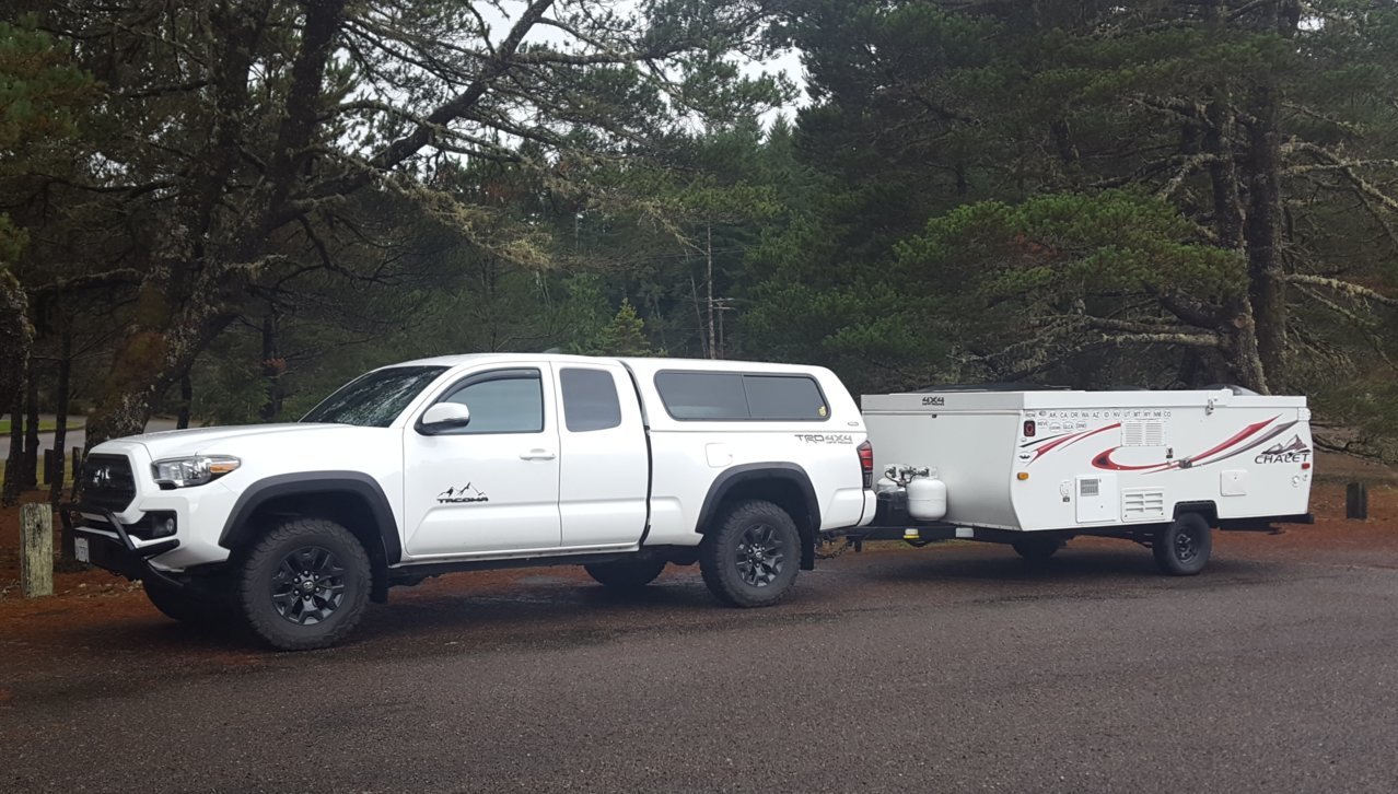

    20181122_192712.jpg To each use trail and error. I've towed my 2400lb Chalet about 10K miles now, and all up and down the Sierra Mts and Rockies from AZ to MT. My standard procedure for towing: ECT on and S4/5 as needed. Steeper longer grades S3 at 50mph is not uncommon. I will use D occasionally on unchanging level terrain. BTW, for highway travel I generally keep my speeds 55-60mph, tho interstates I''l do 65+. And if I keep my speeds below 60, I'll commonly see 16-17mpg.
