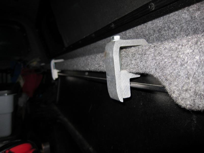

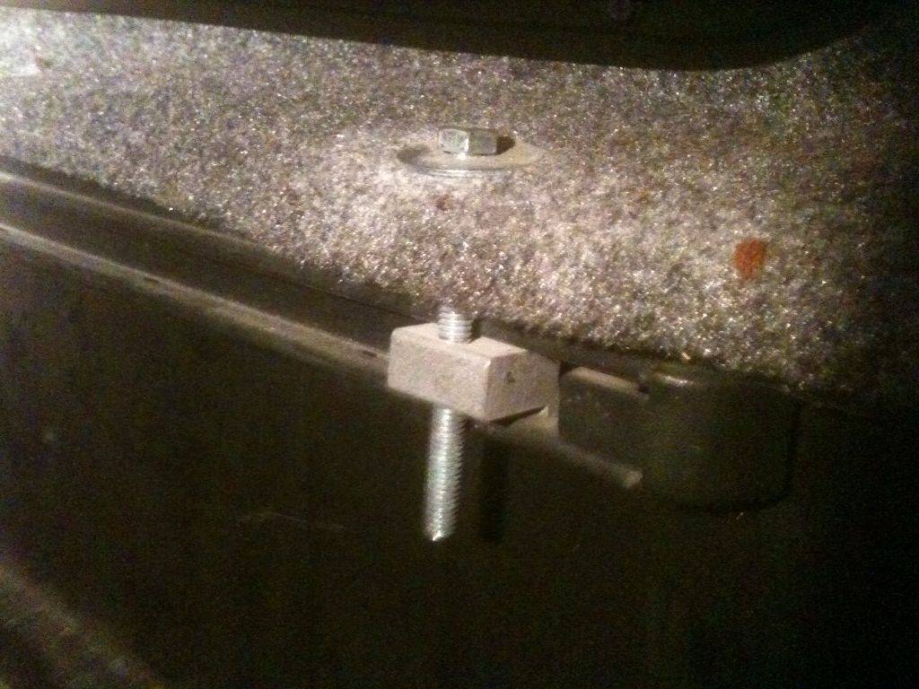

    My Leer mounts with bolts that go into aluminum stock inside the bed rails

    Like dis

    You're exactly right. Mine mounts the same way that Oz's does. And you don't need to remove the plastic rail caps.

    Yes to all; it has the track (see picture) and part of the clamps goes in the track. Yes, the bed is intact.

    I use these same ones but they are bigger and "beefier" I guess.
    Got them as a freebie..very nice. I like that I didnt have to drill holes into my bed. Easy removal. Especially since after this trip I am taking on friday I want to take the ole shell off for a while. Its getting STINKY in there for no reason.
