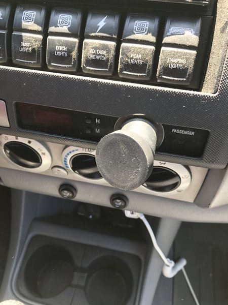

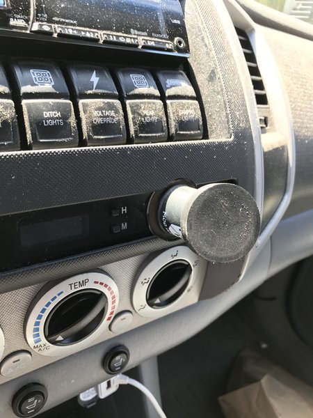

    Here it is. The sticker is a zero issue!

    Oh ya and it's magnetic for the phone, stick a metal sticker they give you on the phone. They also have a physical mount. I like the magnet, works great and stays out for the most part off-road, never had my phone fall, just move a little.

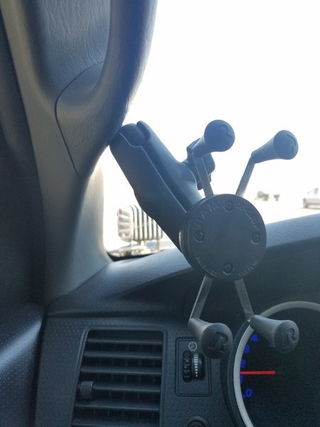

    i replaced the lower bolt in the driver side oh sh!t handle with a longer bolt that holds a spacer and a ram mount ball. you can connect pretty much anything you want to that.

    I put a ram mount ball on the lower driverside grab bar. Works perfect. All you need is a longer bolt.

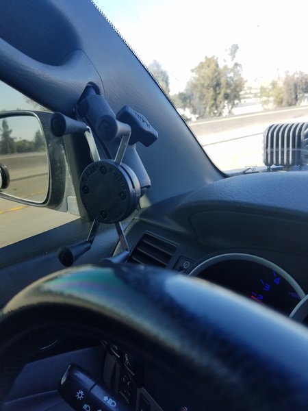

    Ram mount plus x grip using factory bolt location on driver A Pilar. Doesnt interfere with side curtain airbags either

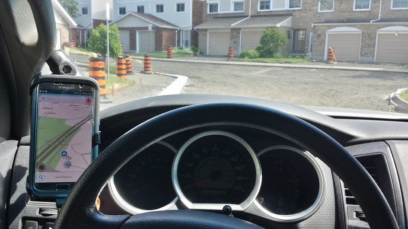

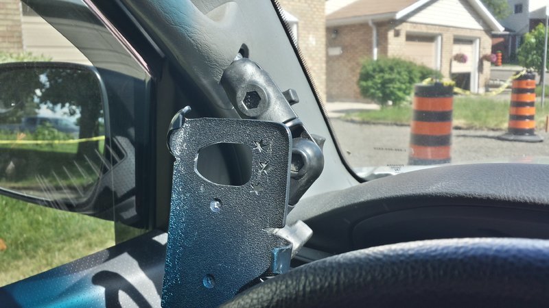

    Went this route, thank you for the inspiration on this thread in mentioning it. Works great. Even had an appropriate length cap-screw and spacer sleeve kicking around, thanks to too many years of spare motorcycle parts hoarding.

    looks good. i can't take credit for this mod idea, I learned it on here from someone else but forget who... it sure is nice and secure/easy... now to run power and a line out under the dash and up the pillar...

    I have a USB power port already installed on that side of the dash (blank switch-plates are good!) - so a quick and dirty 6" external cable run was all that was necessary.
