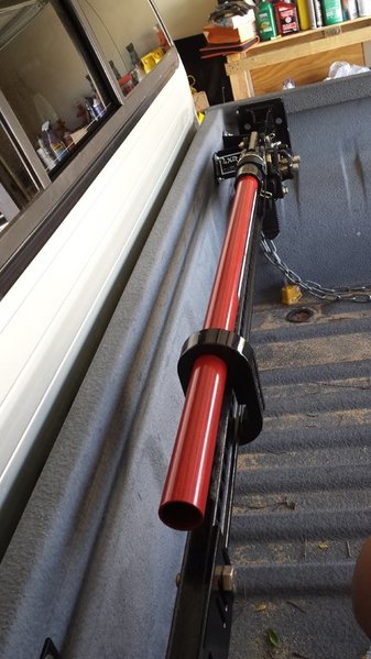

    I figure I should throw my review in here..
    I had the lock mount from hi lift and mounted it on the bed rail on the passenger side. I probably should have painted it a little better after drilling the holes for it but it kind of cracked the bed rail. I guess 1st gen bed rails are not very strong/thick metal. Took it off and just have the hi lift in the back of the cab until I can grab a bed rack from BAMF.
    All in all I would probably not get that mount again. Might be ok for a different application but I wouldn't trust it on a 1st gen bed rail.

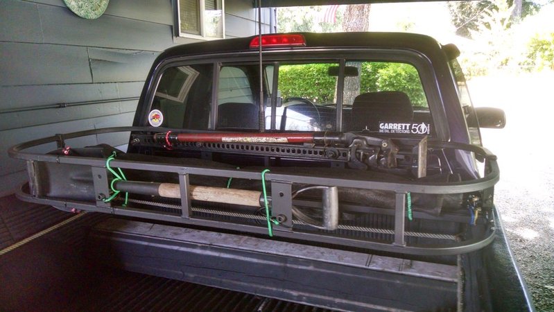

    A friend gave me an old Land Cruiser roof rack that I tore apart and made a mini bed rack for my Tacoma a couple of weeks ago. It holds the Hi-Lift, shovel, CB antenna mount, plus camping gear when needed and also leaves the bed free for cargo underneath. I plan on adding a light bar eventually for backing up in the woods at night and maybe blind a few tailgating douchebags that don't know when to back off! IMG_20150626_143513307_HDR.jpg ;)

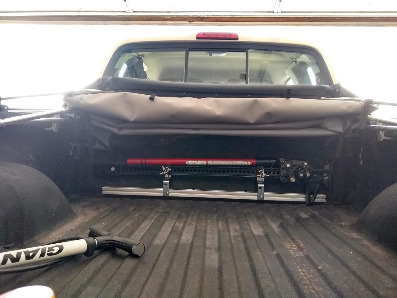

    This is what I ended up doing. Ignore the two slots that are currently unpopulated. Not sure what I'm going to mount there yet.

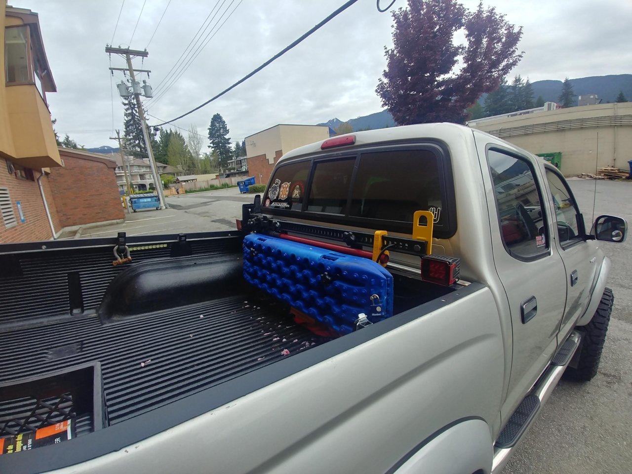

    Here's mine. Bolted on where the tie downs used to be.

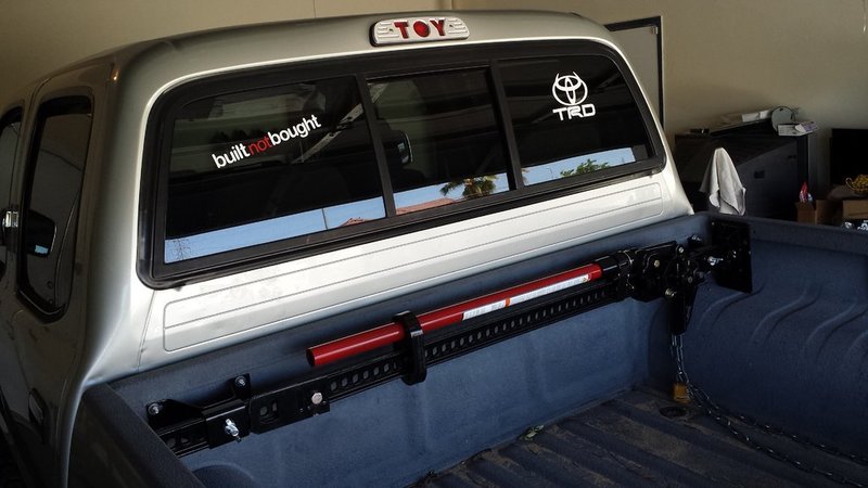

    @razhick4x4, here's mine. Just made some custom brackets and attached to the side with riv-nuts. It's actually quite strong.
    I wouldn't go and try to adapt a 2nd gen rail to a 1st gen. The beds are different, and honestly, I don't really think the rail systems are the bees knees anyway.
    Some bent metal, some shitty welds, and some bolts. Done.

    I think you can clearly see I don't really care what my bed looks like, lol, a few holes don't bother me...
    I'm more of a function over form type person. At least so far, it's really worked great. Even if you add in the cost for the riv-nut tool, the stainless riv-nuts, and the stainless hardware for the brackets, I still spent less on these than commercial ones.
    I don't think just bolting to the bed rail will be strong enough, though. It's pretty thin material. Part of the strength with mine comes from the triangulation of the bracket.

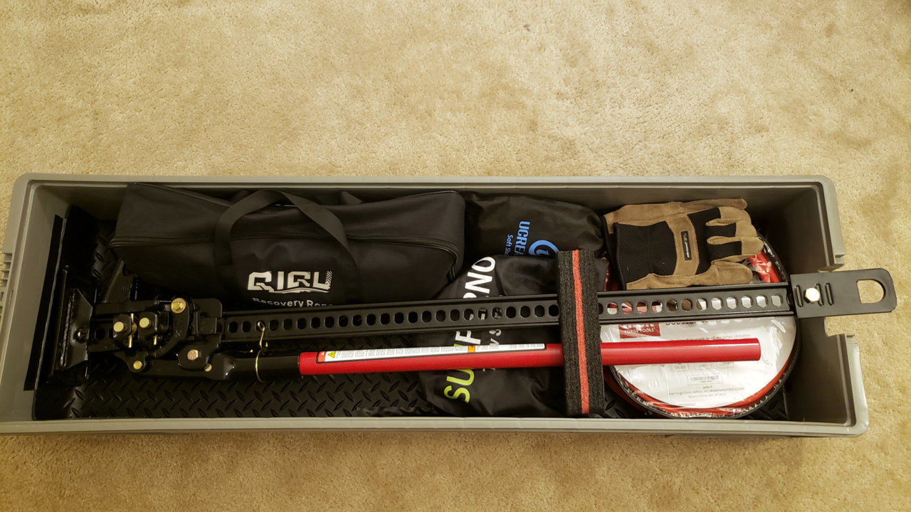

    * AllPro LOLA 2.0 with expedition rear leaf springs * Stealth Custom Series F5. 17x8.5 Gunmetal * BFGoodrich TA KO2 285/70/17 * SnugTop XtraVision
    To be stored under the sleeping platform in the camper shell.
