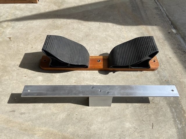

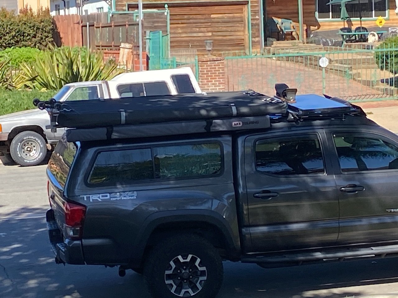

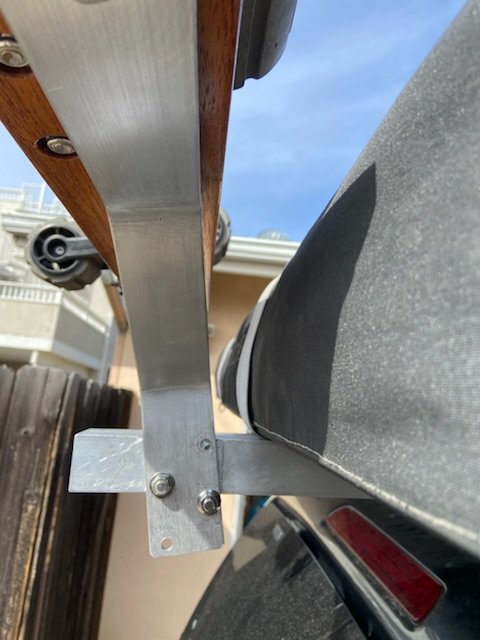

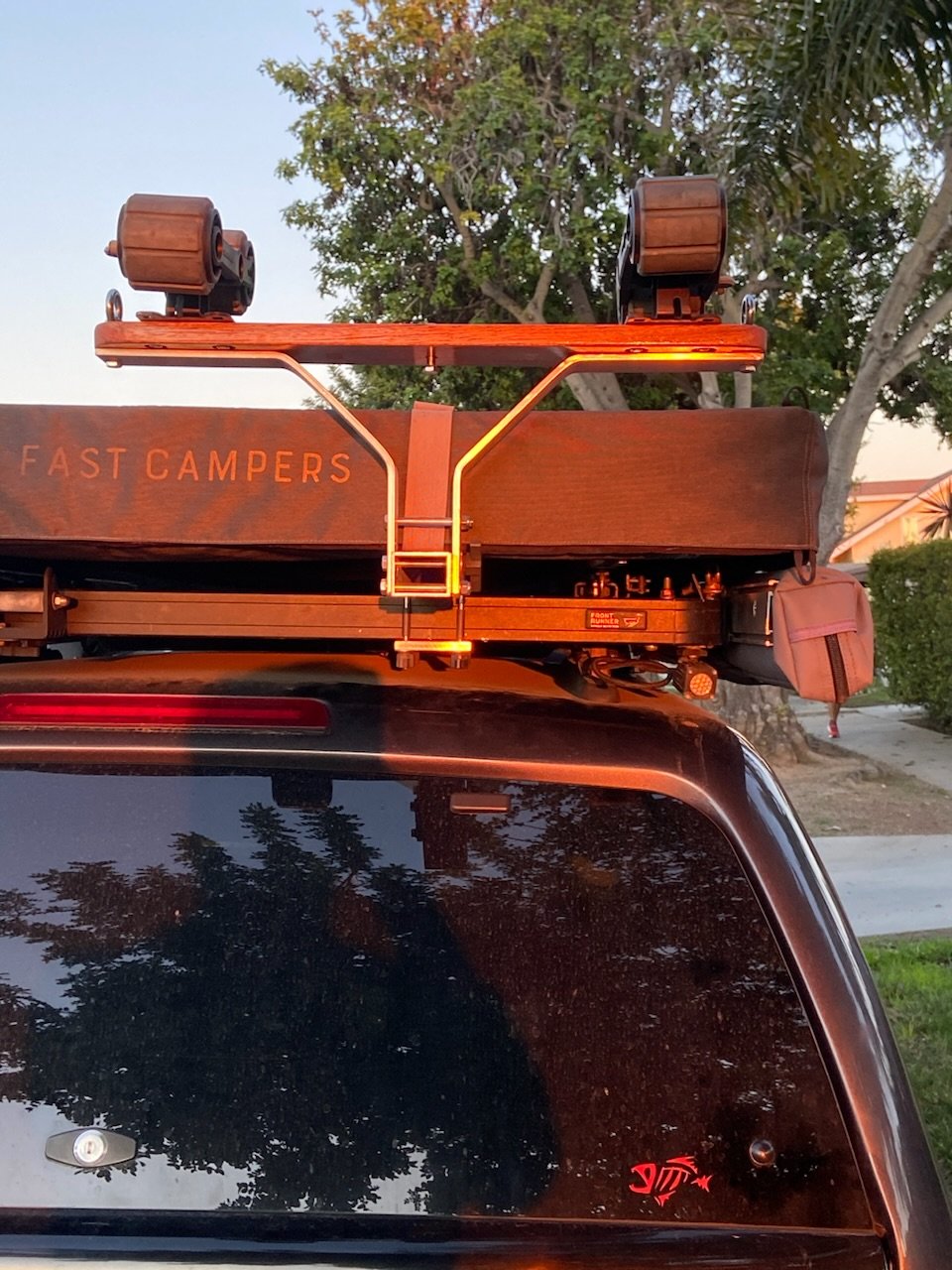

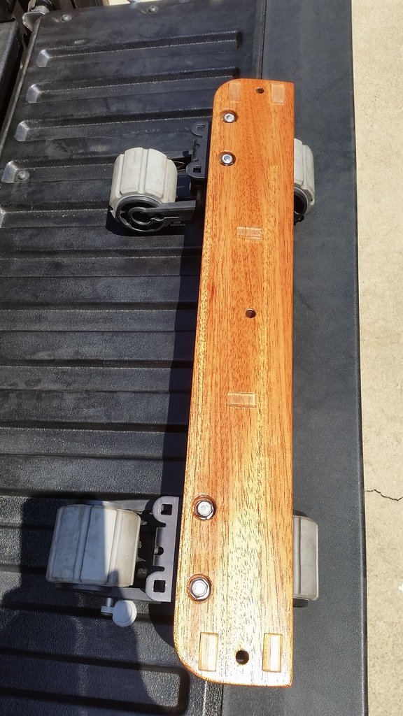

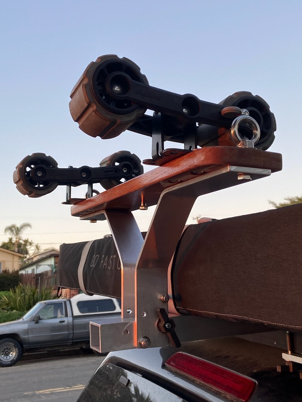

    I originally posted my mounting solution in post #138 (p. 7). Since then, I mounted a GFC SuperLite RTT on my Front Runner rack. At 80 lbs and 90" long, this barebone tent is the lightest hardtop RTT on the market. The downside with this design is that a flexible solar panel is about the only item you can mount on it. In fact, GFC was designing a surfboard rack for it, but ended up scrapping the project. As a result, I haven't been able to take my kayak out while the tent has been on my truck.
    I finally came up with a design that incorporates my existing kayak mounts and allows me to place them fore and aft of the RTT. Since my kayak is 16' long, there is 4' of overhang in front and in back of the mounts. A shorter kayak would probably not work well with this setup.
    The braces are made of 2" x .25" aluminum bar stock.

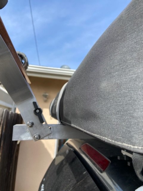

    The tent can expand, depending upon if my inflatable sleeping pad is inside of the RTT. To allow for this thickness variation, I had to make the mount adjustable.

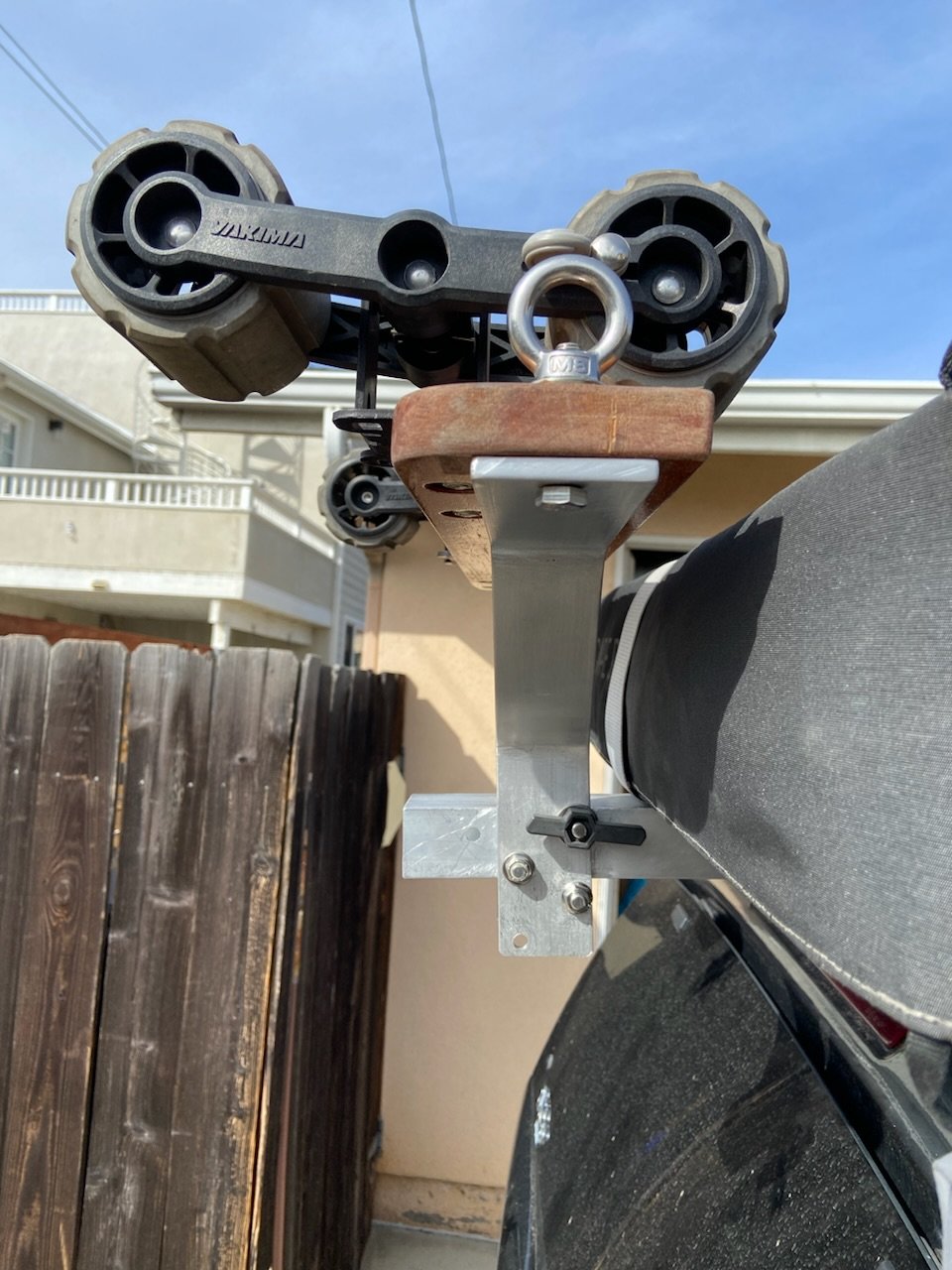

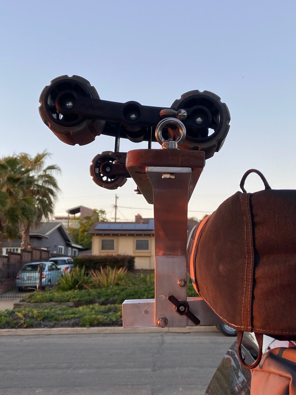

    The next 2 images were tests to see the best bolt placement, in case I needed more space between the mount and the RTT when opening or closing the tent. By removing the bolt with the thumb nut, the braces can pivot away from the tent.

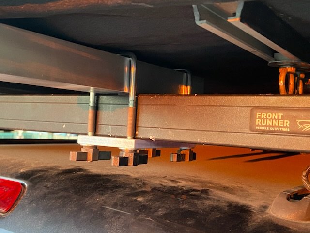

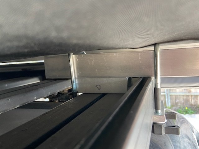

    The 1.5" x 2" main tube is secured to the Front Runner rack with 2" square U-bolts and a 5/16" aluminum plate on the bottom. A 1" x 2" rectangular tube is between the main tube and the cross-member to provide clearance of the rack's rail.

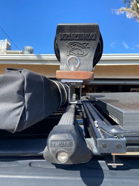

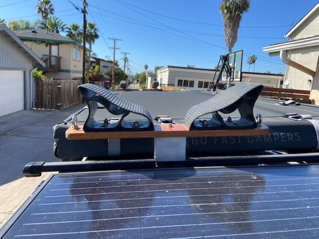

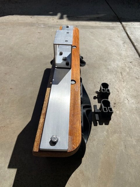

    For the front mount, I secured a Thule crossbar with a low-profile clamp onto the OEM cab rack. Yakima Mighty Mounts attaches the 3" x 2" rectangular aluminum tube to the crossbar. Two 1/4"-20 screws w/nylock nuts connects the 1/4" aluminum bar stock to the tube. Finally, two 5/16" screws with eyenuts attaches the aluminum ends to the wooden kayak mount. The center bolt connects all 3 pieces together for a very secure attachment.

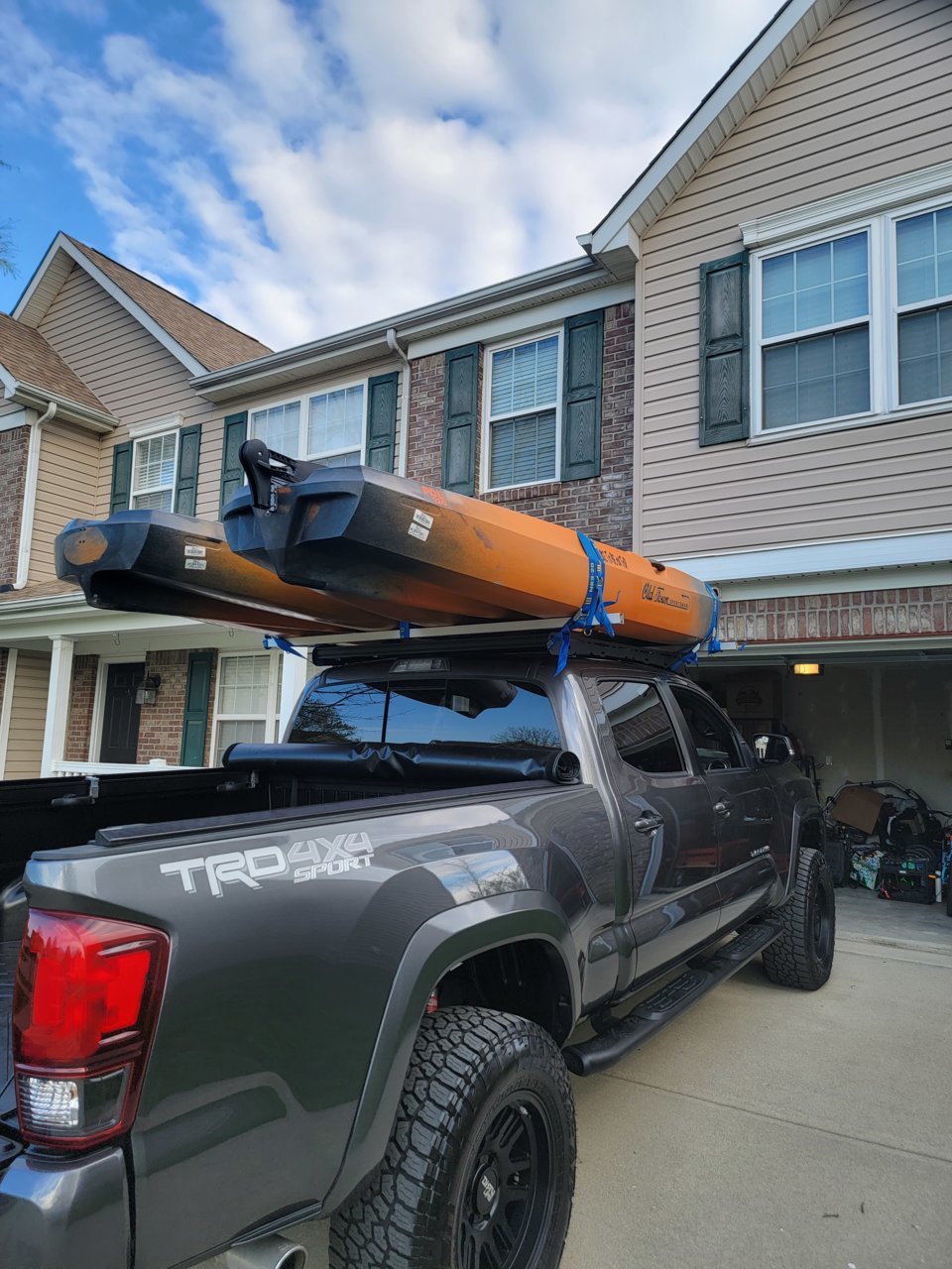

    Martin OR rack, Sherpa RTT brackets, and 70" 15 series extrusions. About 180lbs worth of kayaks (when stripped). Thankfully the truck isn't lifted more than 2/1.5. Shoulder press both up top and slide them on, then 2 1" straps each, then another pair of 1.5" straps over both. Pretty sure I could roll this over the edge of the grand canyon and they wouldn't budge.

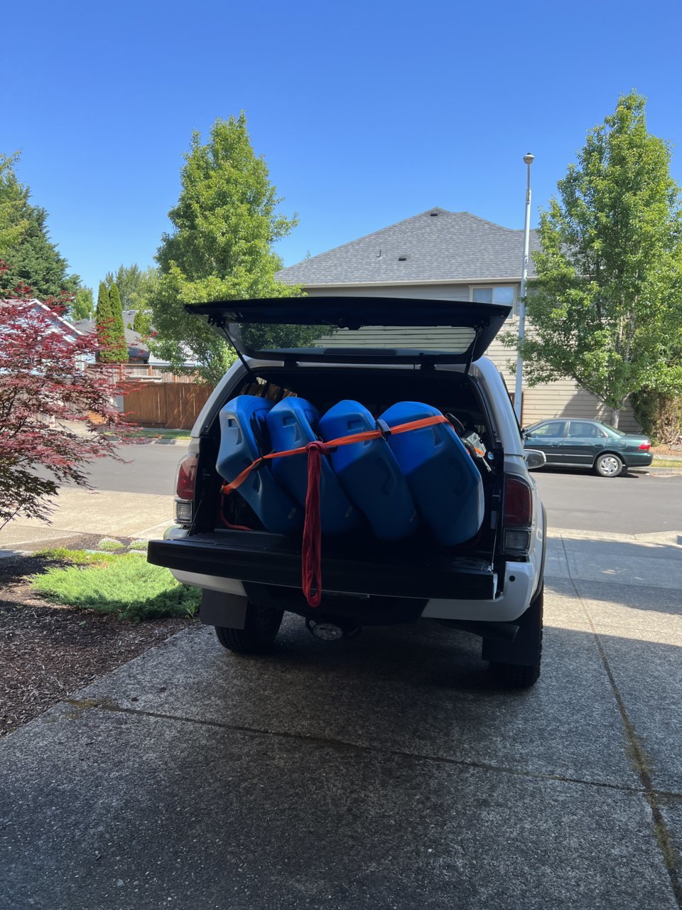

    I just load them in the bed. When we go kayaking, that's all we do...I don't have any room to bring anything else such as camping gear. IMG_4923.jpg
