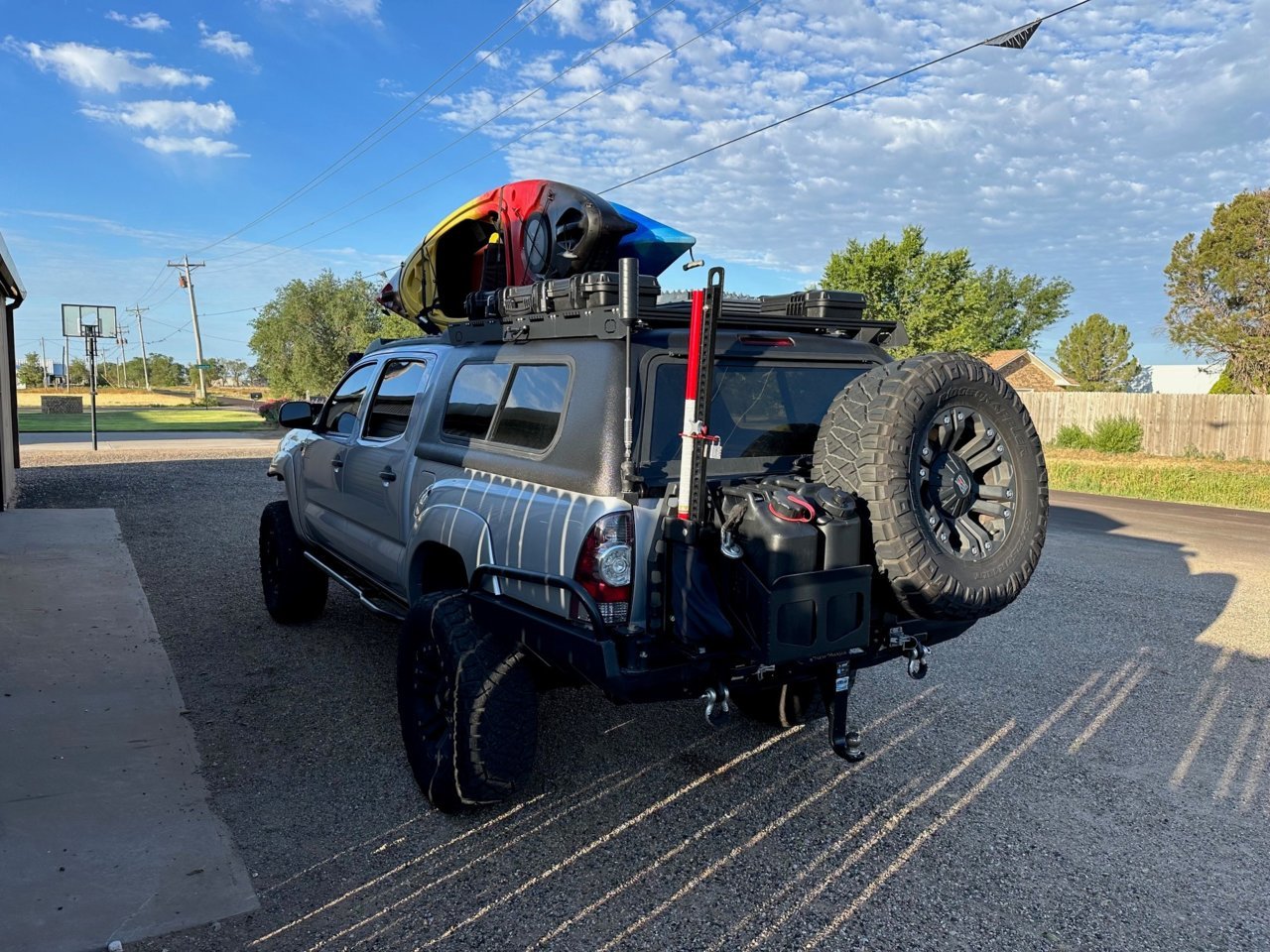

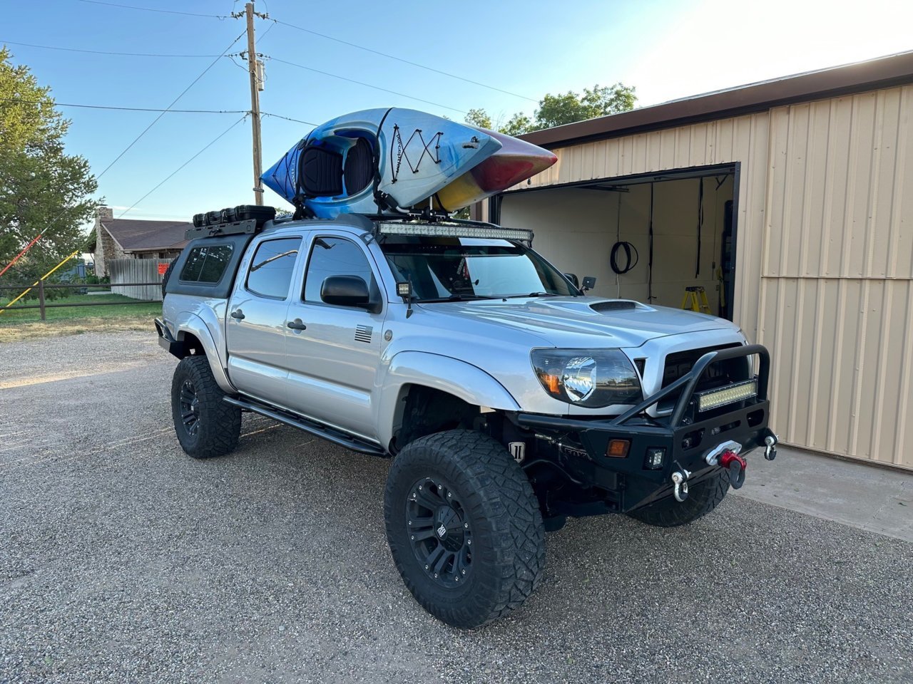

    Very cool set up! With the bed extender; did you have room in the bed for a cooler and a box of gear? How did it do driving on the highway? It looks like a good bit of your kayaks are passed the bit, which makes me a bit nervous. Thanks!

    I ended up doing this for our trip this weekend. Swapped one of the boxes for a cooler and put a box in the cab.

    I carry an RTIC soft cooler back there, I don’t think you could fit a full size hard cooler but maybe if I shifted the kayaks to one side instead of centered. There’s still lots of extra room for gear.
    Never had any issues on the highway with it, would forget they were there if not for seeing em in my rear view.
    There’s probably 2-2.5’ of boat past the extender with my 12 footers but the large majority of the weight is in the bed/before the bed extender. They don’t move or sway when I drive and I have both flagged.

    Nice! Mine are 10’ and 8’. I may look into that if we go any bigger. Thanks!

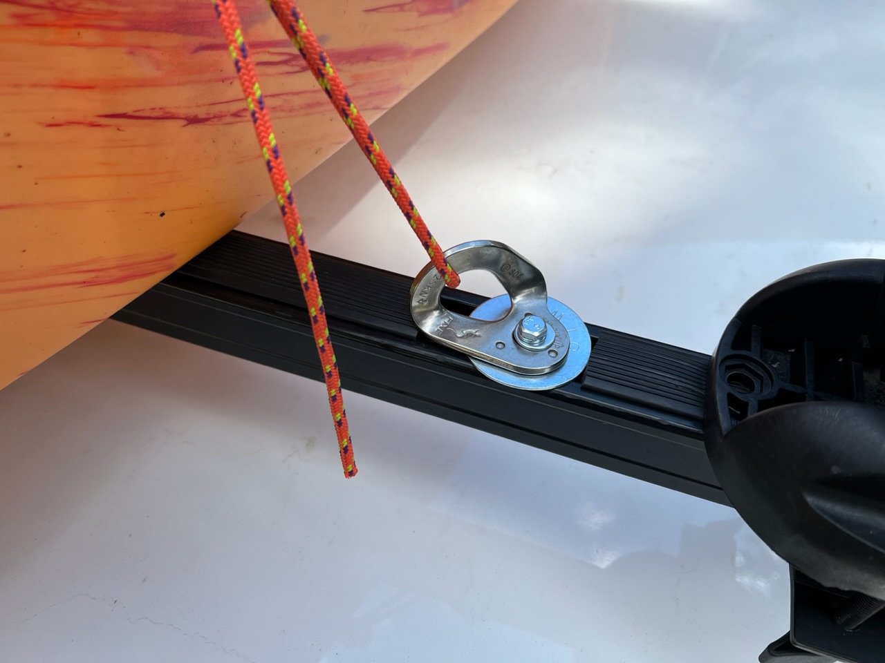

    Climbing anchors are much more affordable than RhinoRack or Yakima tie downs- $4 vs 15-20 each!

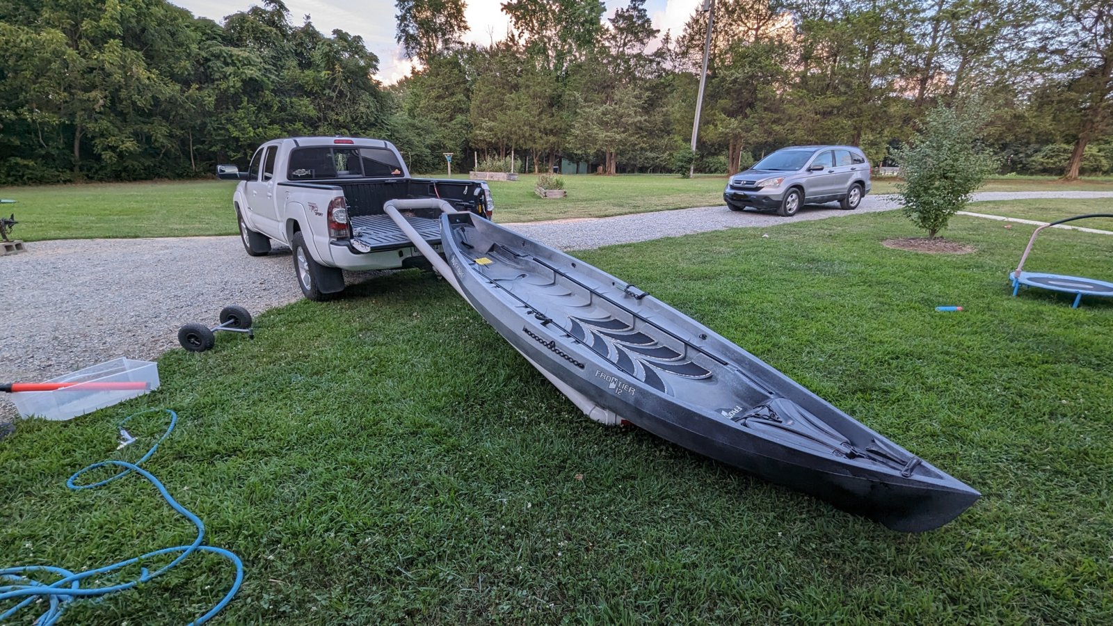

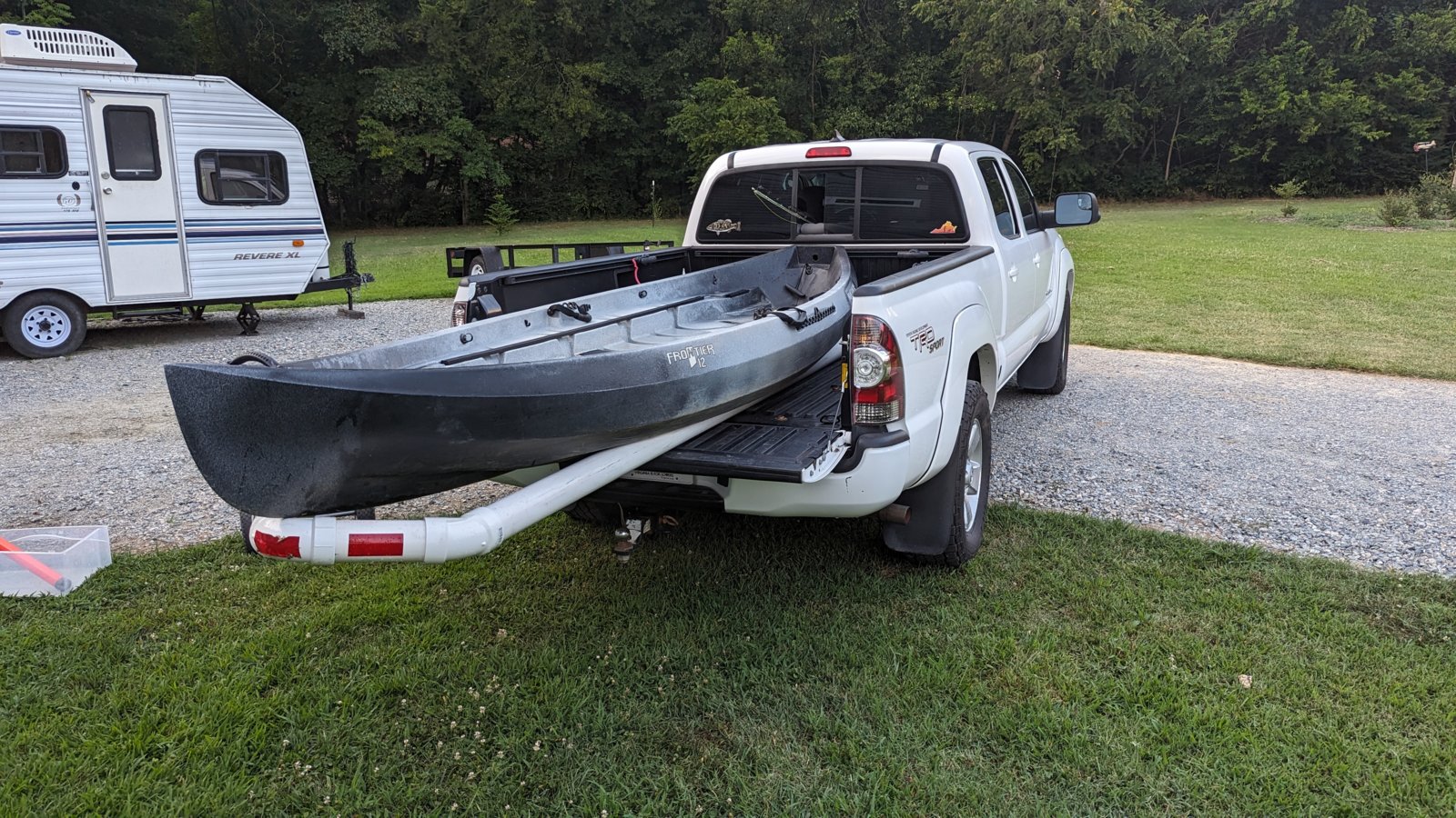

    I haven't seen anyone else do this, but I've been using this PVC 'sled' for a couple years now, and it works great. To me, this seems simpler and cheaper than a bed extender and the whole thing slides off and assists with loading and unloading. I will eventually build a mobile rack that matches the height of the truck bed so I can slide it off for easy storage in the garage.
