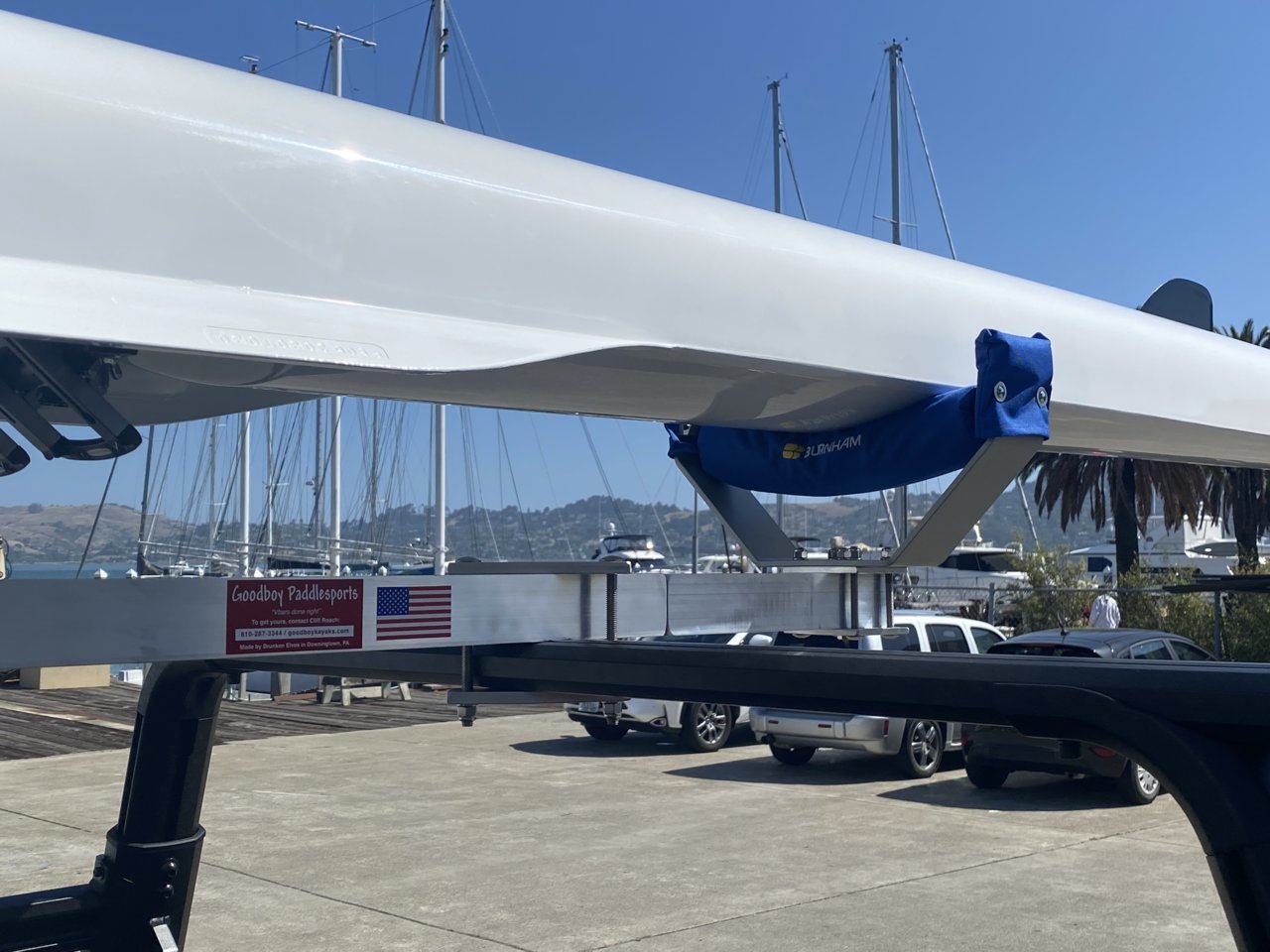

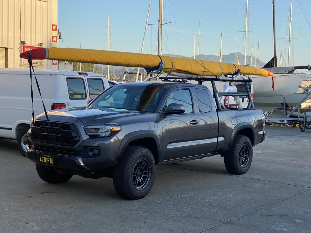

    Check out https://www.goodboypaddlesports.com and then give Cliff a call, (610) 287-3344. He'll be able to come up with the best rooftop or rear rack configuration for whatever type of kayak you have. This is a custom rack that he and I came up with for a 26' rowing scull that cantilevers the front support over the cab.

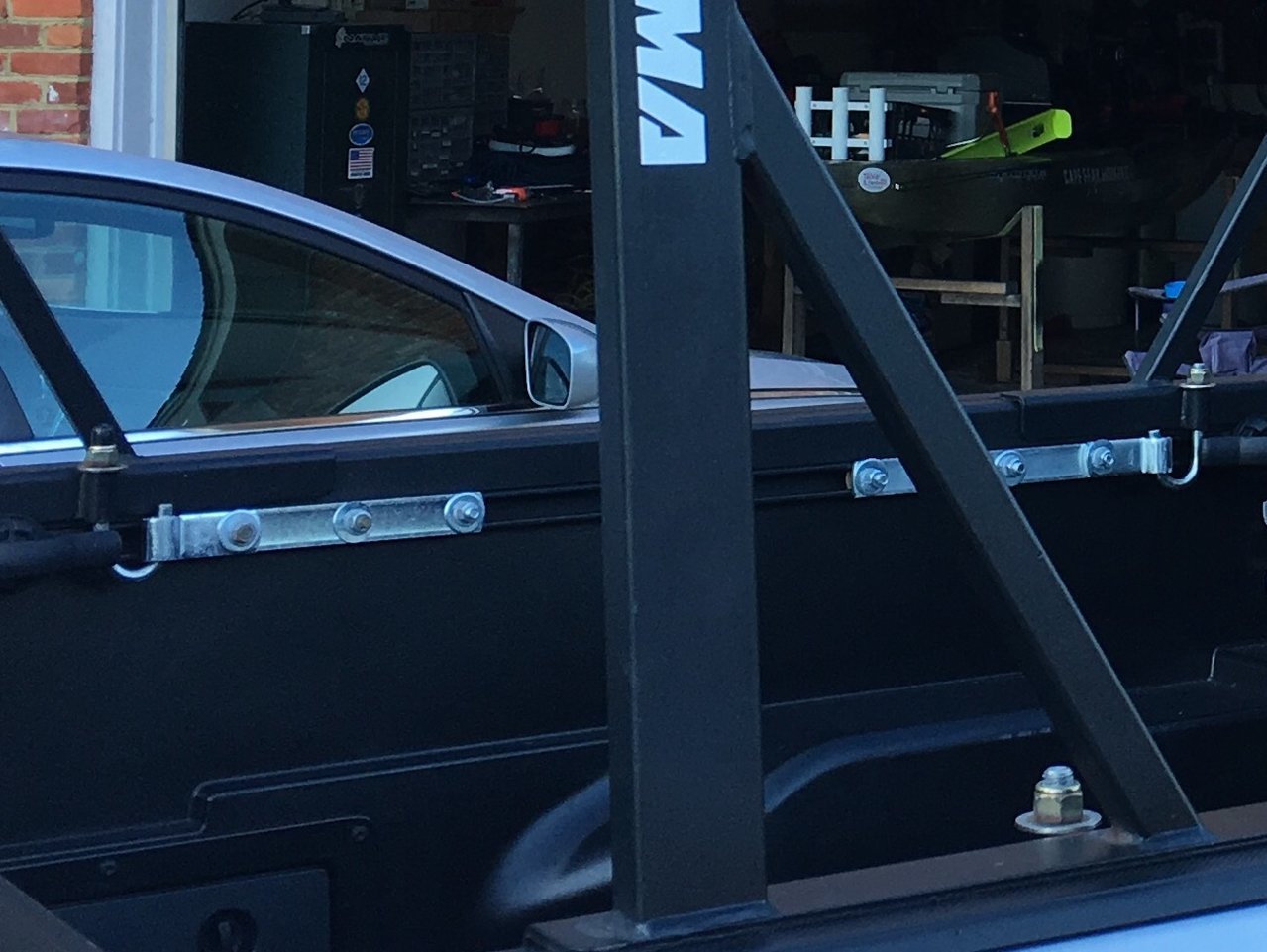

    I was able to use some hardware store items to make the old school Yakima racks mount to the rail system. So far like 4 years later and it is still solid. Rusted on me but still holds kayaks.

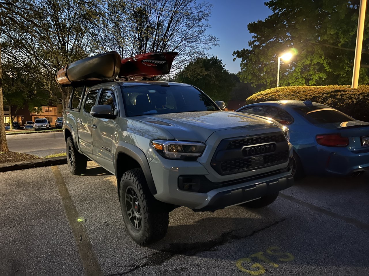

    its not difficult at all. Basically lift the front onto the rear rail. Then grab the back of the kayak and slide it into place. Takes less than 30 seconds and it’s secure as hell. Highway, trails, etc I’ve had no issues.

    At first I didn’t think I’d be able to. I only have the 68” bars. I’ve since proved myself wrong and I’m able to transport both my PA14 and my Old Town Sportsman 120 on there.

    What are the long horizontal pieces the j hook goes into?

    Farm gate hinges and I just made my own slot bolts by welding some washers on the back of a bolt and cutting flat edges on two sides. Slide them into the tracks bolt them where I need and the j-hooks work. I know they make correct items from like Yakima or whatnot but this was super cheap to do and it works. I need to replace the bolts though as they are rusty.

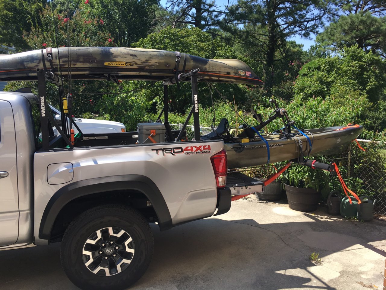

    How I carry both when I need to. I don't put the larger one up top very much as I can't lift it anymore. To old and broken.
