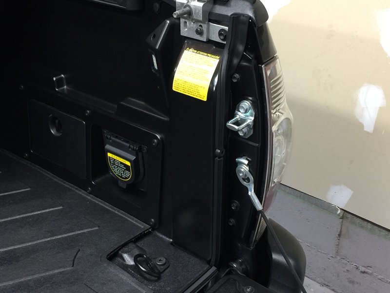

    Hit n Run
    Hit n Run Well-Known Member
    Nov 27, 2015
    #170795
    113
    Steve
    14 Black DCLB Sport
    CusterFan, George1441 and jwctaco like this.

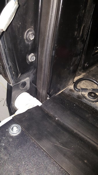

    I used these 2 things, hasn't been long enough to know if they work well/stay applied
    20160929_212244.jpg 20160929_212035.jpg i
    jwctaco likes this.

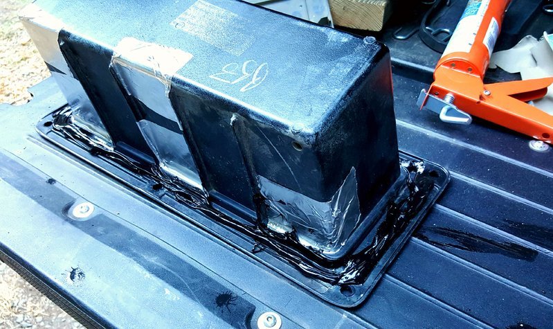

    Not tailgate but on topic of cubbies metal tape and black silicon, leaving the doors off. Not ideal without the doors but dust comes in big time through the hinges and latches 20160927_222940.jpg
    monkeyface likes this.

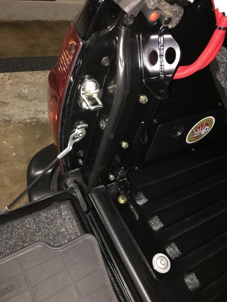

    I got my seals on, time will tell if they help :cheers:.
    LukeLifts, Sig45 and jwctaco like this.

    Seeing these pics has me thinking.....I may redo the tailgate sides and run it long on the top to see if it covers that little gap.
    I think the cap causes the air to behave differently...sort of creates a draft back there that hugs the dust along the back.

  16. Oct 1, 2016 at 7:29 PM
    #16
    CusterFan
    CusterFan Well-Known Member
    Sep 18, 2015
    #164581
    8,936
    Southeastern Illinois
    Silver Sky 2019 Tacoma SR, AC, 4X2, 2.7
    Yeah just twist the seal at about 4 to 5 inches from the top as in that picture and it seals up the gap no problem.
