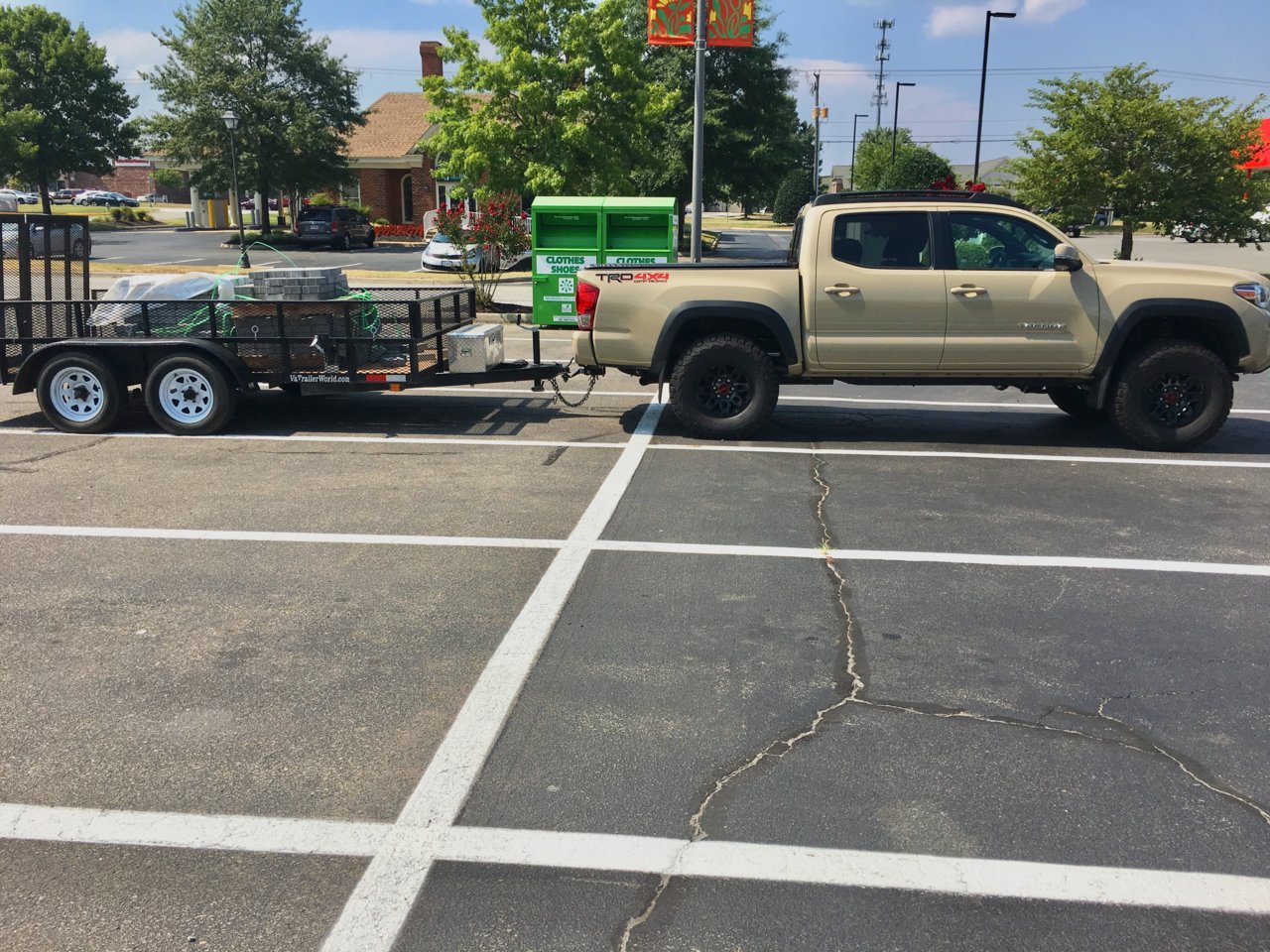

    I just towed over 5k pounds of pavers today, first time with a load like this (and probably the last), I used ECT, put it on S4(first time using S4) ...i had to go up a few small hills, it definitely struggles pretty bad, you have to push the gas to the floor and then she wakes up and rpms shoot up but just momentarily to get up to speed, other than that it was smooth doing 40-45mph at 1,600rpm and 11.5mpg on 285’s :D... putting it in S4 seemed to be the trick to help the transmission deal with the load.....I didn’t get on the freeway at higher speeds with this load so I can’t compare
