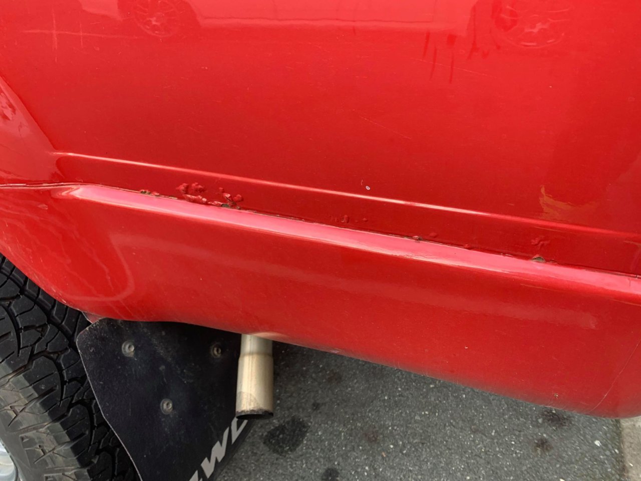

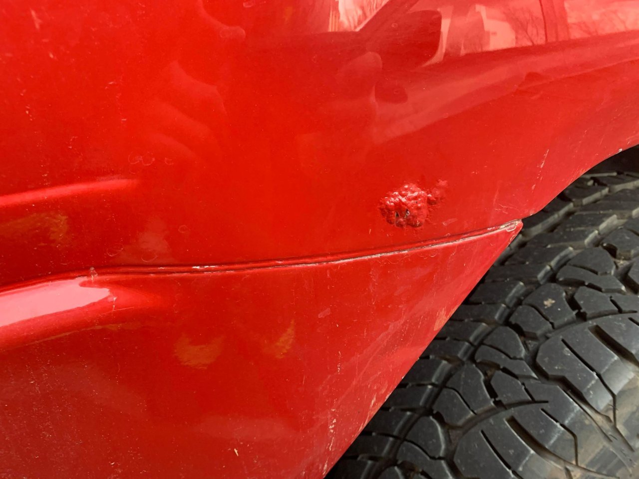

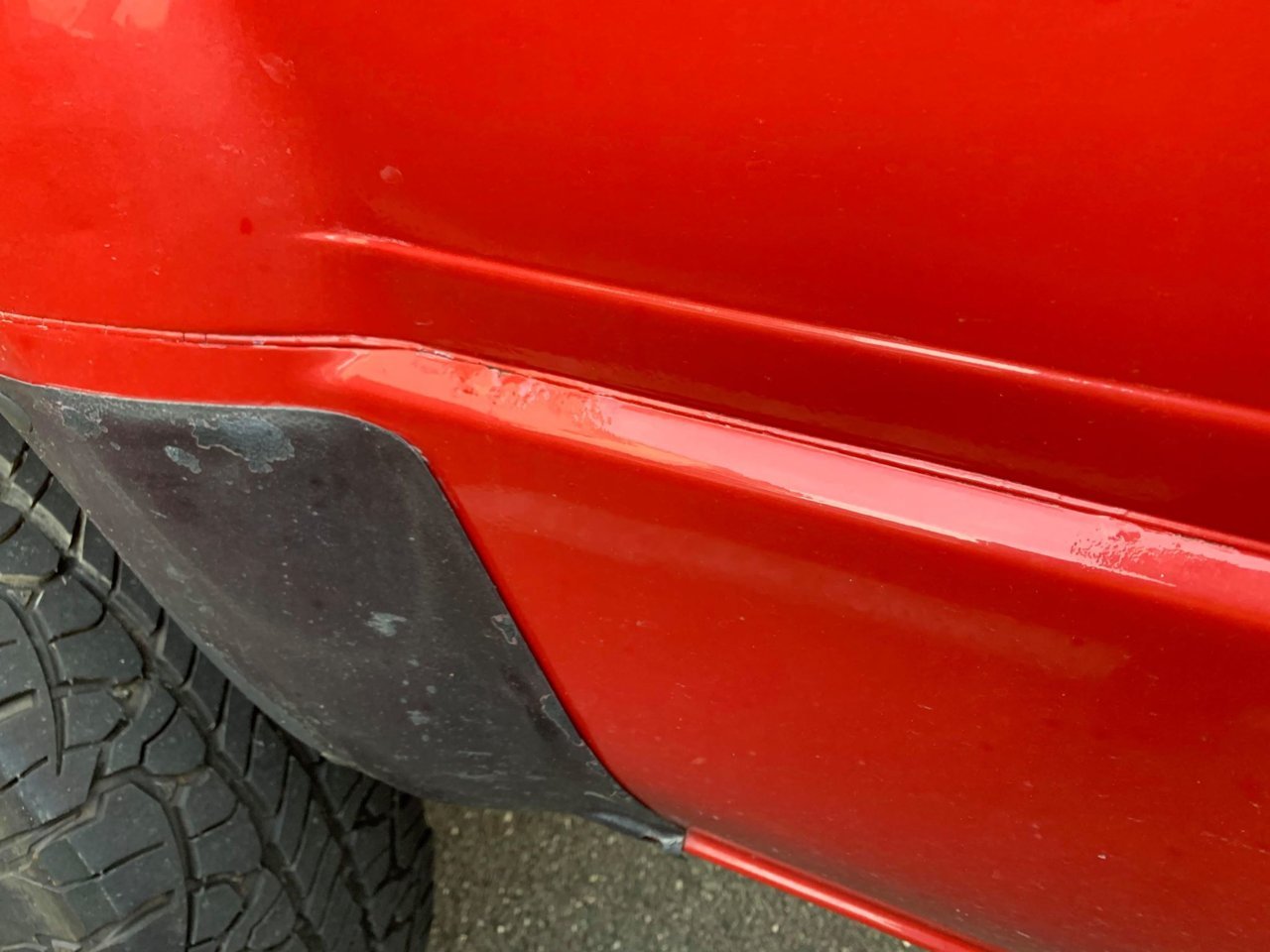

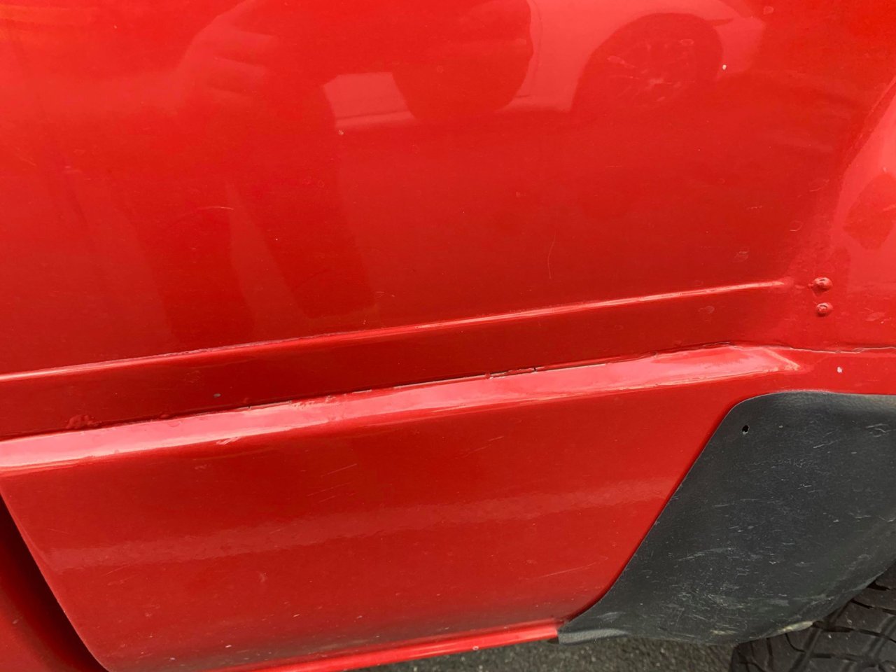

    Hi All,
    Looking at buying an 88 pickup. It was painted in the last couple years, but there are a few spots where rust is bubbling up from under the paint. I know from reading here, that the best way to remedy this would be to sand down to metal, and cut out the entire affected area. However, I don't own a welder currently.
    From your guys' experience, could this be reasonably covered by sanding and repainting the surrounding area, or would this require much more to reasonably cover it up? I know I would have to re-do this often. Im assuming it was a budget paint job. I appreciate any advice.

    The "budget paint job" is probably at least part of the reason the paint is bubbling up due to rust underneath it. Based on what I can see in you pics, there's probably some major issues hiding under there. Up here in the rust belt, that much bubbling means lots of rot and lots of work, which equals lots of money. Remember, rust never sleeps.

    The best way to find out is to look at the back side of the panel - if you can get to it. Remember, that rust is coming from the inside. If you can't get to the back side, the only real option is to grind the paint off and see what shows up.
    As for the frame, on older vehicles, the bodies rotted out long before the frames. (Unlike our Tacomas, cough, cough.)

    How much restoring are you willing to do? I wouldn't touch it unless I was ready and willing to strip that truck down to bare metal and assess from there. Murphys law says that what you see poking through the paint is just the tip of the iceberg.

    Frustrating I know. Ive seen what happens to just patching up the visible areas though. It starts as a bubble, and if it isnt addressed properly a line of bubbles will appear, and soon enough you'll have a hole running the entire length of that rocker panel... :annoyed:

    Fixing that properly is going to require a repaint of the whole effected panels and since that looks like a homemade paint job the color probably won’t be matchable so you are looking at a whole new paint job.
