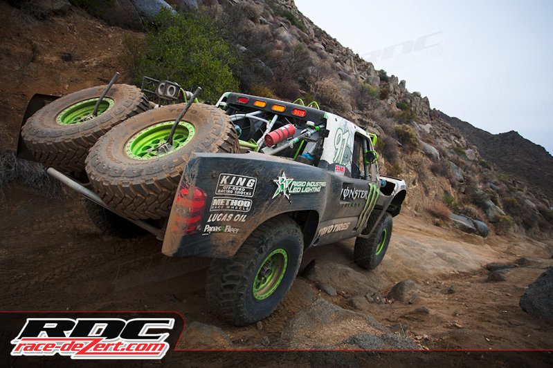

    A lift of any height doesn’t increase reliability since you raise the center of gravity and change the driveline angles.
    Look at all the serious off road race trucks and rock crawlers, none are really “lifted”. They just modify to extend wheel travel within the truck ie larger and deeper fender wells, or take them off completely like a crawler.
