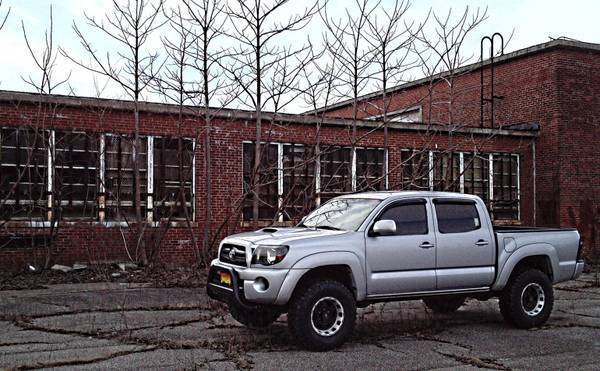

    Ok well it seems like most of you are going to call me stupid but I decided to go with 1/4 inch top plate spacers which should give me about 1/2 an inch in front. For $42 from wheelers, the lowest price I could find Billy's for was $180 and that's just too much money for me. Like I said, I mainly just want it a bit more level. This should still give me a little rake but it won't look as stupid as it looks now. I only go off road a little so I'm not worried about breaking things, and it seems like these top plate spacers won't affect my ride much if at all. Thanks for all the opinions from both sides.

  17. Jun 28, 2012 at 3:20 PM

    for the 1/4" spacer there is no real chance for damage or compromised suspension anything, so you are fine there, it's just not much lift and ill be surprised if you really notice it
