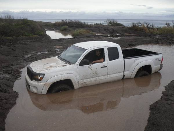

    Got too ambitious. Stuck in da mud. And water. Exhaust pipe is under...how bad can it be?

    put on your oldest rattiest clothes and go under your truck on a creeper with a hose and rinse everything clean.
    Check the mudline on the rear differential. If you completely submerged it, and haven't done a diff-breather mod you should probably change the rear differential oil.
    Then, if you didn't have water intrusion into the cab and the carpets weren't wet - I'd say you're good.

    Don't turn it off when the exhaust tip is under water.

    as long as you didnt shut the truck off while the tail pipe was under water, and your diff didnt get water in it, you should just need to give it a bath

    Other than the rear diff breather under water, it'll be fine. Now if you had to crawl out of the window, id say differently! :D

    Not lookin good... Waitin on the tow team :D [​IMG]

    Where would the rear diff breather be?

    on the rear diff
    and its underwater.....so you will need to change the fluid out.

    On top of the rear differential. It's a little metal nub that threads into the top of the diff.

    Your gonna have to change your rear differential fluid.

    It's on the top of the rear diff. Looks like a large valve stem cap....kinda.

    But ya....like said....thats not bad at all.........spray out the bottom of crud......go do it again with a buddy to pull you out this time. And do the dif breather mod.......I have very little mech skills and I did it in about an hour taking my time.
